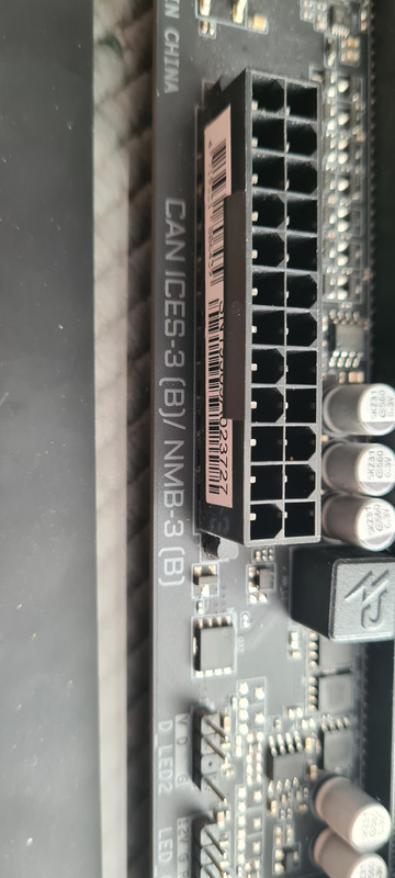

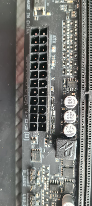

Look over the 24 pin on the motherboard side if possible post a pic so we can have a look, as long as there are no burn marks or melting signs on the motherboard connector you should be fine.
Had a friend back when we were at college that had the same thing happen but his PSU cooked the board as well as the PSU.
I will upload a photo shortly but I did have a close look and couldn't see any damage to the board.

it may be worth taking out your Aorus X570 Elite and checking the backside for any burn or scorch marks, pics of the 24pin look good, no obvious signs of damage, what does the psu connector look like after the problem?

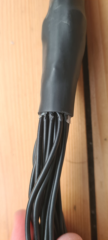

Uploaded images
Im not sure if that cable is partially melted, hard to tell but that particular area smells really bad.

jesus that 24pin got pretty hot to partially melt multiple wires at least 2 i can see, and regard to the mobo lights going out after a few seconds suggests hidden damage within the board, or a capacitor that has gone bad, connecting a second psu the motherboard should have a few led's lit up to indicate standby power, if they go out something is wrong with the board, have you checked over the cpu, ram, gpu and storage devices, do any of those smell as bad as the psu wires?

The 24 pin cable does look like it has melted at least a couple of wires. Any signs of burning on the pins?
That is one drawback with having all those wires lumped together under single heatshrink.
