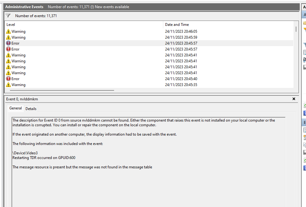

Here's a couple of screenshots to illustrate what shows up on Event Viewer when this happens:
Shows three nlvddmkm events in a row:
I've done a fresh install of Win11 a couple of times, this behavior never changed. I always use DDU and do a fresh install of new drivers, etc. This has always happened since I got this card. For some reason, there's never ever an issue when gaming and can go for hours and hours nor is there an issue when connected to my DP monitor.
