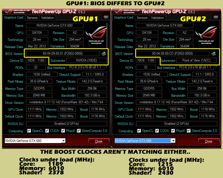

I've bought a couple of great GPUs - POV-TGT 2GB GTX680 Ultra Charged - but have a problem with the temps of the first card under 90%+ load where it will reach 91c. Ain't much space between cards because they are 2.5-slot, I'd call them more like 3-slot - despite that the fans are very quiet..
None of the GPUs are overclocked. The second GPU reaches a maximum of 56c under load and I know this is down to the extra space below the card (mobo is P8P67 Deluxe), the first card has minimal space and I'm stuck thinking of a solution without resorting to buying new mobo. I've tried swapping around the cards, placing a 120mm high-speed fan near the GPUs, and opening the side case because the 800D is average at air-cooling.
