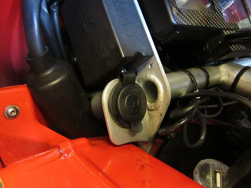

That's the method I used on my RSV, just made an alloy bracket so I could use an existing hole to bolt it to.
