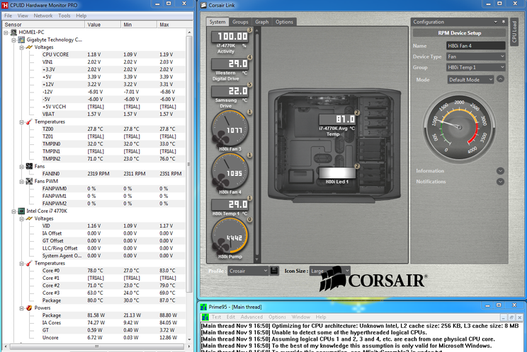

Washers fitted, results of Prime after 30mins, fans on quiet mode. Better for cpu temp but coolant is higher. I could do with buying some thermal paste because of the refit. Make, whats your thoughts on the on these temps now, bearing in mind the cpu is still at stock.
Originally fitted with the standard paste that came preapplied to the h80i block. Since then its been a bit messy with the stock cooler I put on as part of the troubleshooting, then after that I refitted the h80i (with washers). I don't have any paste so thats next on the list.
