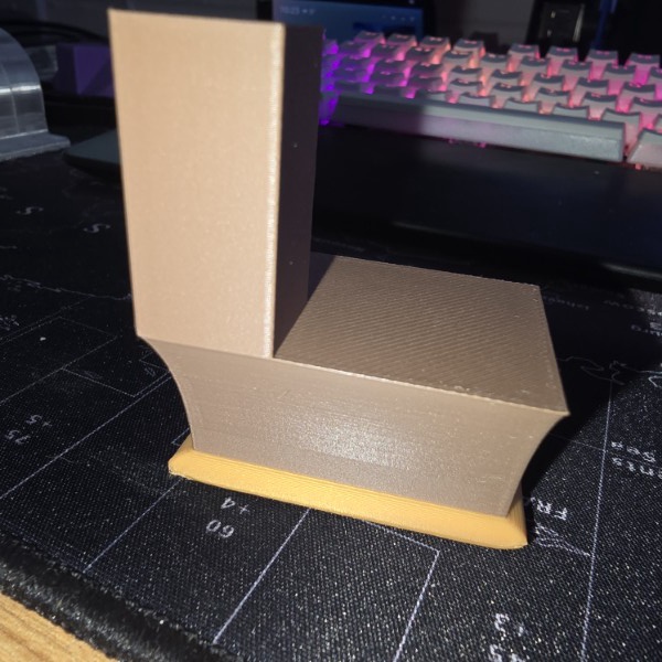

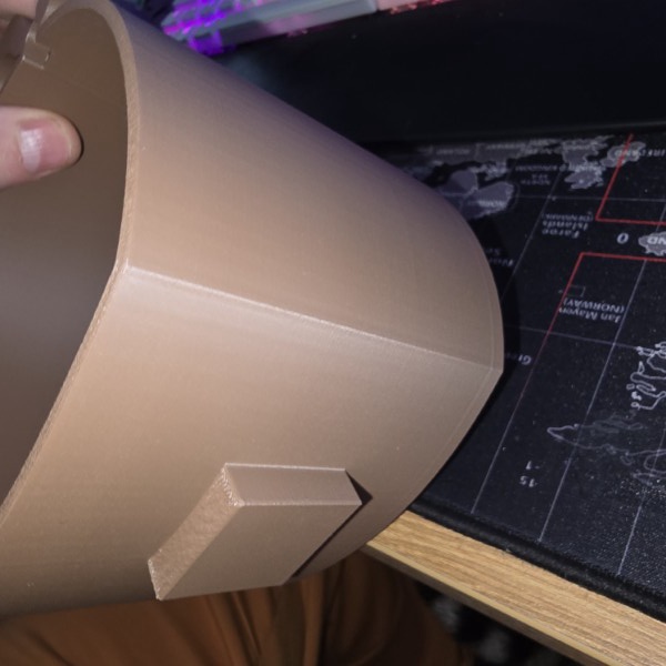

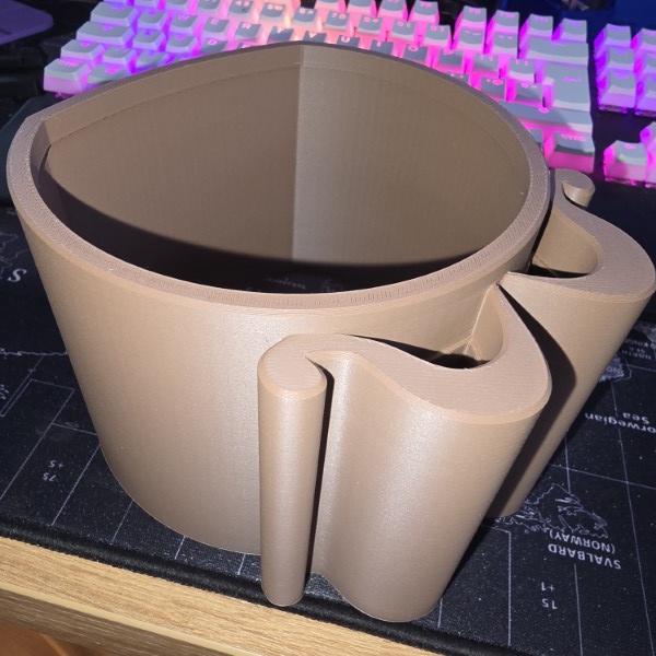

I would also say the problem is the printer settings, check out some parts my wife printed using the A1 mini, a £169 printer.
