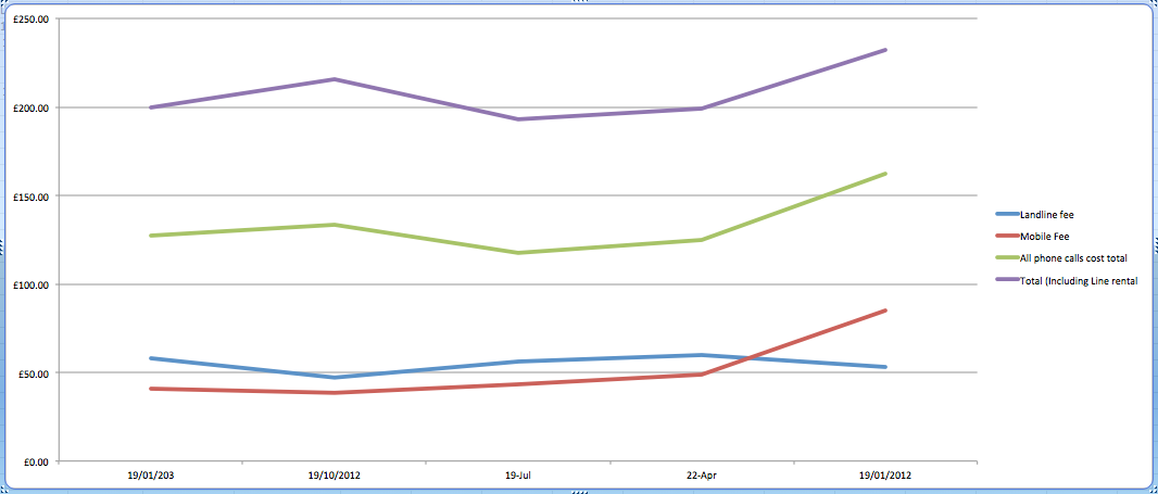

I get billed quarterly for my phone at the moment, each bill is in the region of £200 so roughly £70 per month for the phone (I'm pretty sure I'm getting billed on a per second basis)
I put together this little graph of the my past 5 bills, I broke down the individual bill for the land line and the mobile cost for the 3 month period.
I know the dates aren't in chronological order.
This is how I'm coming to the figure of about £100 a month
Roughly £70 a month for the phone and £30 a month is about £100 a month for both services.
The inclusive calls package I'm looking to get should massively reduce the fee I pay for land line calls each month, The cost for calling to a mobile should be about half of what I'm paying per second at the moment for each call made.
Overall I expect to spend about £50 a month for the Phone service, Broadband Service & Line rental
So over a 3 month period I should be spending roughly £150 instead of roughly £290.
