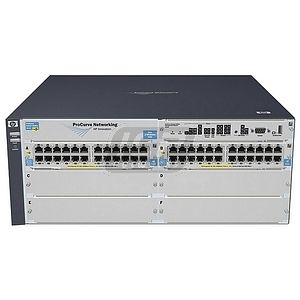

Got called in to work this morning (School holidays, so not in for 6 weeks) as there was no connection around the place, turns out our 96 point core switch in the main cab was powered off, wouldn't power back on, and the psu is just clicking, I'm not sure if the switch has blown or just failed, and if so what to expect in terms of what it could have taken with it!
have already logged it with HP who are coming out to us asap, I'm just trying to gauge if anyone has had anything happen similar and what it took out?
Switch is a HP 5406-48G zl
But with 96 ports in (4 modules)
