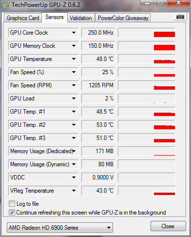

Program to view Ram.
Here is mine.. which do i look for.. there is 2 memory ?
Cheers:)
Thats memory usage of one card, if you click at the bottom were it says
AMD Radeon HD 6900 Series
then choose the other card, it will show the memory usage of the other card also
Oh ok..
But i thought it only uses 2G and note 4 in total, as you think you would get having 2 cards..
Is this on the edge then with bf3 ?
Cheers :)

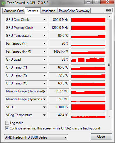

Setting aside pc memory might be different but 99% sure max gpu memory is limited to single card regardless of xfire
Looking at those gpuz screen's its using 300mbs of ram atm,doesn't it store the readings to text? That way you can see how much its used while gaming
So what am i looking at, the Dynamic and not the dedicated?
From what i read it's the Memory Usage (Dedicated) i just tried rfactor. and that only went to 1100. but bf3 near 2000. maybe thats why the game runs **** lol..
I read people say they run out of memory at higher res, mine seems to in bf3 @ 1920x1200 as i have everything maxed out.
Basically any data stored in one card will also be copied to the other cards in crossfire/SLi. So no need to look at the others...
It's crossfire but it's technically not true crossfire. Sort of like hybrid crossfire which AMD calls "Dual graphics". Not sure how the memory will work then... but probably best to set it to 2gb to match your 6670. There are some programs which adds all the memory together such as MSI afterburner, so you need to half this to get the true usage.
And don't just use BF3, it's one of the very few games that actually eats VRAM :p. Most other games won't reach the limit.

Right i did that.
Memory Usage (Dedicated) [MB] highest 2440
Memory Usage (Dynamic) [MB] 263
Surley BF3 isn't only using 263mb? out of 2GB
I'm confussed now, as i hear others say theres using 1.5gb etc IN BF3.
The game must not like crossfire!
Can someone explain this plz :)
Cheers :)
BF3 is using 1220MB per card.
I believe the "Dynamic" value is the swapfile in your system RAM used to hold data not required in VRAM, while you're gaming. Stuff like Thumbnail Previews, Window Transparency data, etc. At least, that's the only way I can see Microsoft claiming Aero has no performance impact on the GPU.
