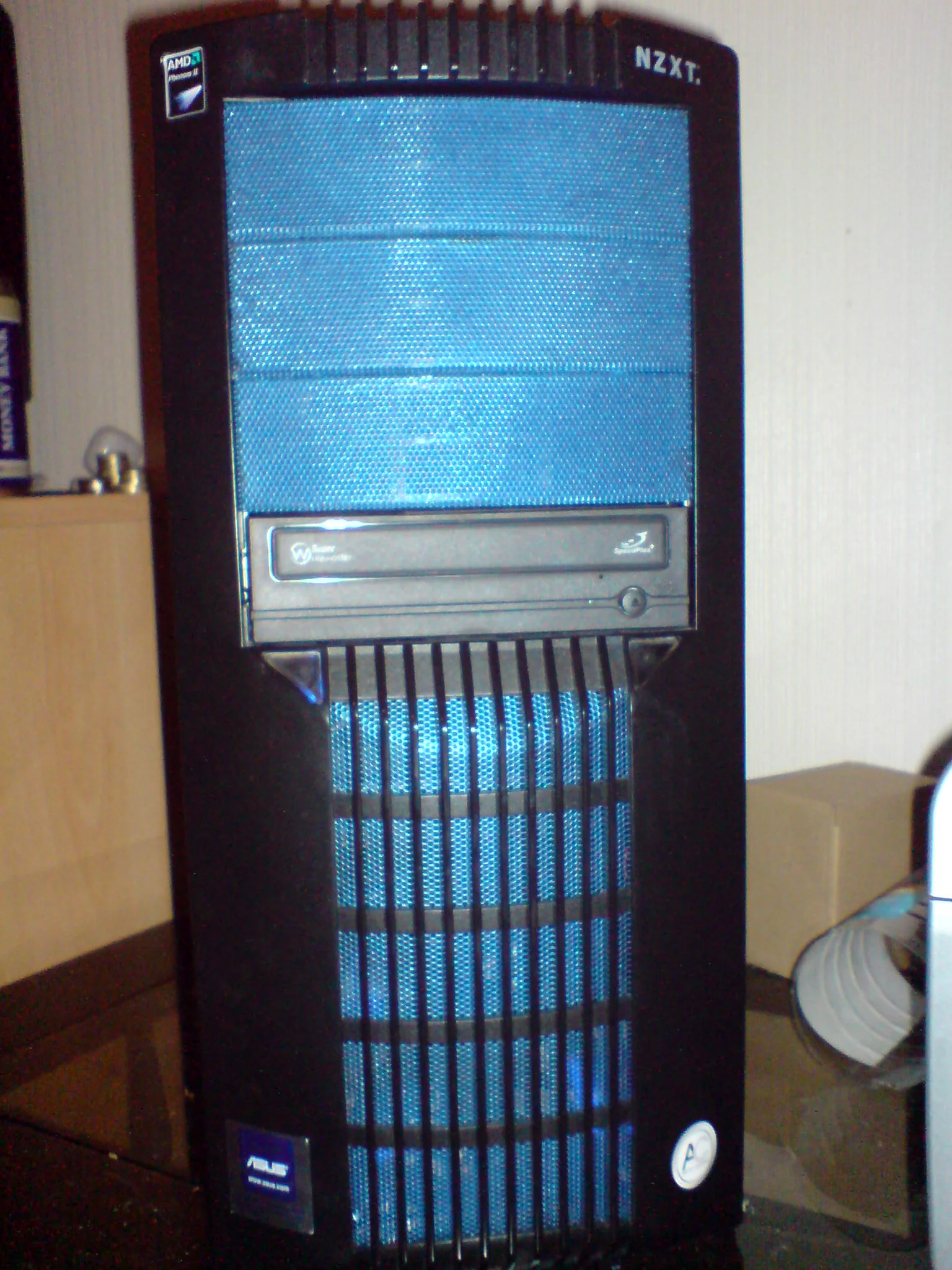

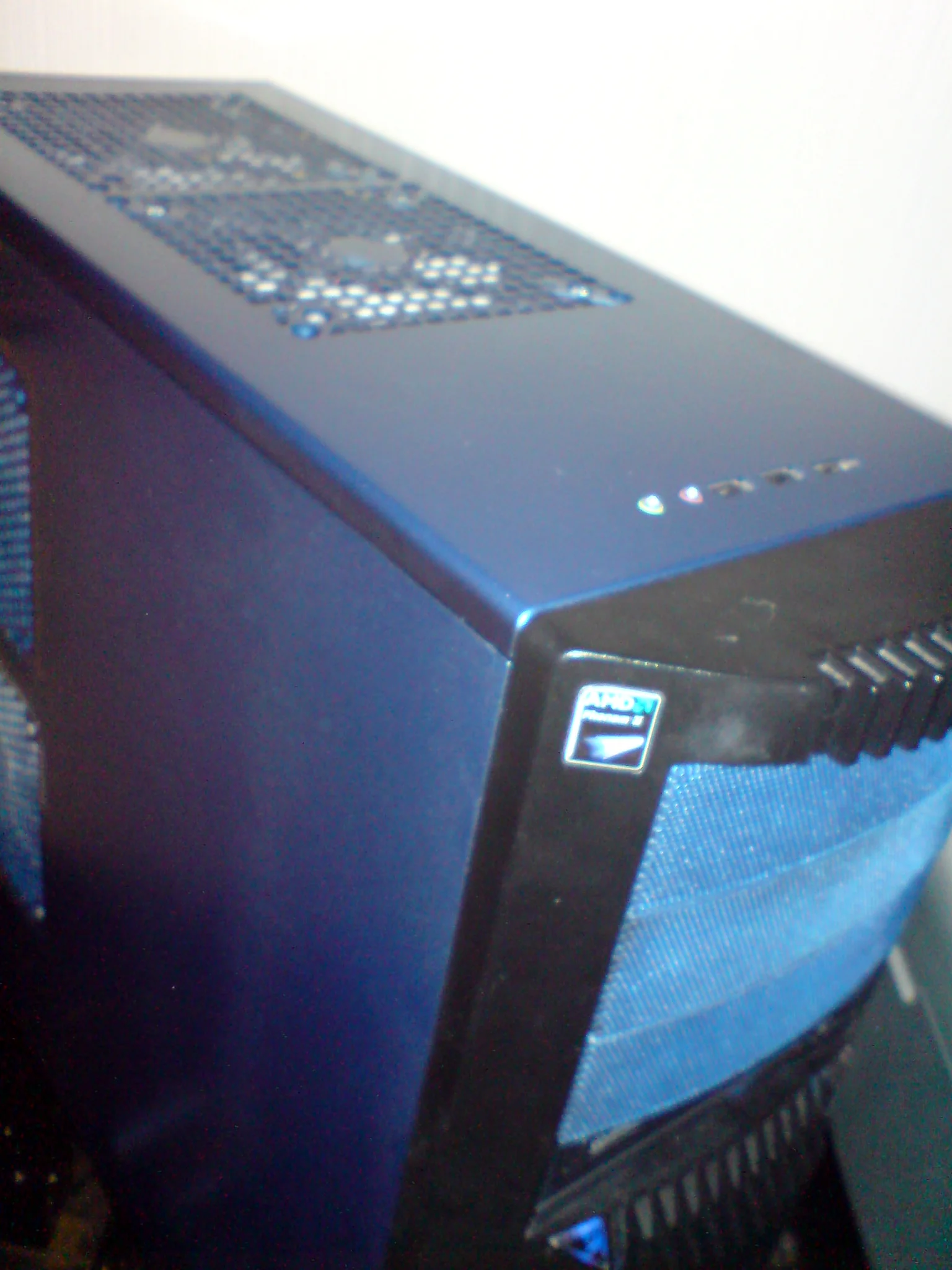

It all started when I had no clue about what I was doing (who's to say I have a clue now I guess), anyways, Here's what the case looked like before I started working on it this time around and I must apologize for the bad quality photos but the first couple was taken many years ago.
I know what you all thought, what a state though right? How can I ever produce something good if this was my previous work? :O

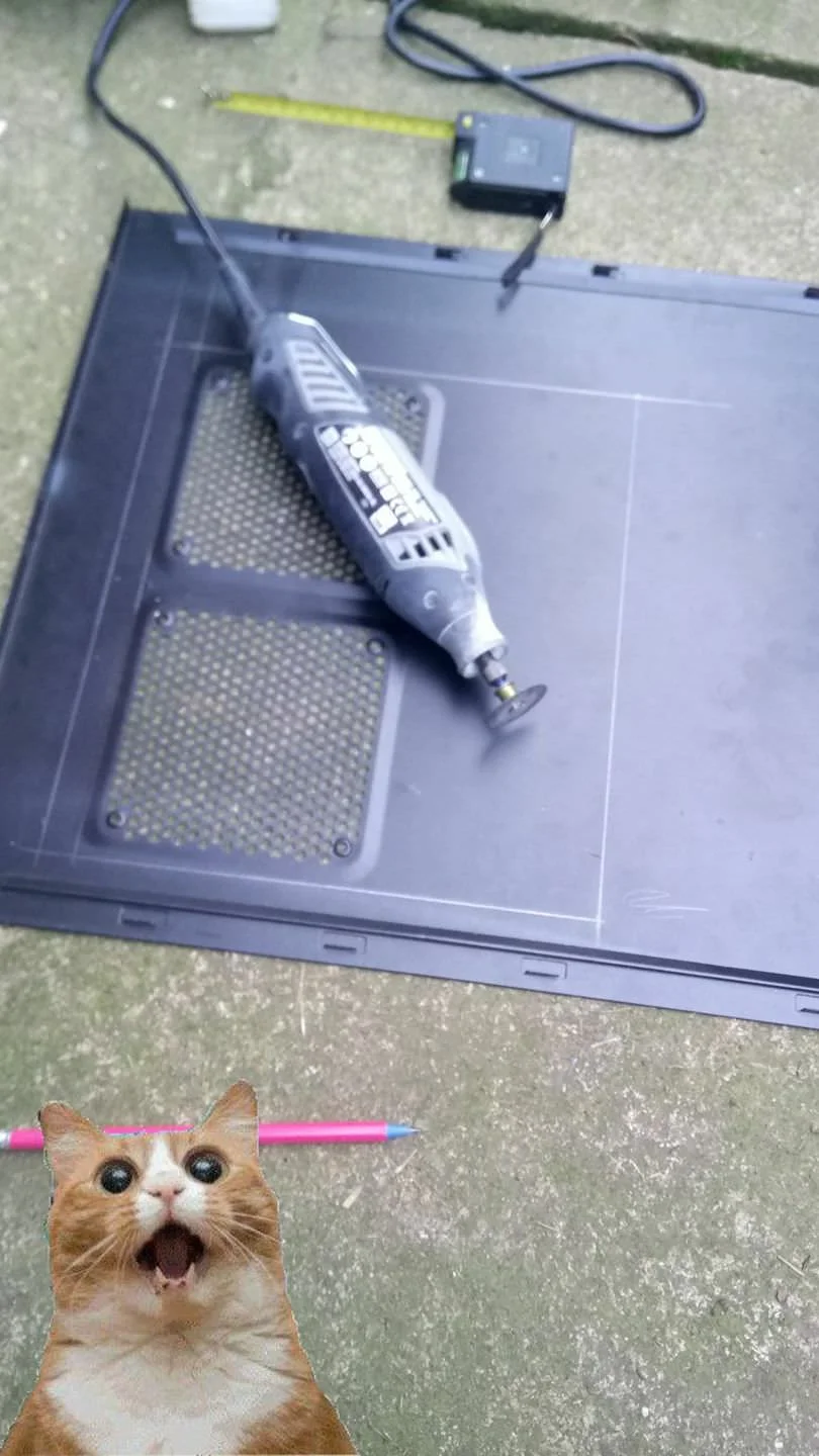

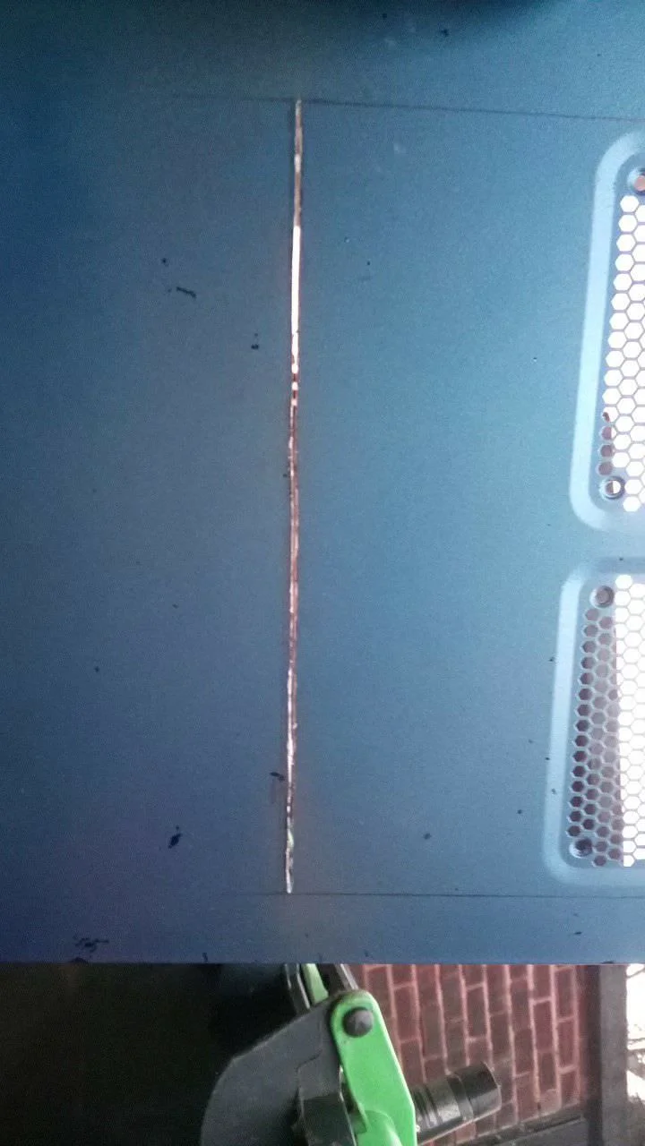

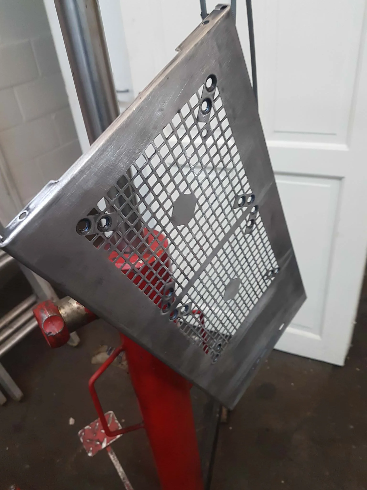

Anyway's Here I go, lining up to make the first cut! I might of been wishing for a bit of luck here on out...
And of we cut!
As it turns out I got rather into cutting and didn't stop to take any more photos.

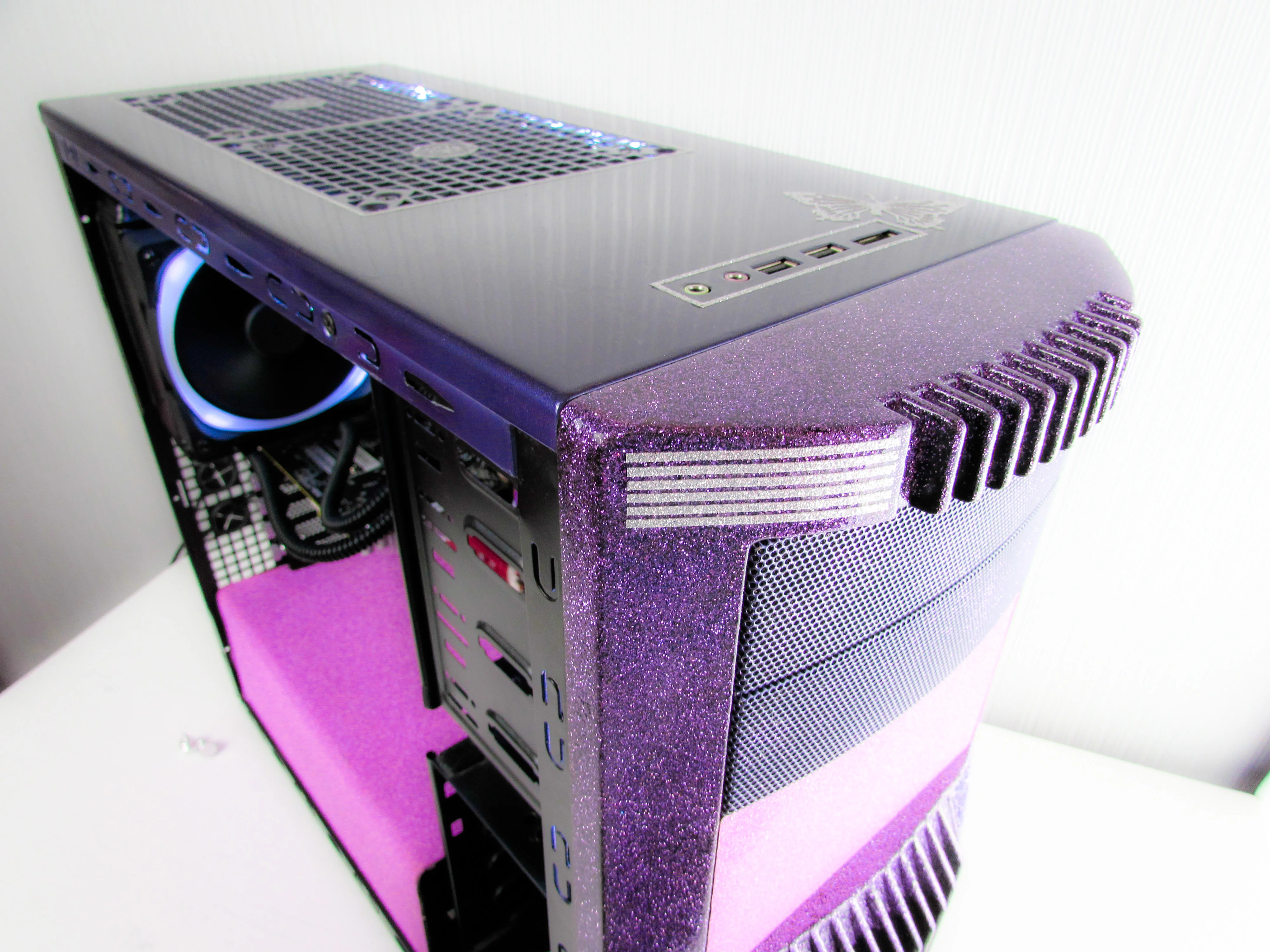

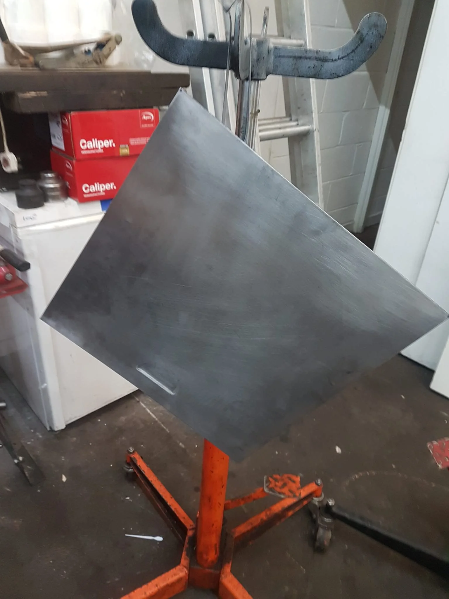

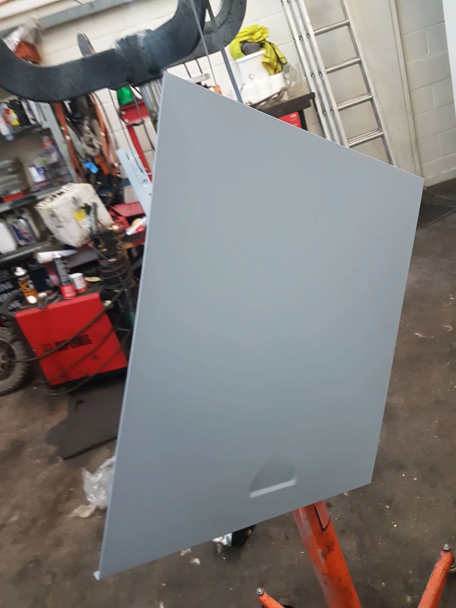

Time for prepping!! If I'm honest I rather like this look, reminds me of Robocop but then I remind myself that this build isn't for me...
On goes the primer.

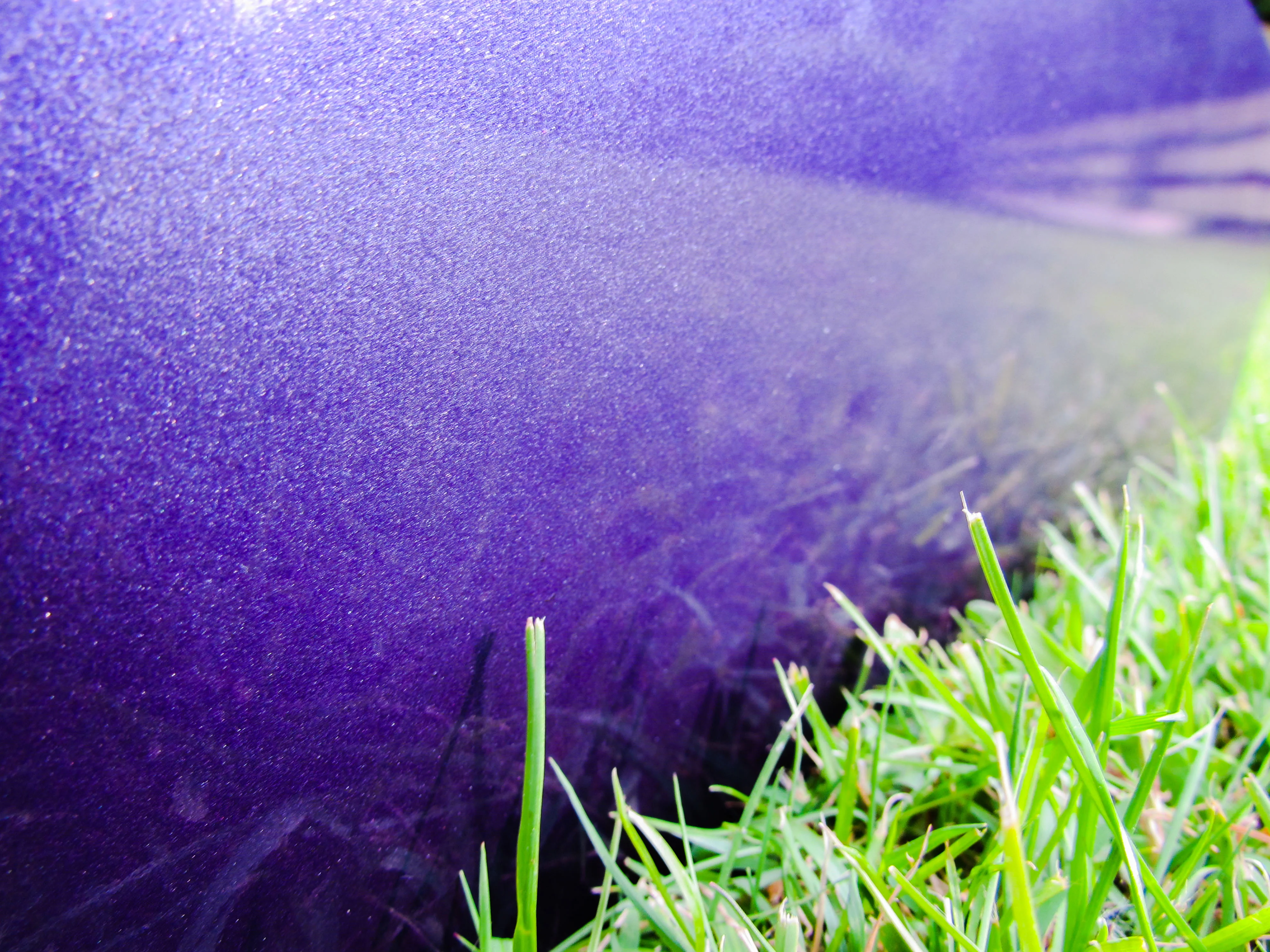

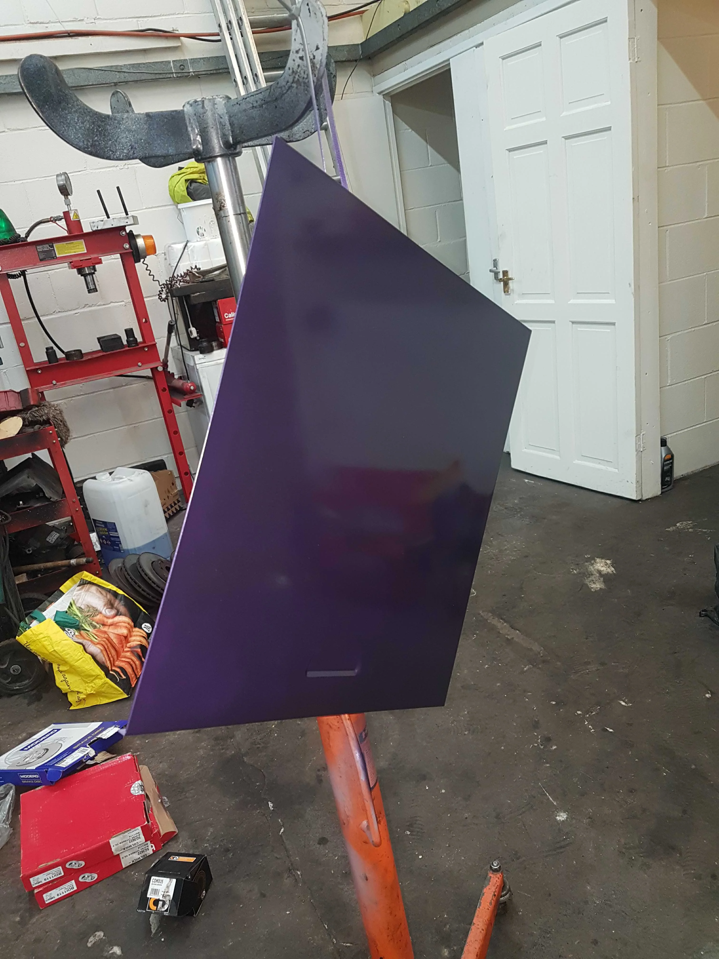

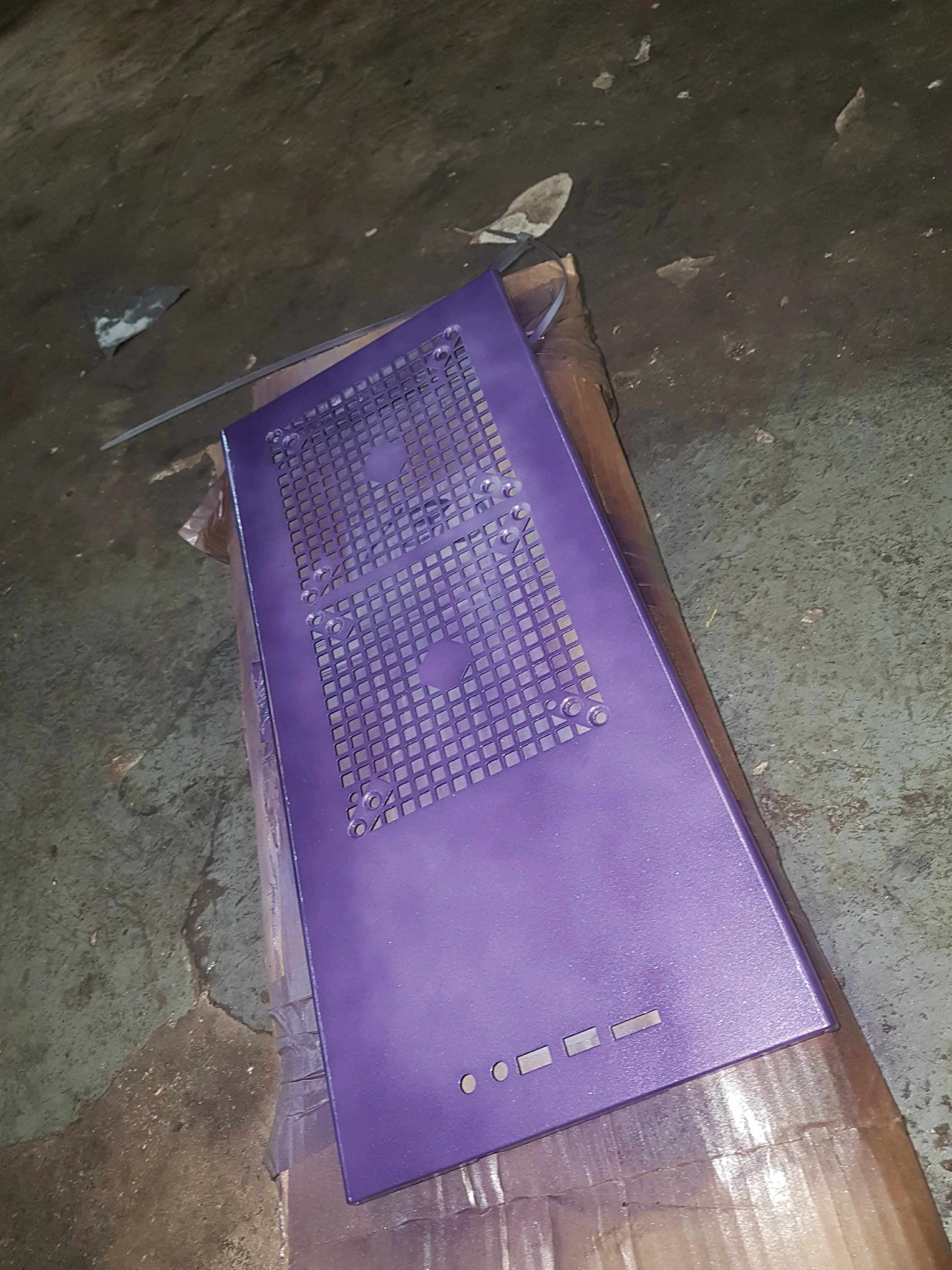

Now this is where you start to see the colour my daughter chosen for her rig and it is Ford Purple velvet!
First layer of base coat
Second layer of base coat.

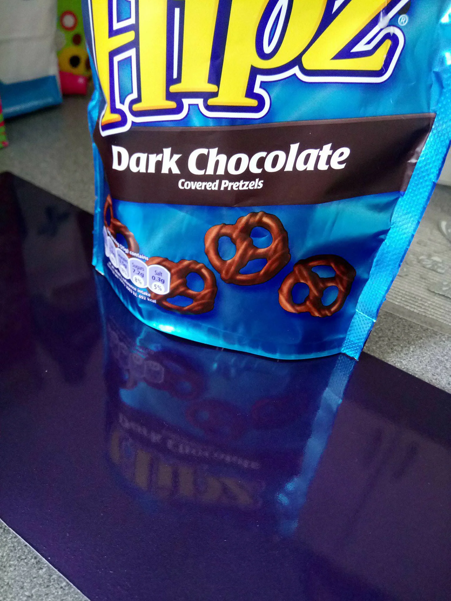

Once the final coat had been applied along with the layers of clear coat and buffed the weather wasn't so great and had to settle for this somewhat appetizing photo.
Here's a better shot though.

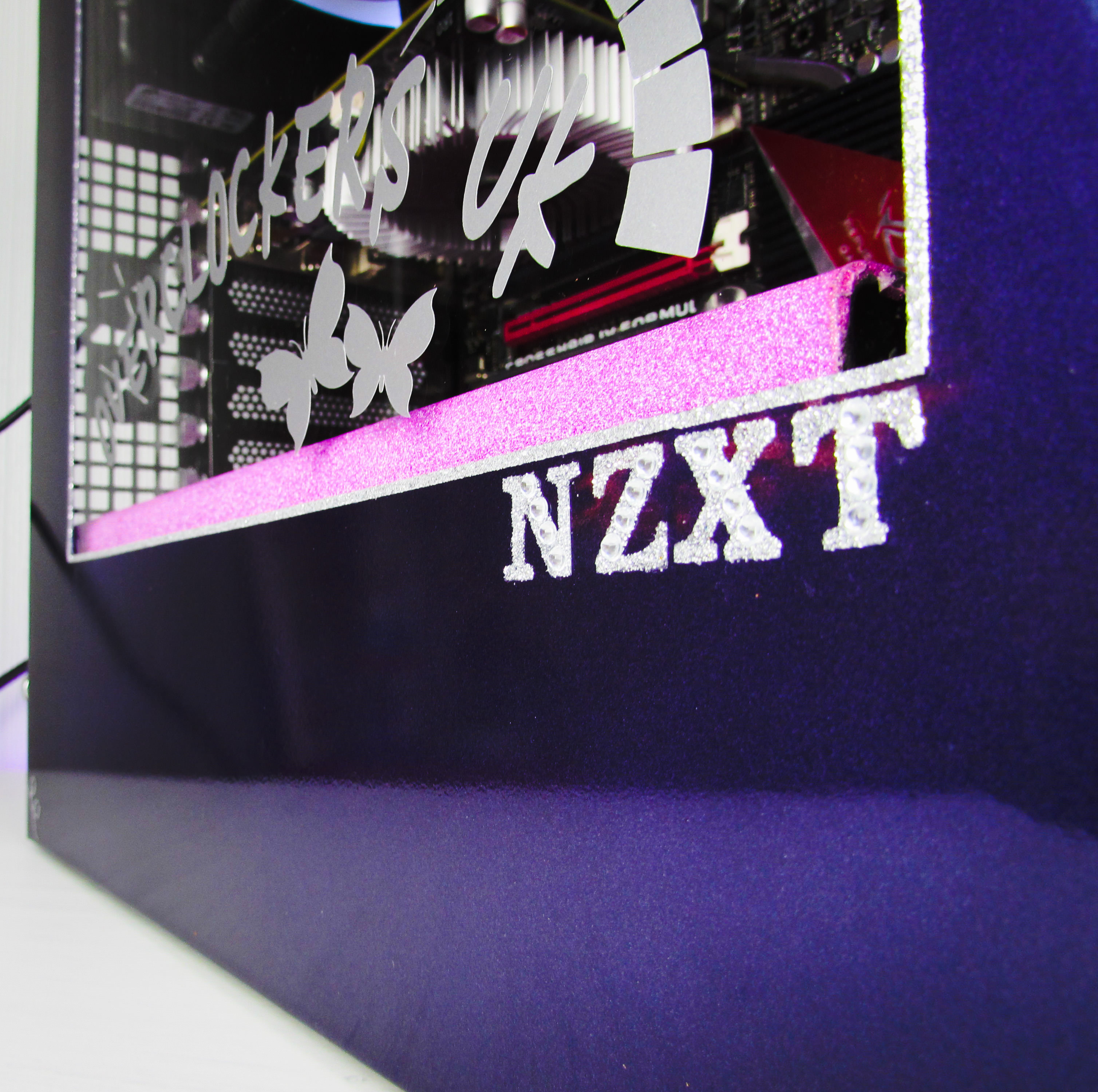

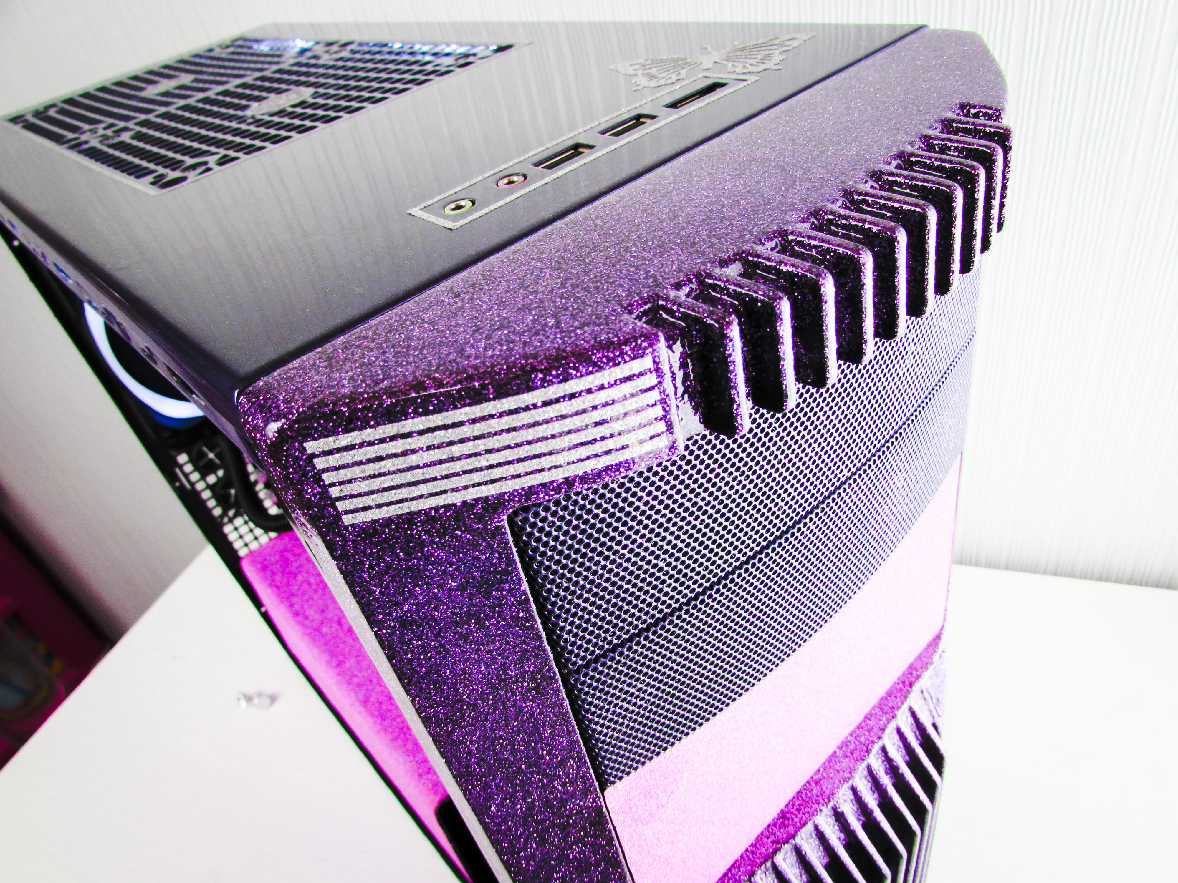

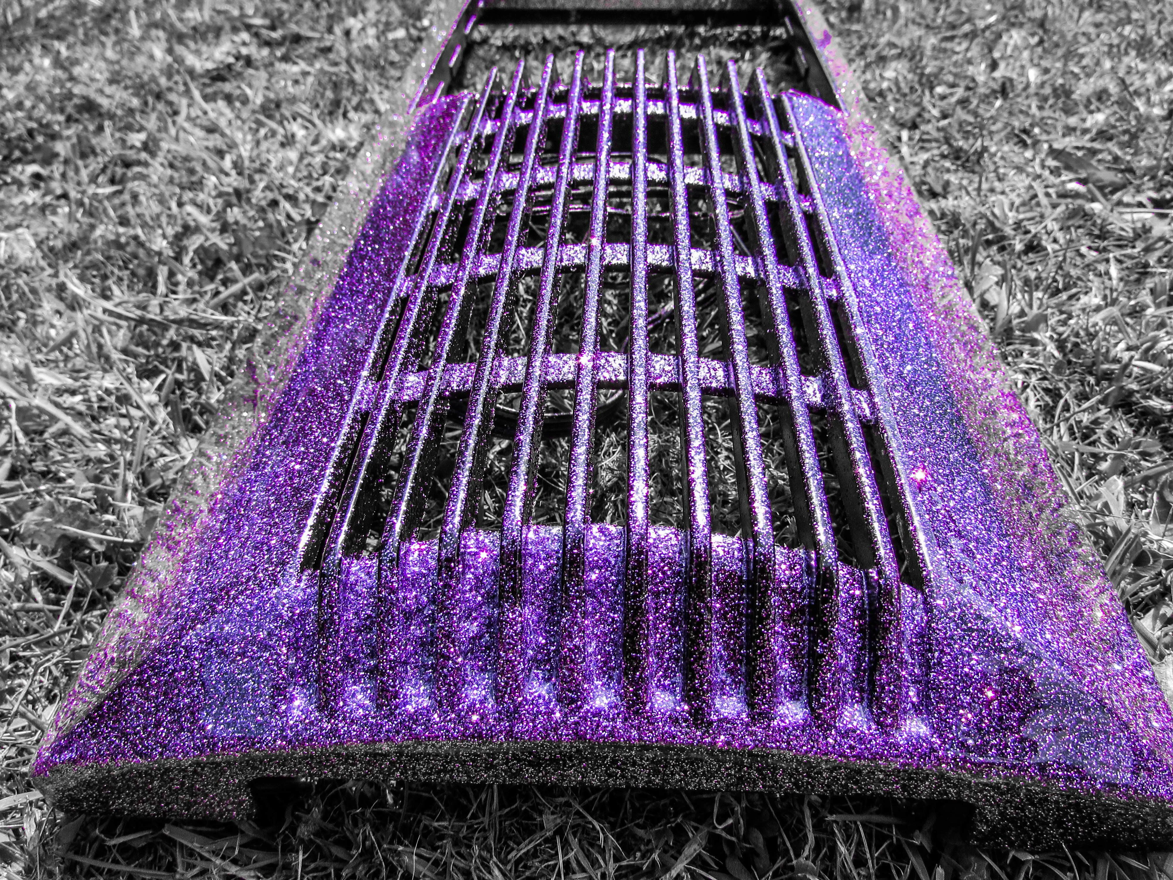

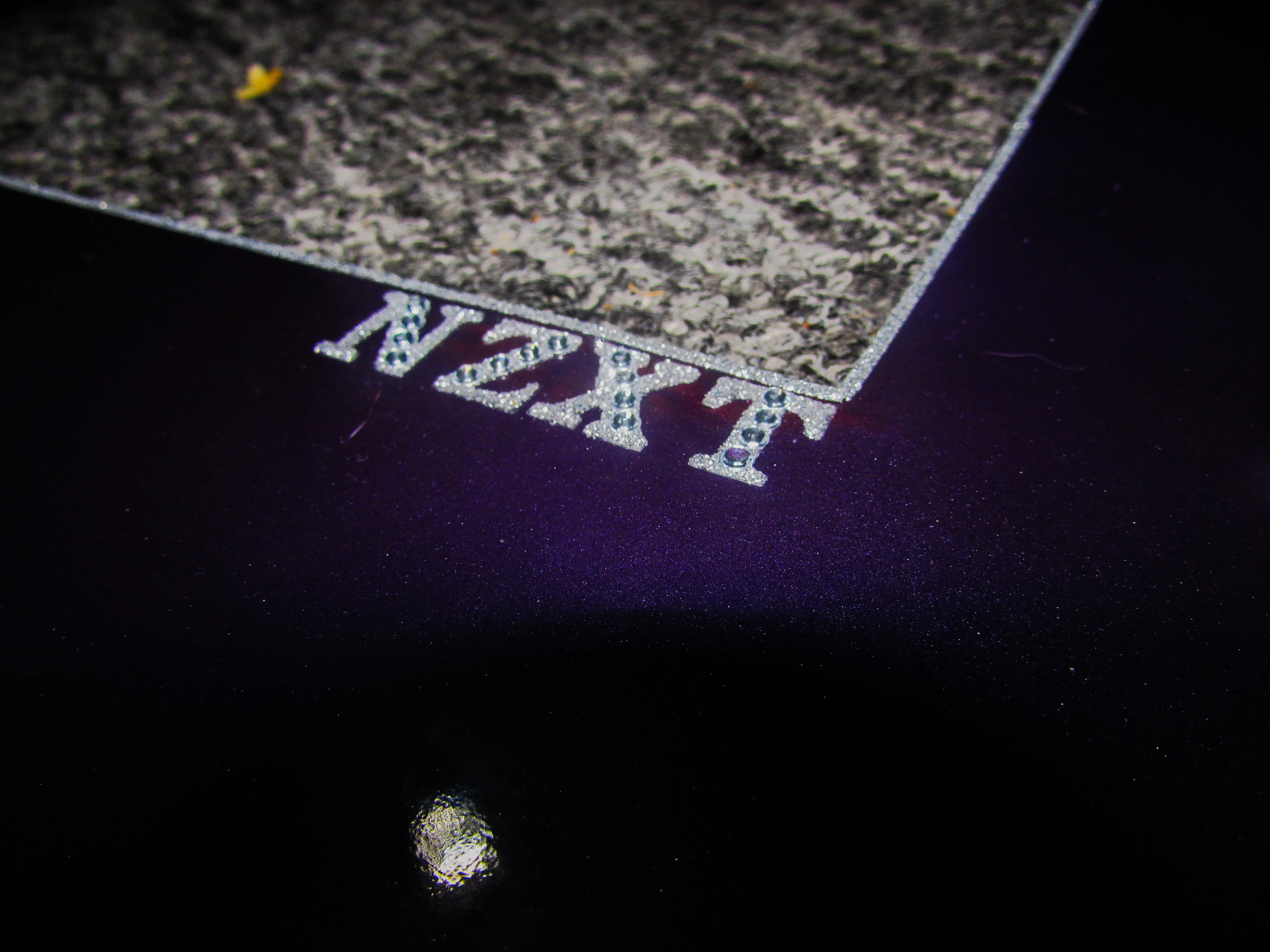

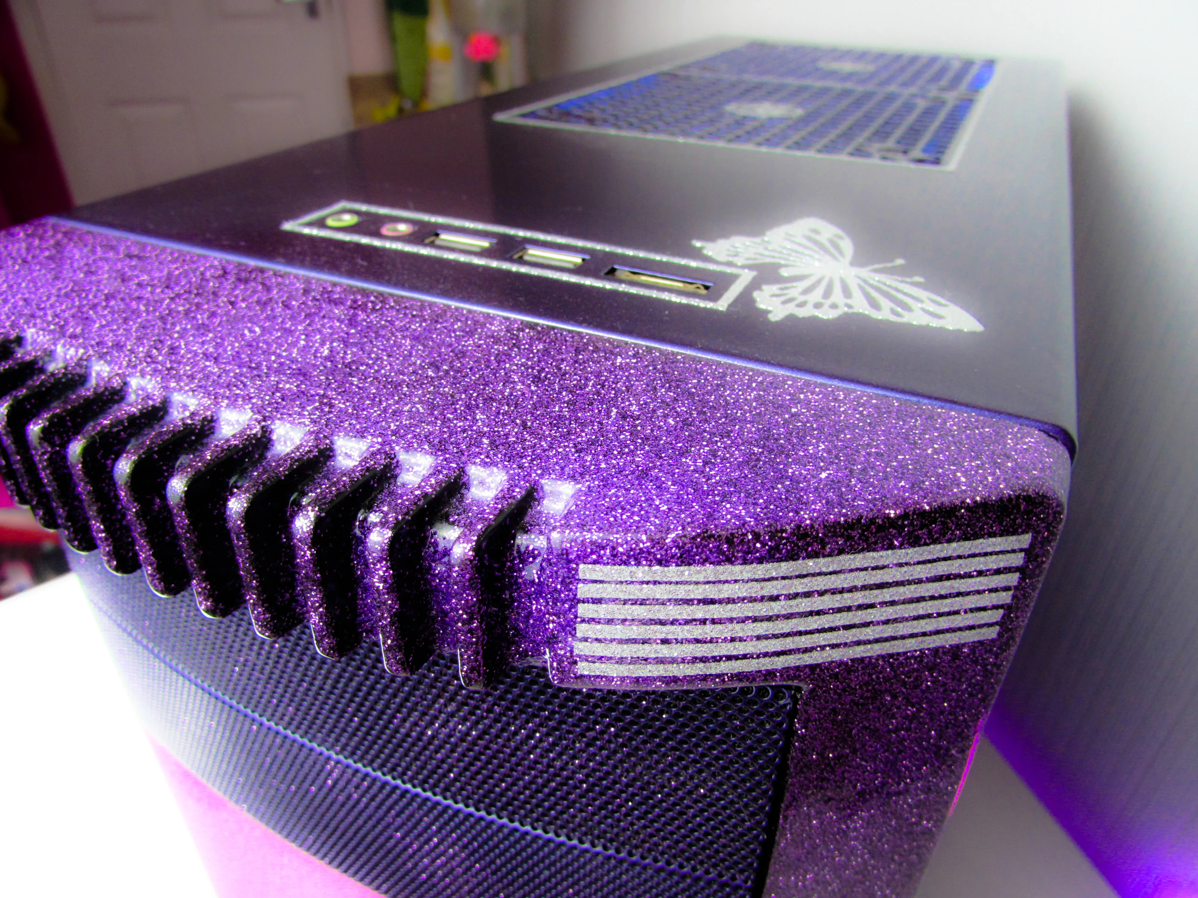

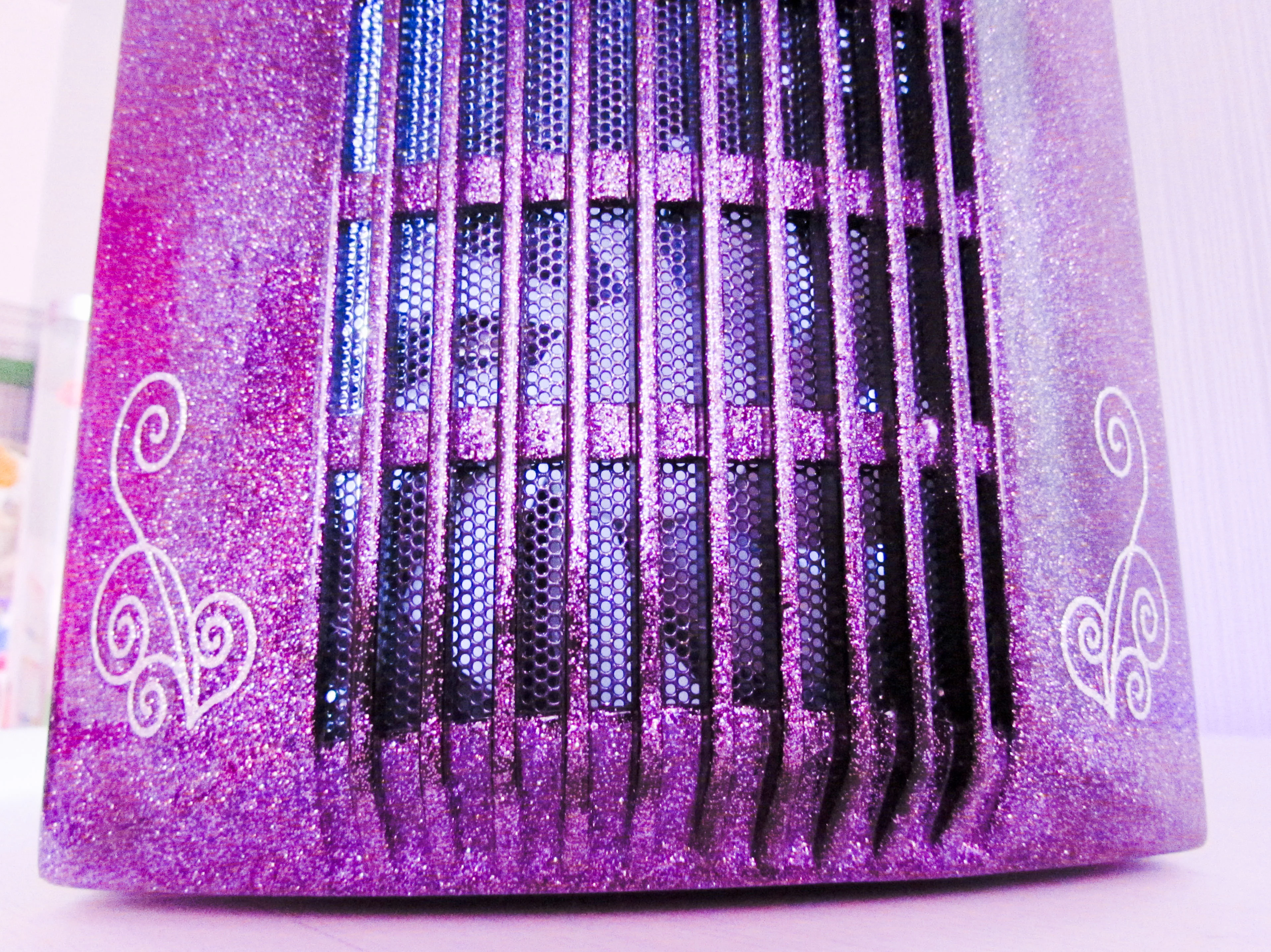

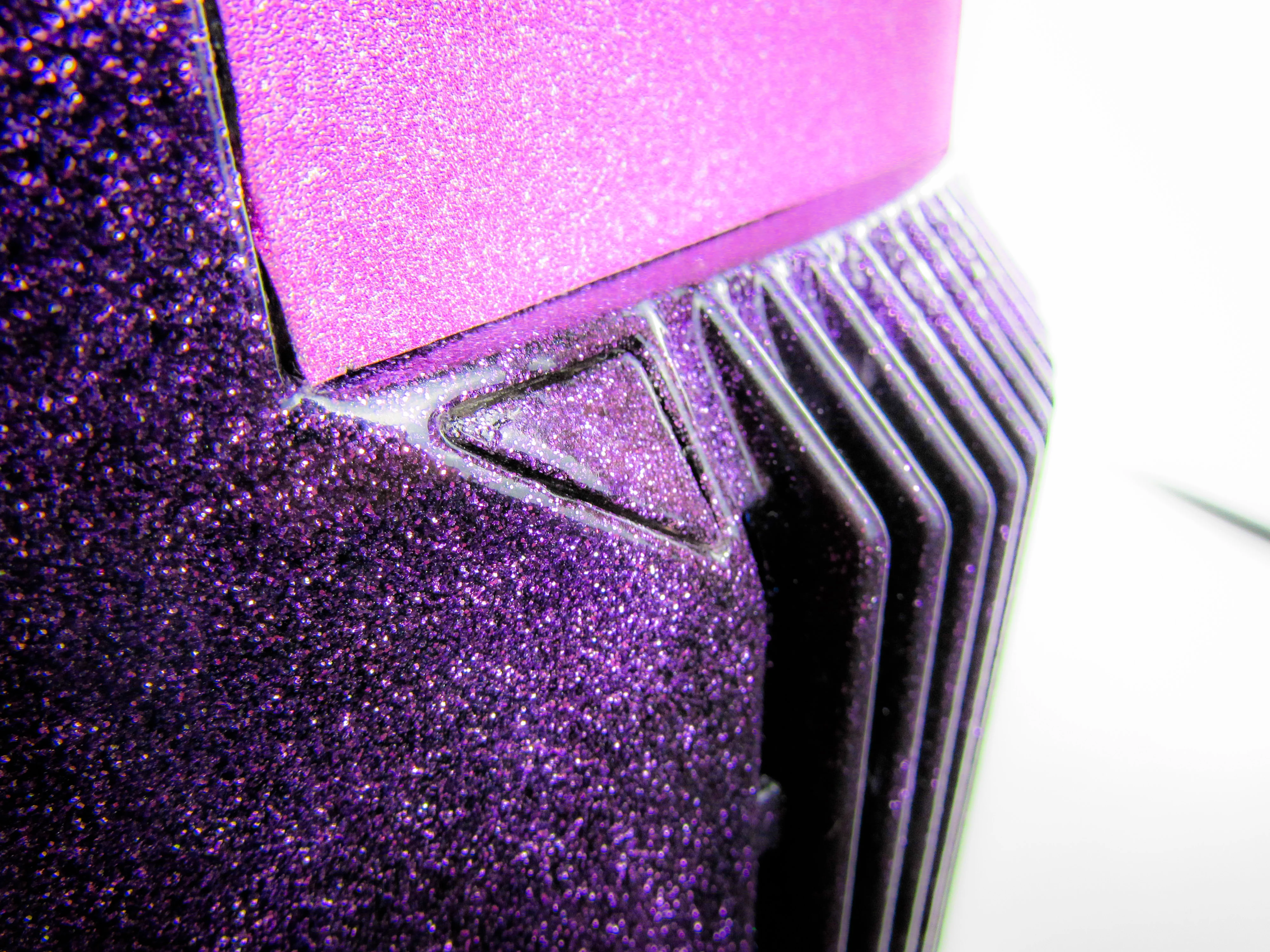

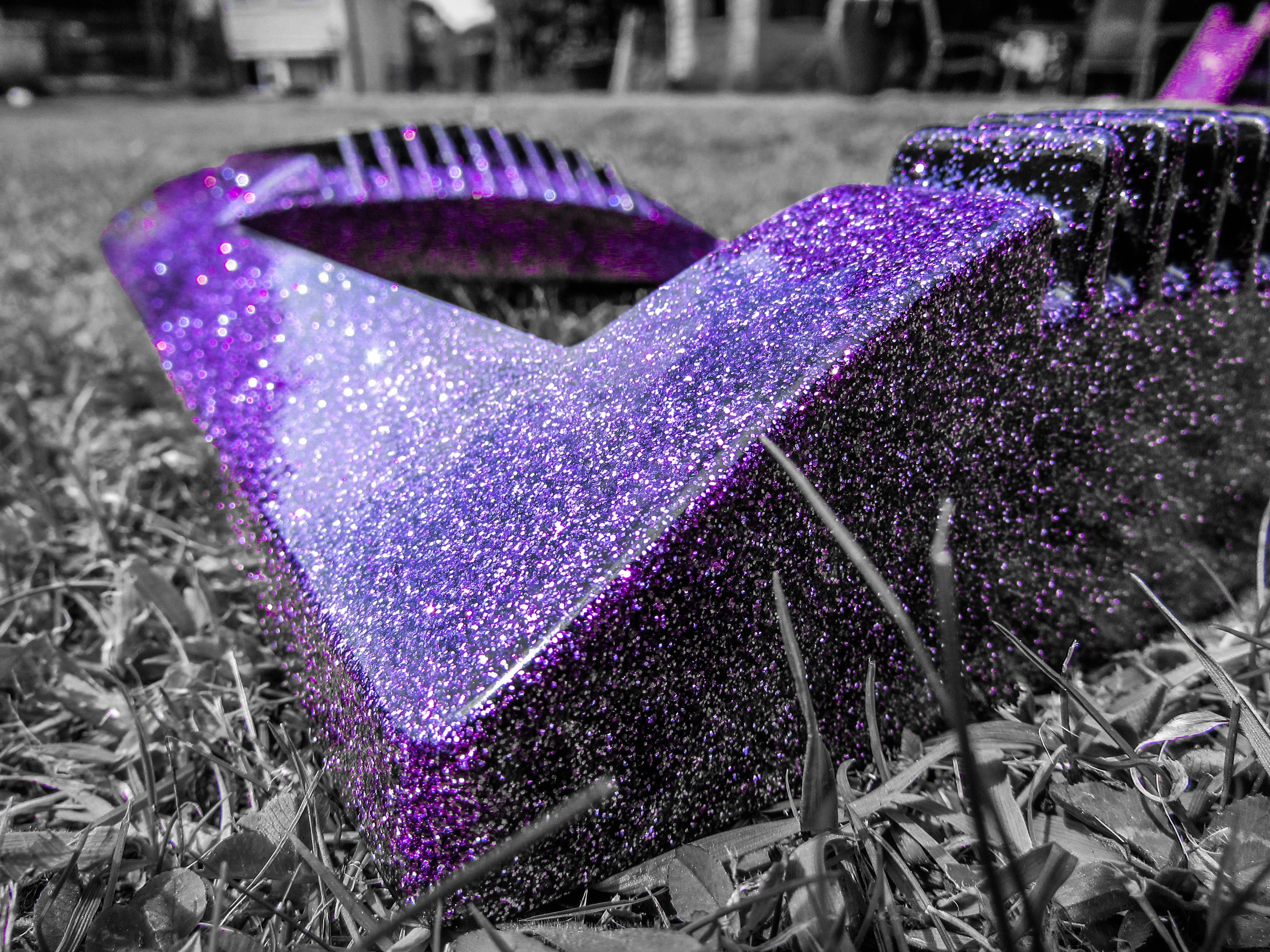

Now that all the panels are painted I think it is time to concentrate on the front bezel of the case. This was the hardest part of the build by far, somewhat by my own mistakes but the end results was more than worth it, let me show you the beauty after I explain the steps used to create this look.

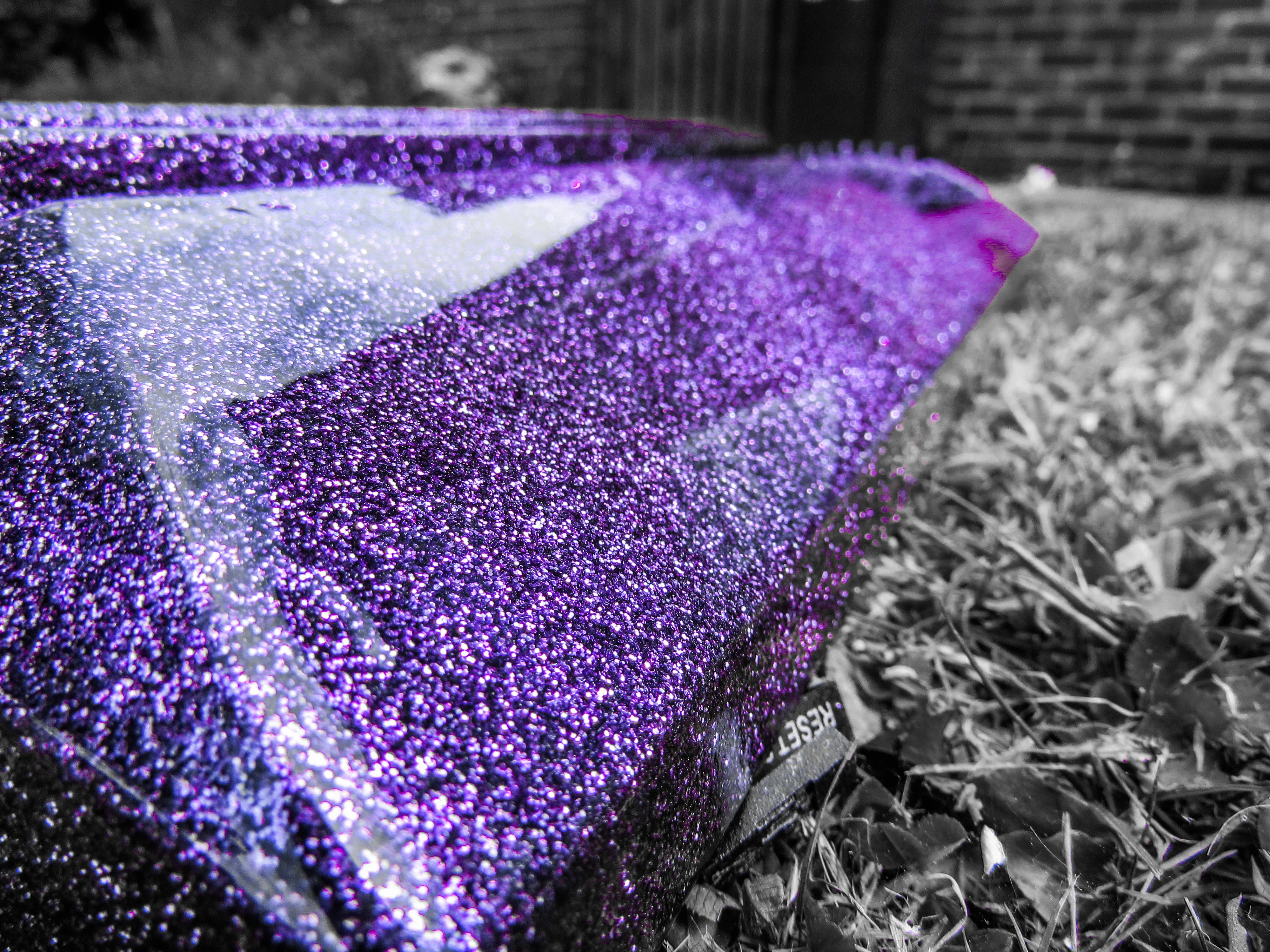

It all started with a little sparkle...
Then... Primer, matt black paint, sprinkle with glitter whilst wet, flat off, lacquer (at least 800 times maybe more depending on how much glitter you used) flat off with 1200 then 2000 wet and dry sandpaper and a block re-lacquer and then finally buff the hell out of it!!
In the end you should end up with something looking a little like this.
I understand this look won't be for everyone but let me just take this moment to remind you all this for a little girls 5th birthday. :)

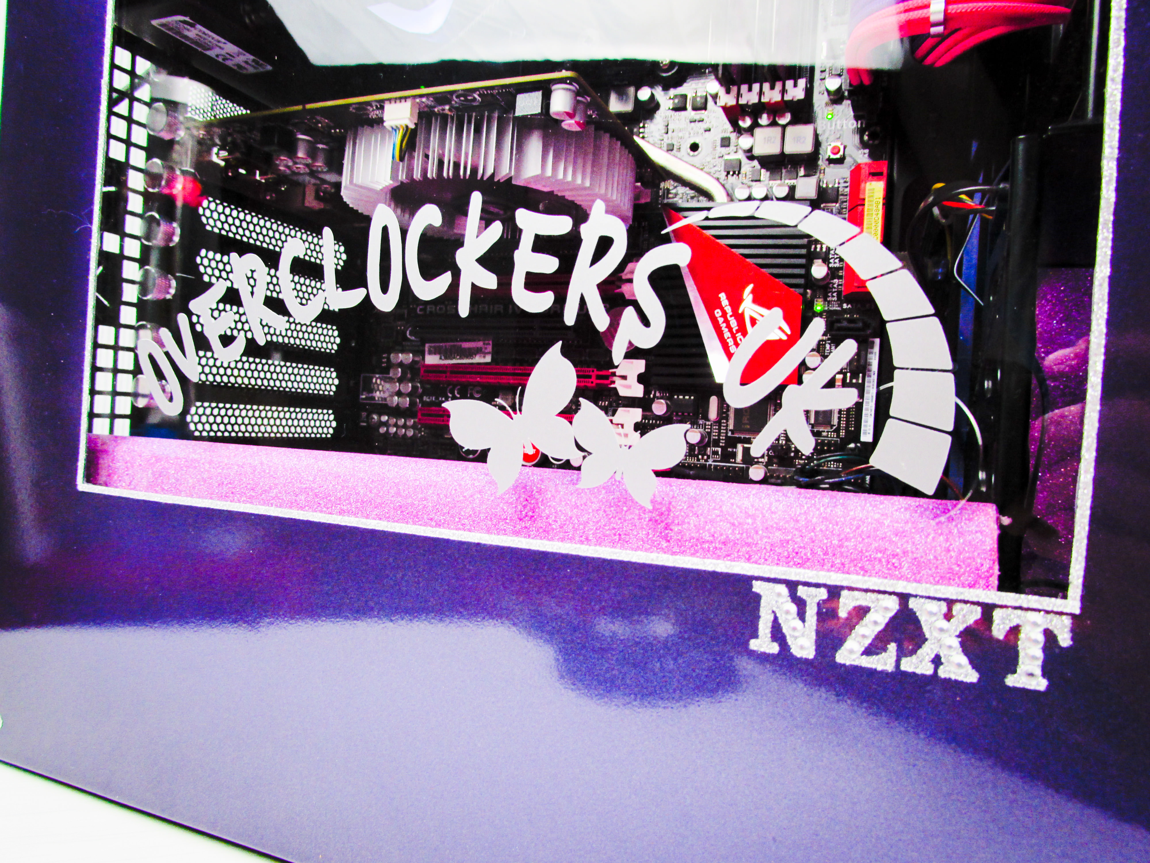

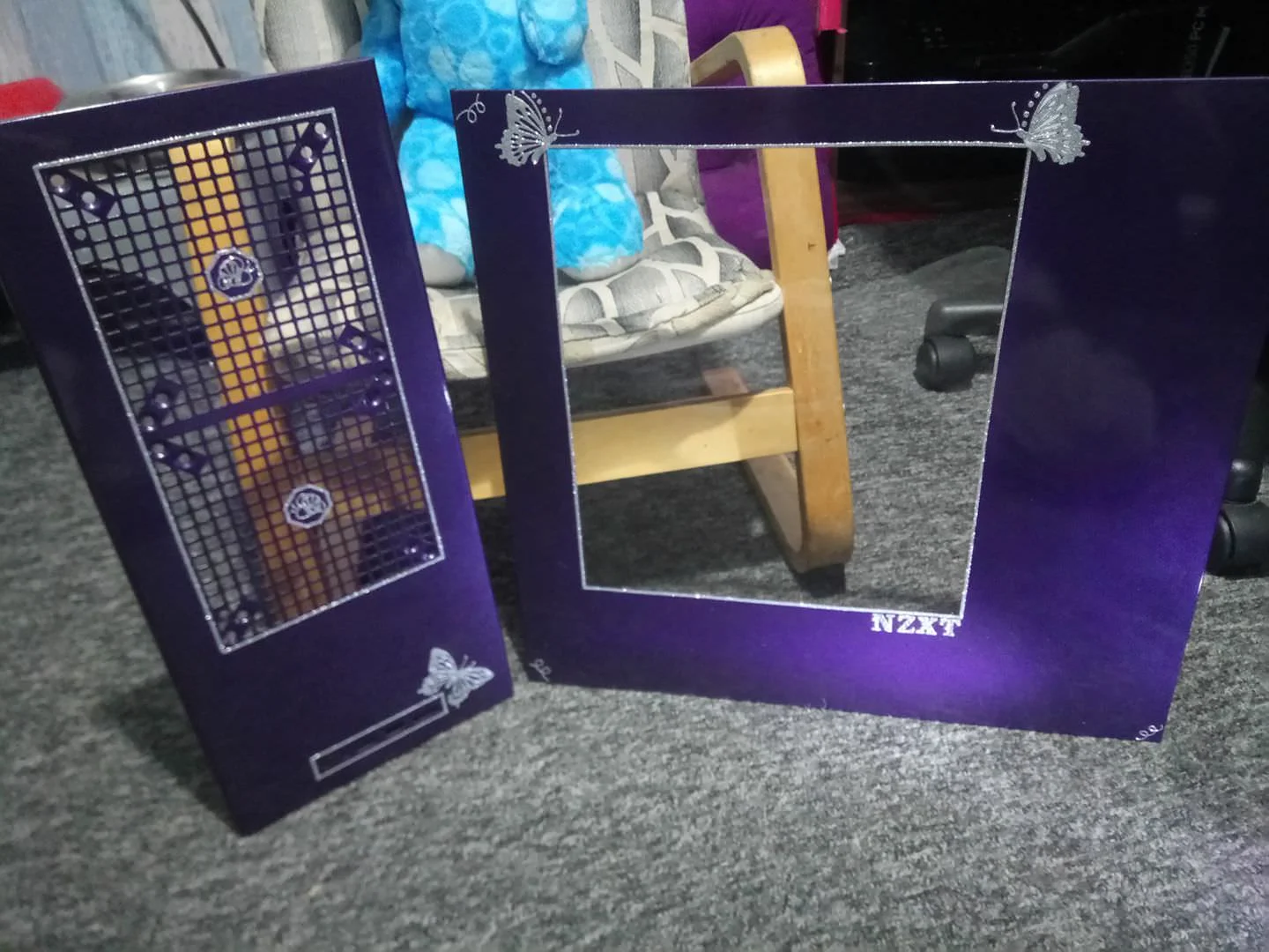

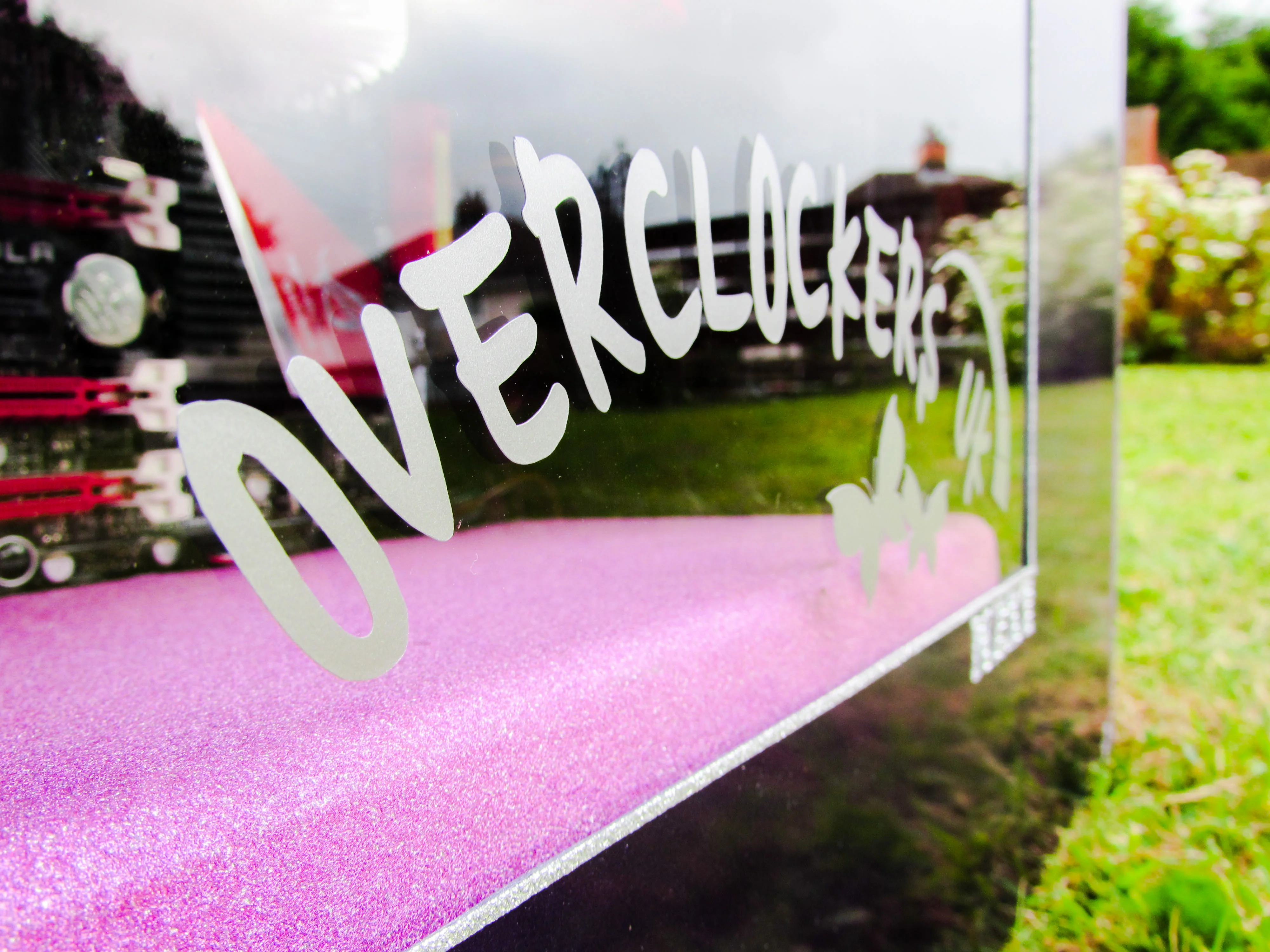

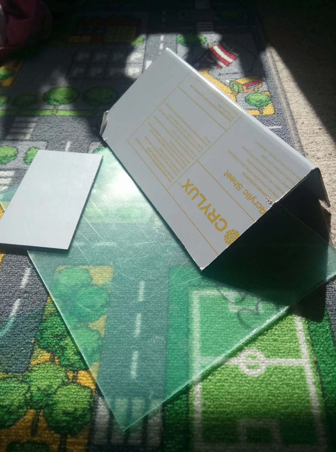

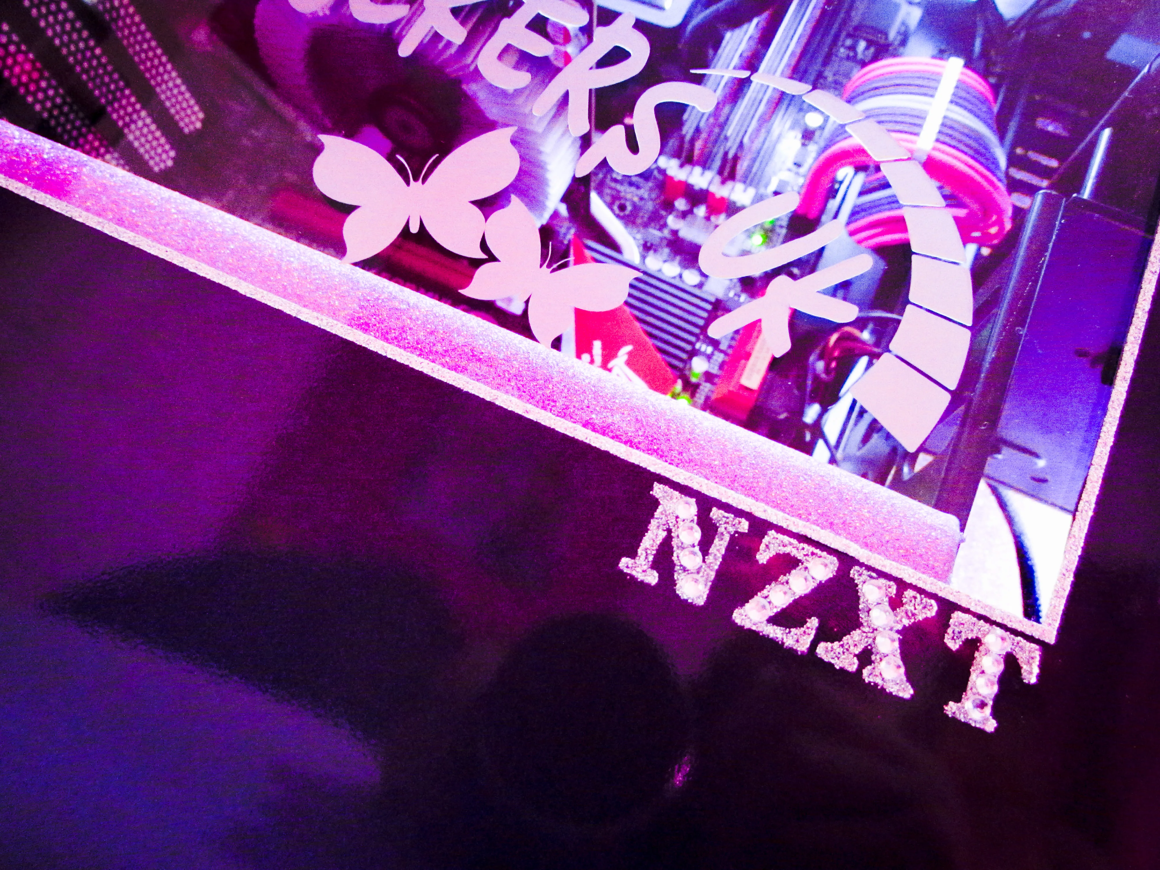

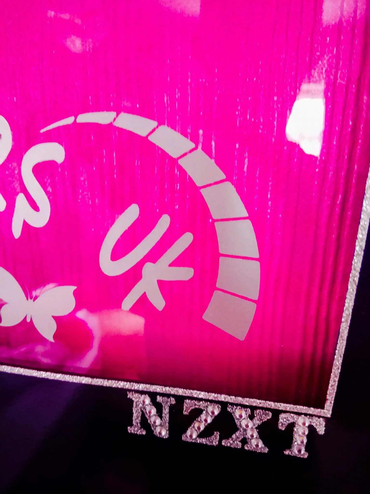

Here's the acrylics :D

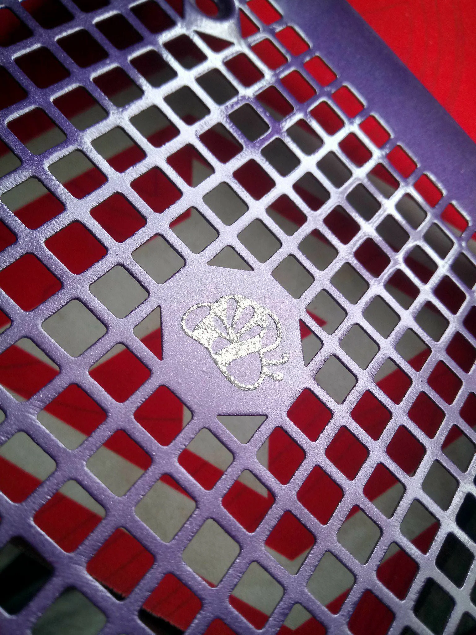

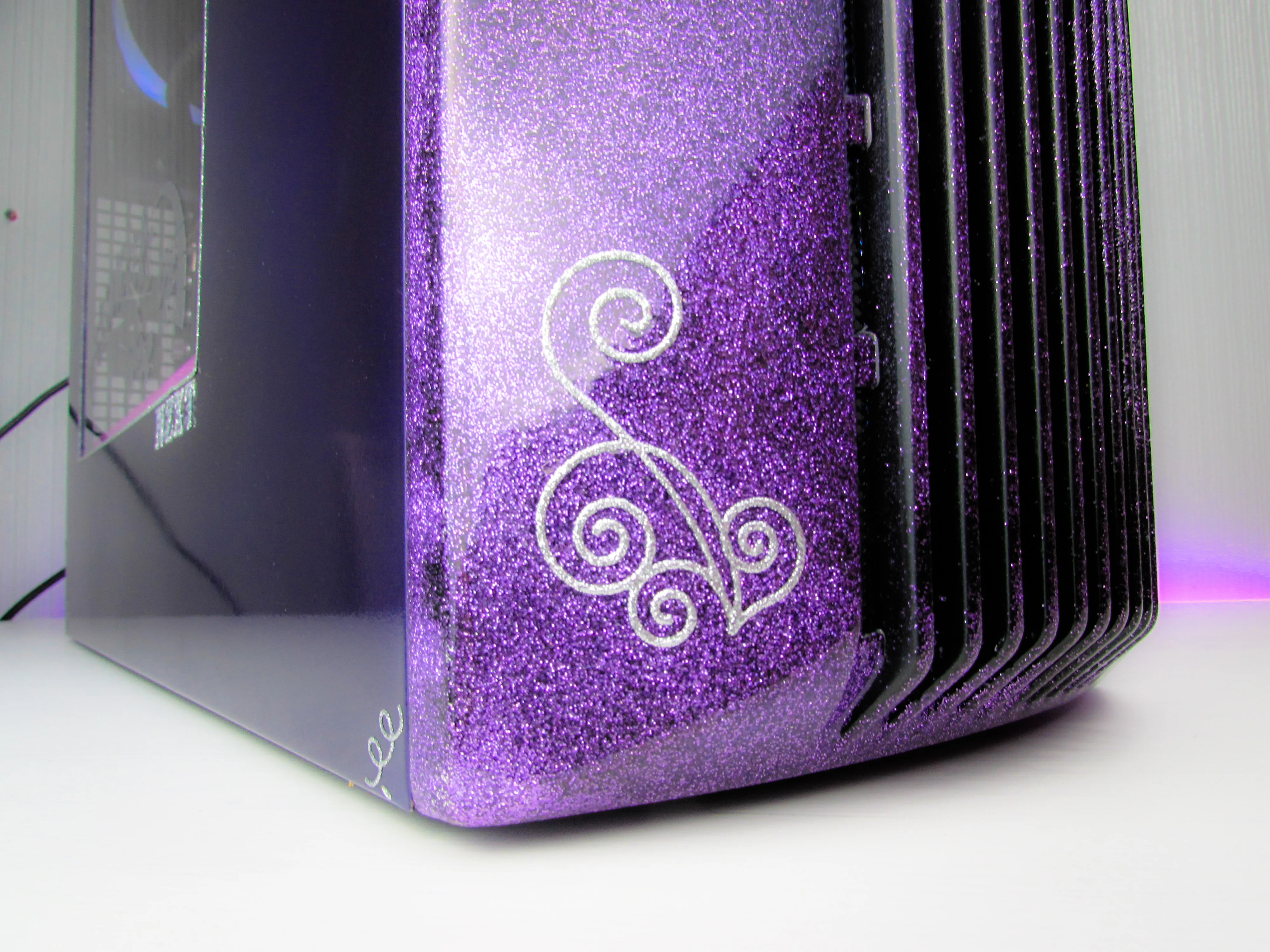

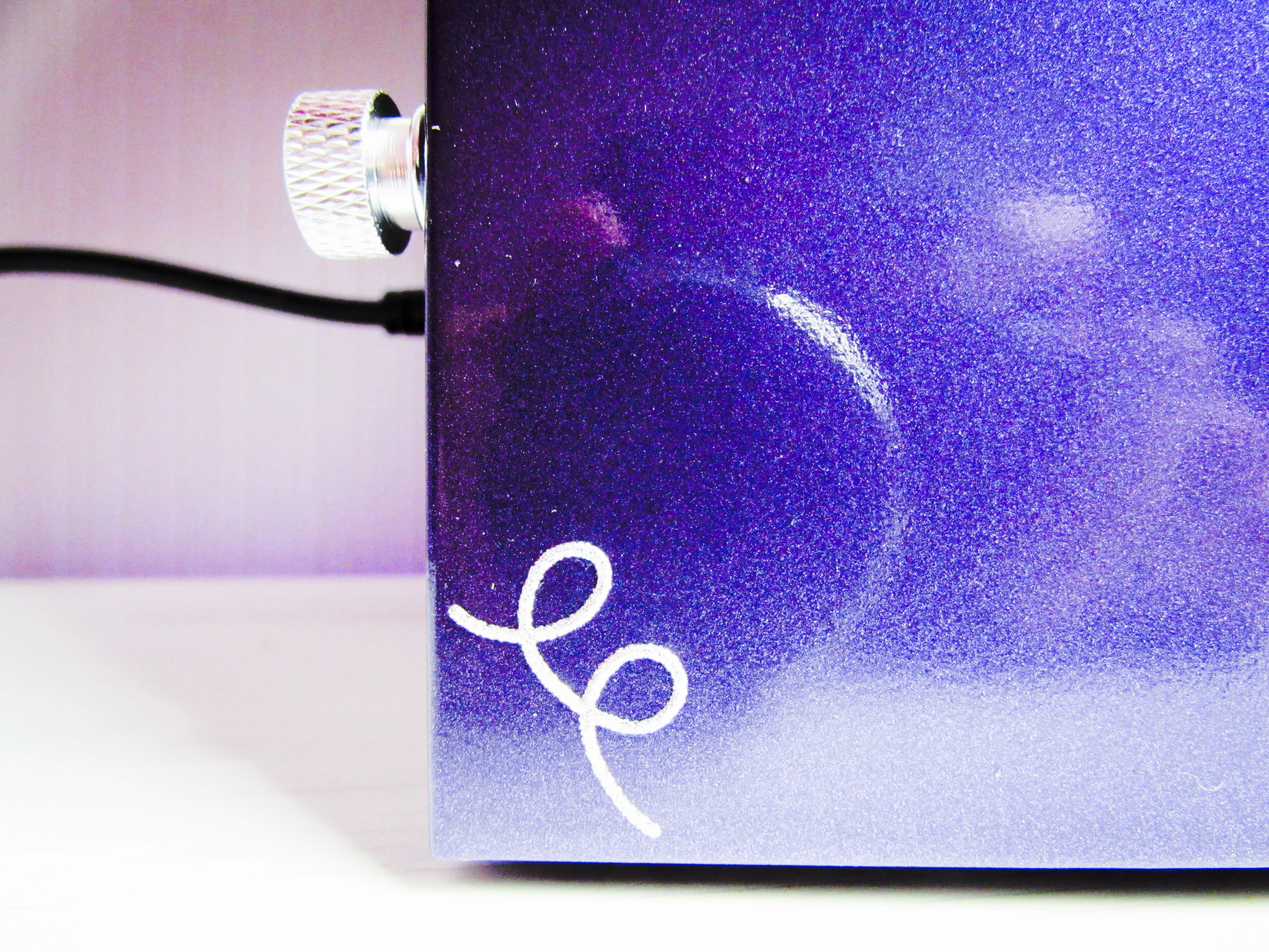

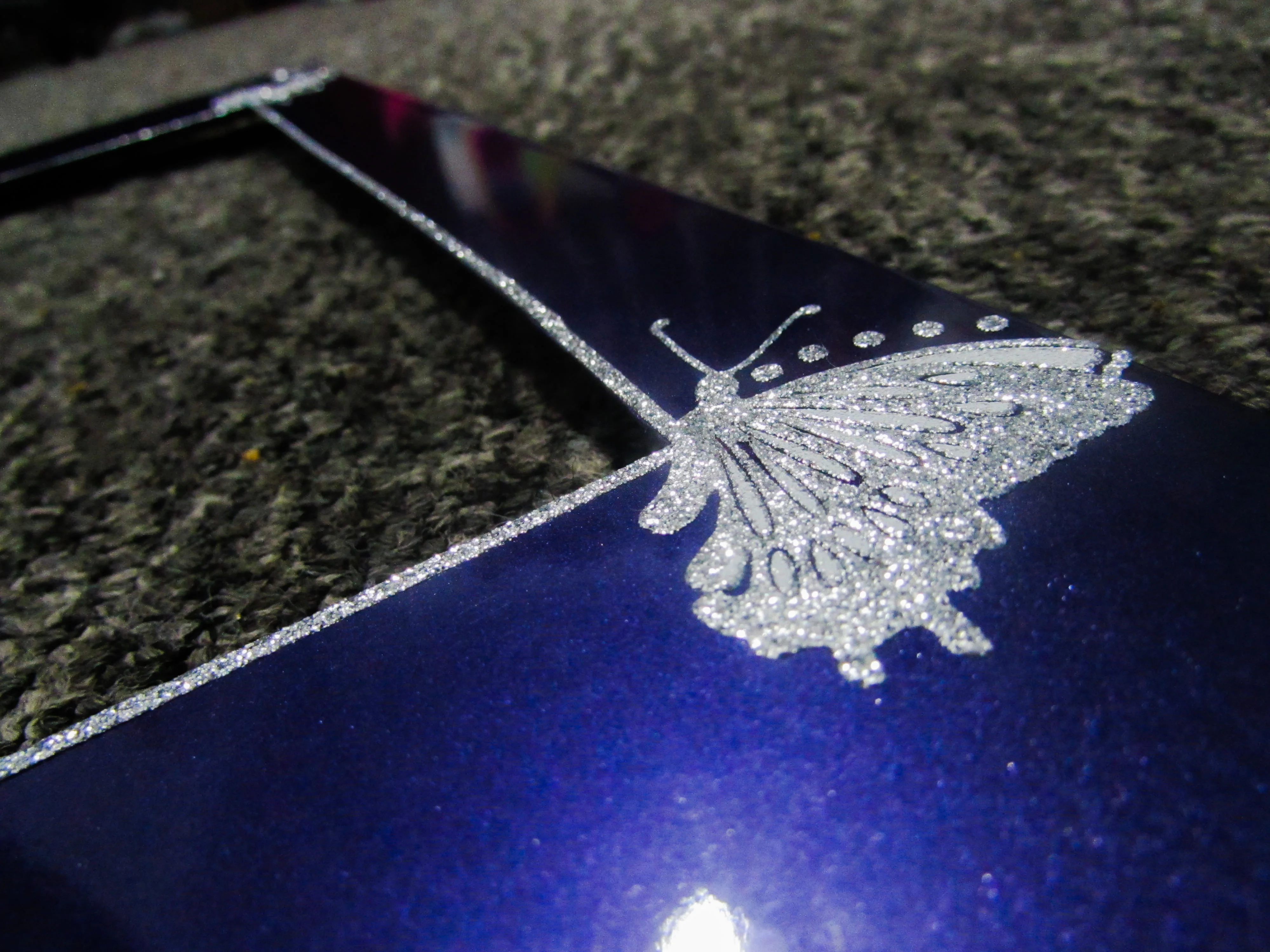

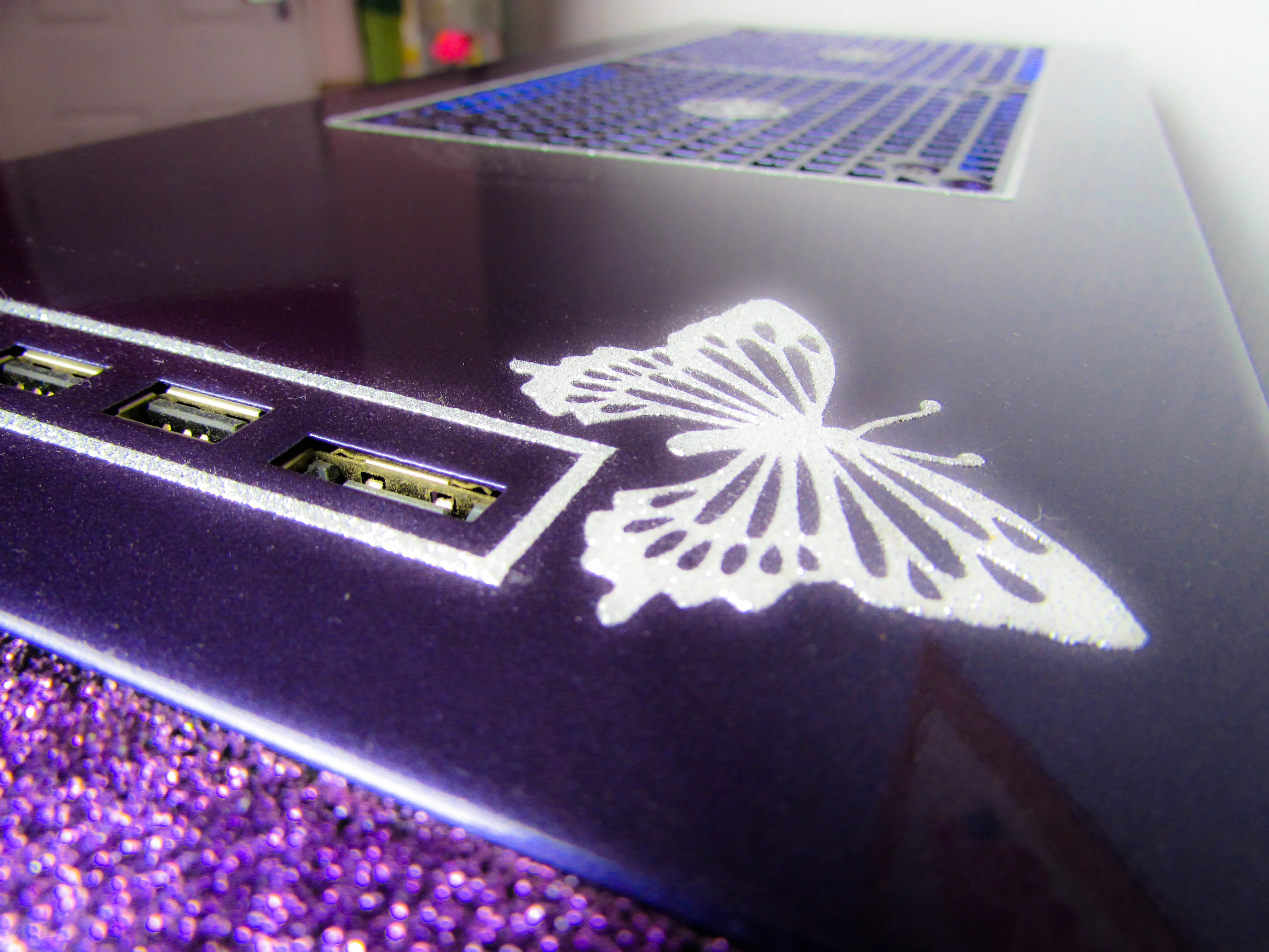

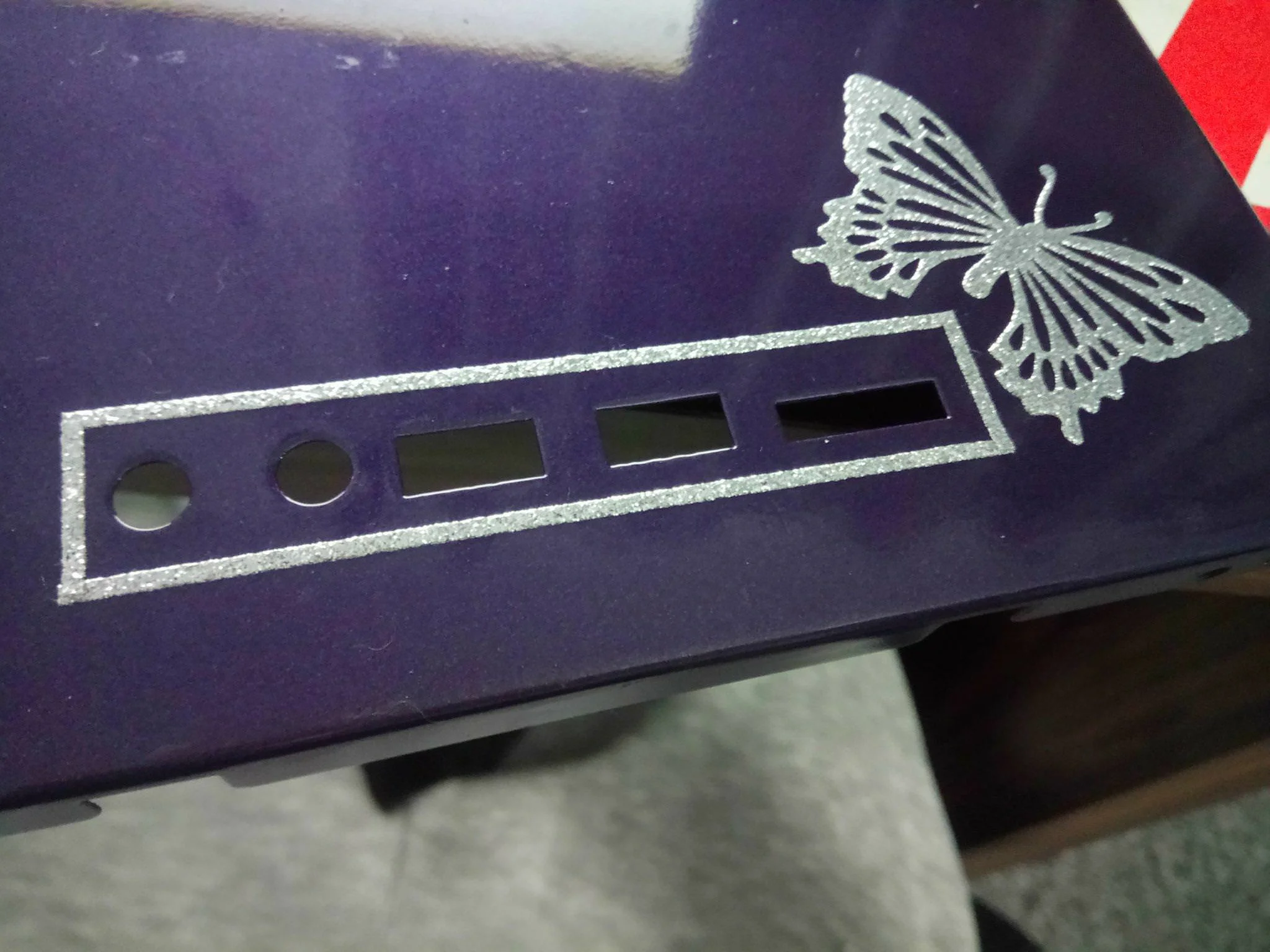

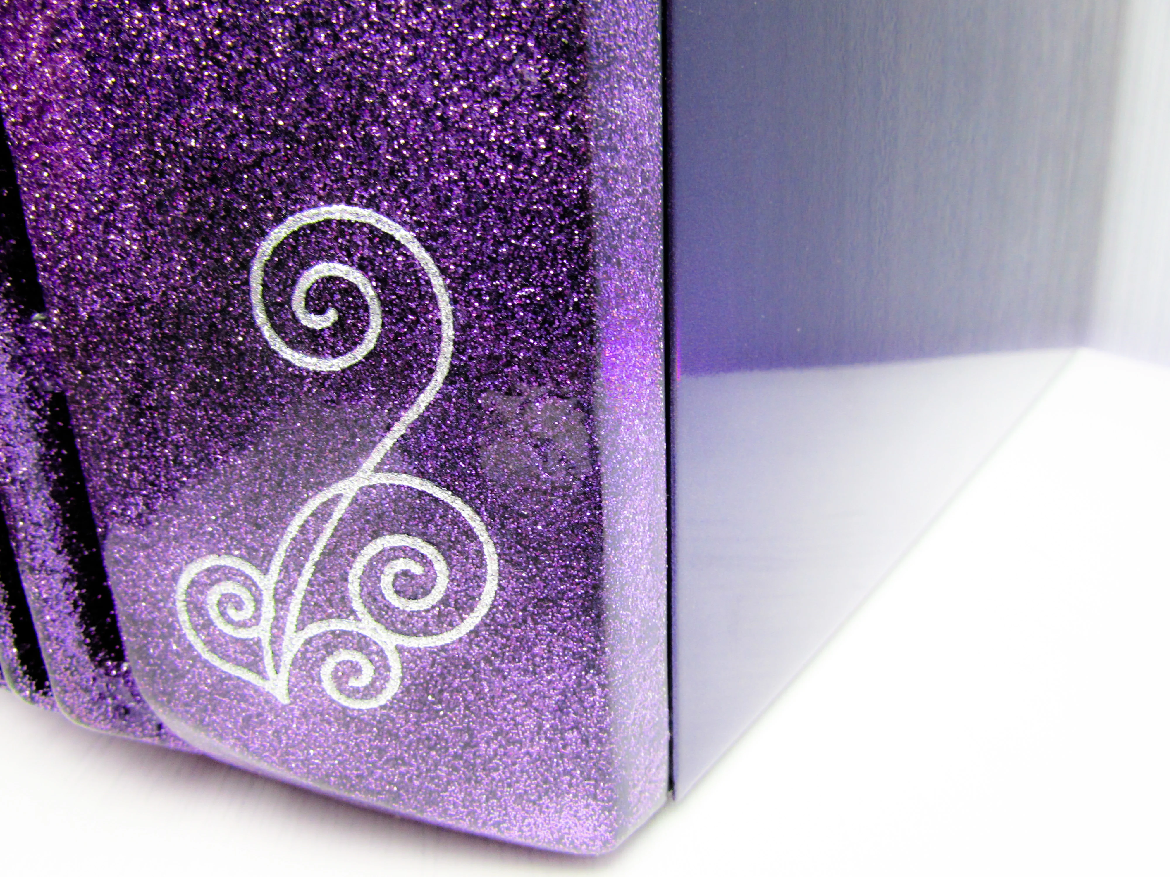

Now, time for some artwork on the side and top panels.

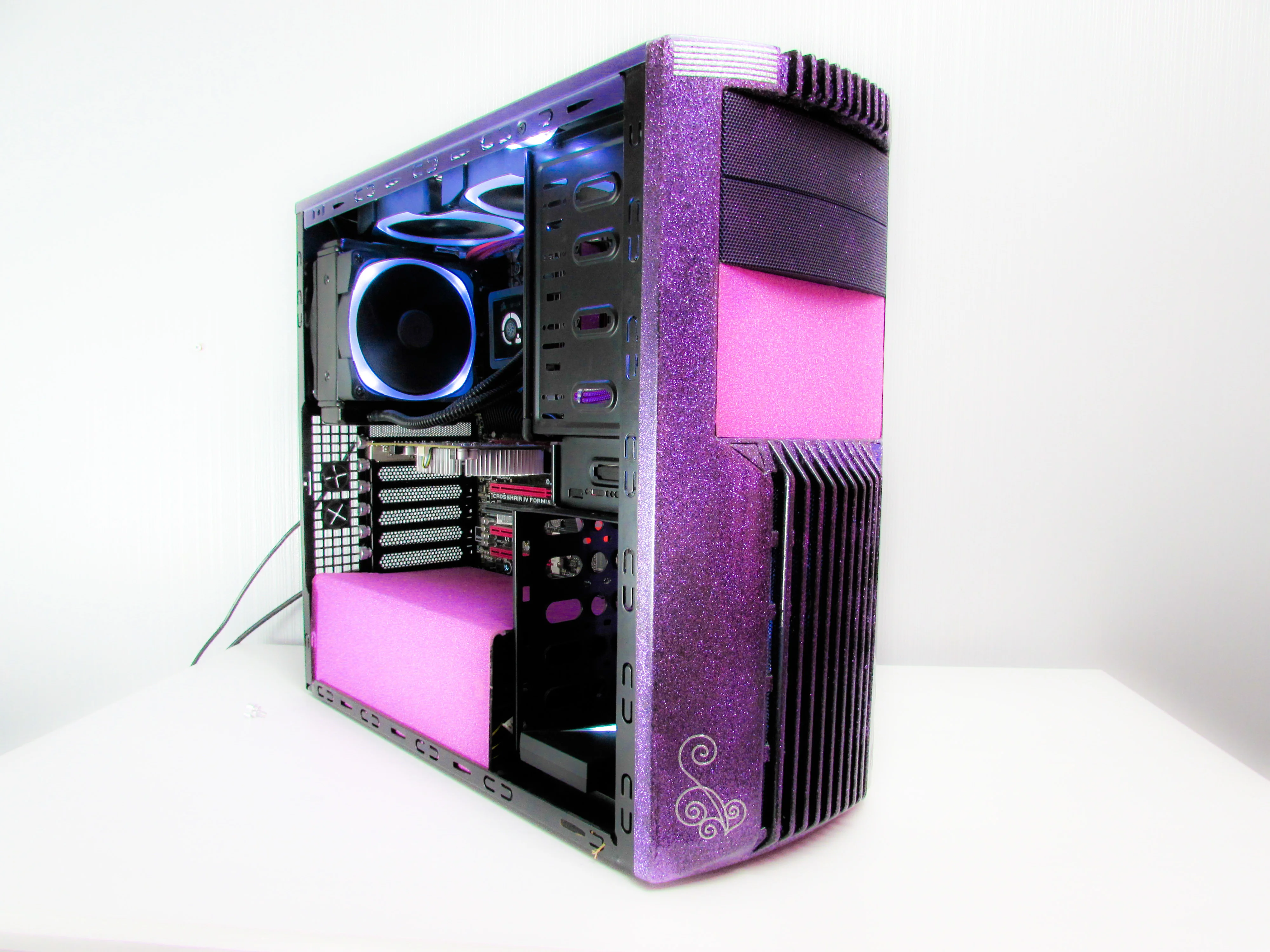

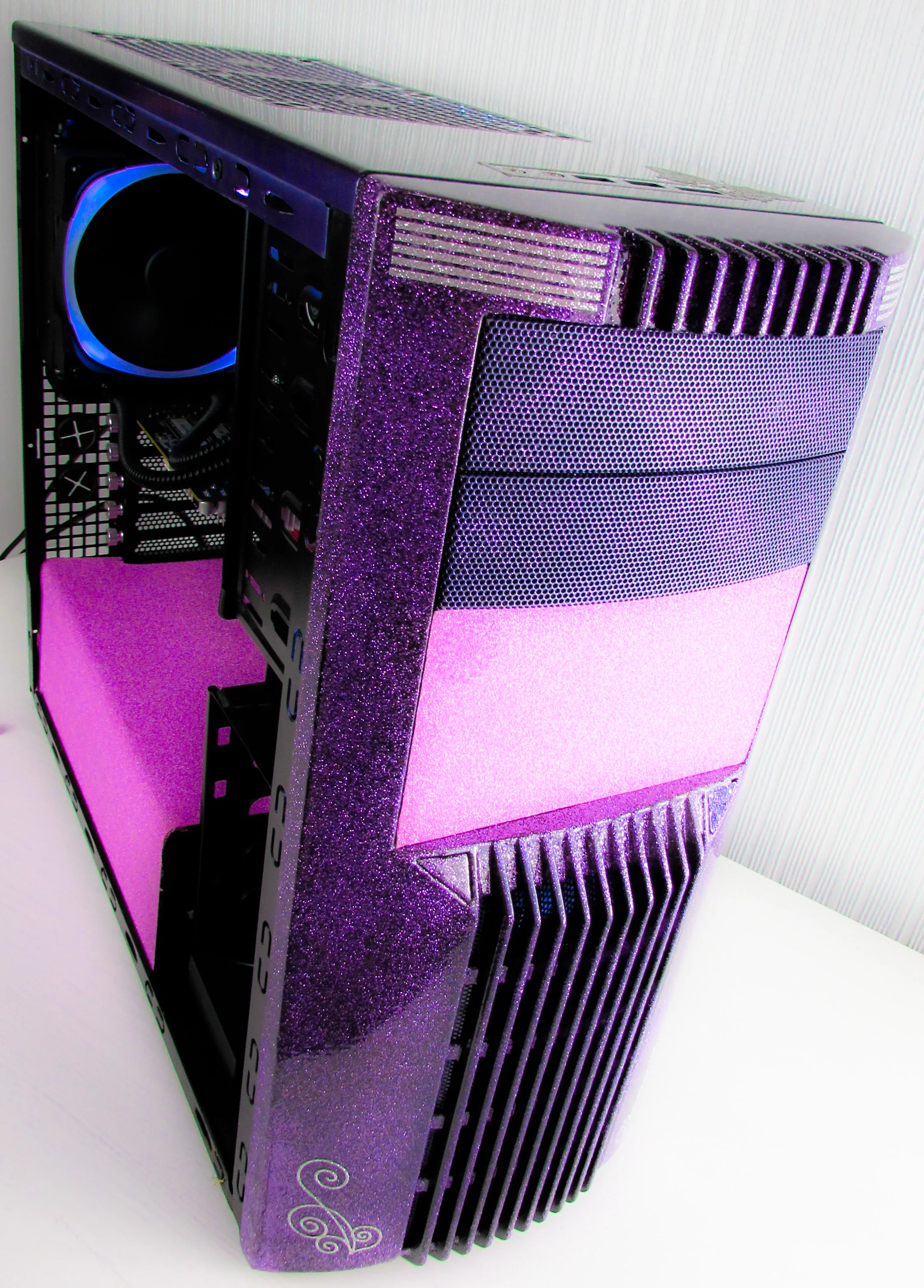

Here we go some test fitting... And we have a PSU shroud!
The pink in the front may be changed to purple acrylic mirror but right now this will fit.

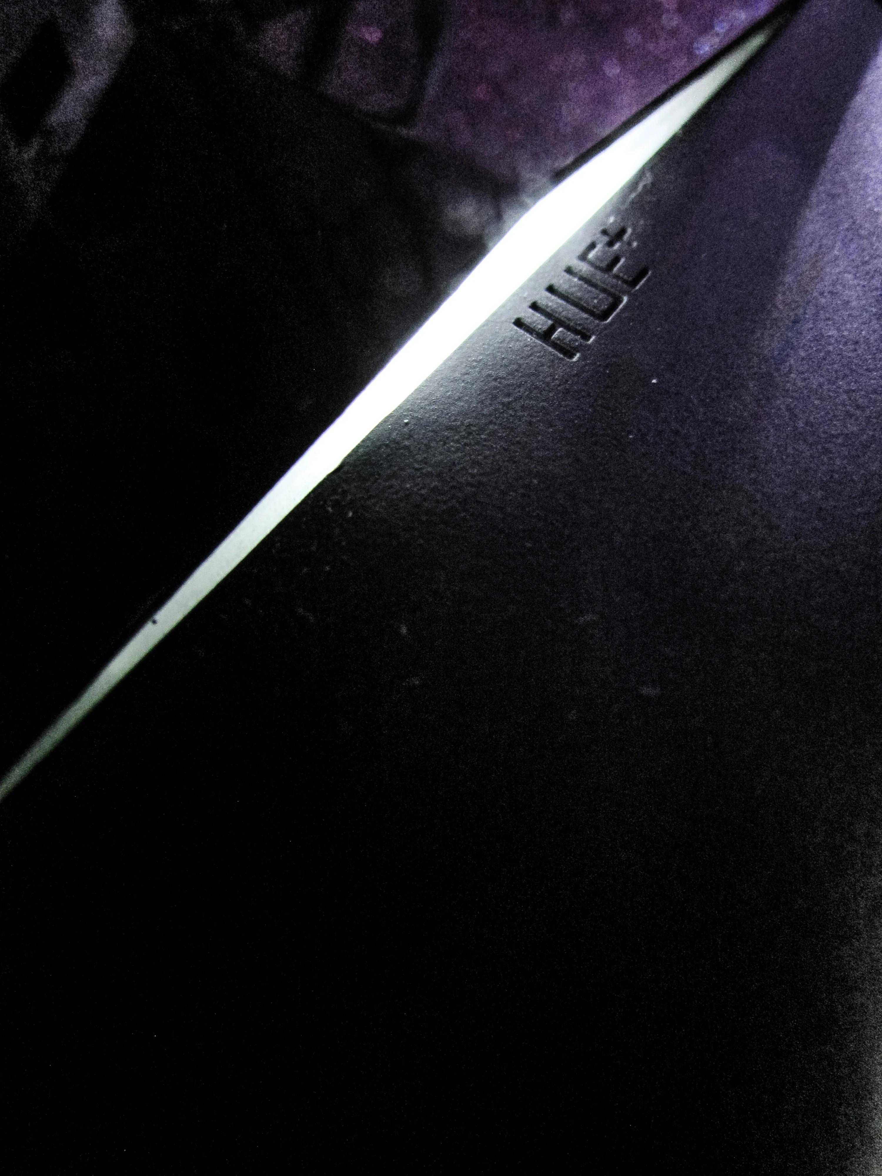

The build is somewhat behind schedule by a fair bit now, my daughters birthday has passed but she has yet to see the whole thing put together despite that it was suppose to be a birthday present so as I type this I am still hopeful that she will be blown away by the build. The delay mainly is because I am waiting for the custom cables but I am hoping that won't be too long now, I got the NZXT Hue+ and AER's just today so not had time to fit them, as mentioned I will update the log when things get done this end. :)

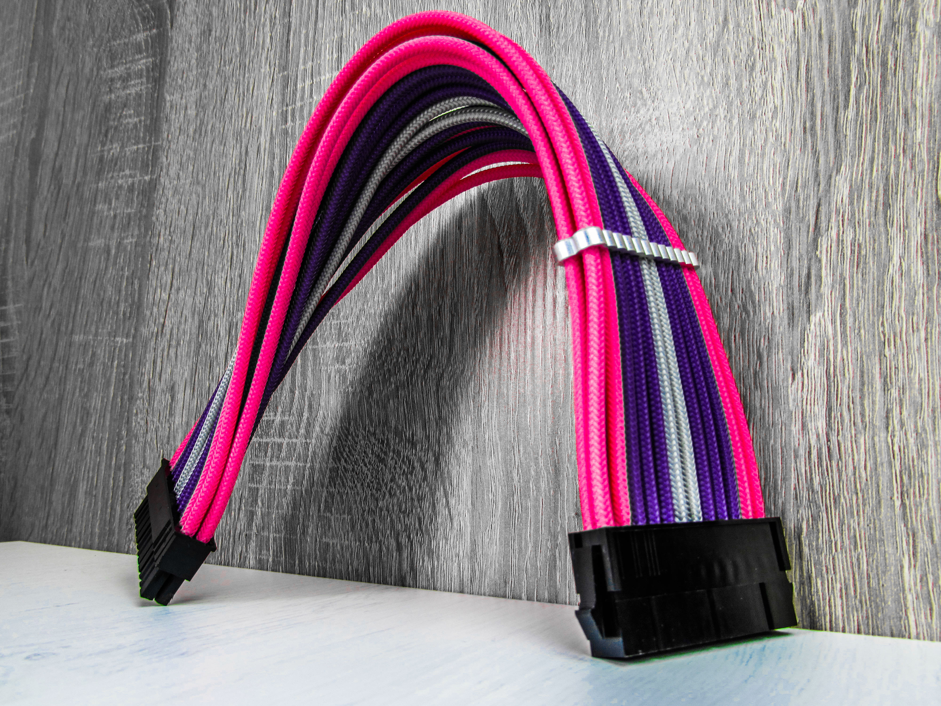

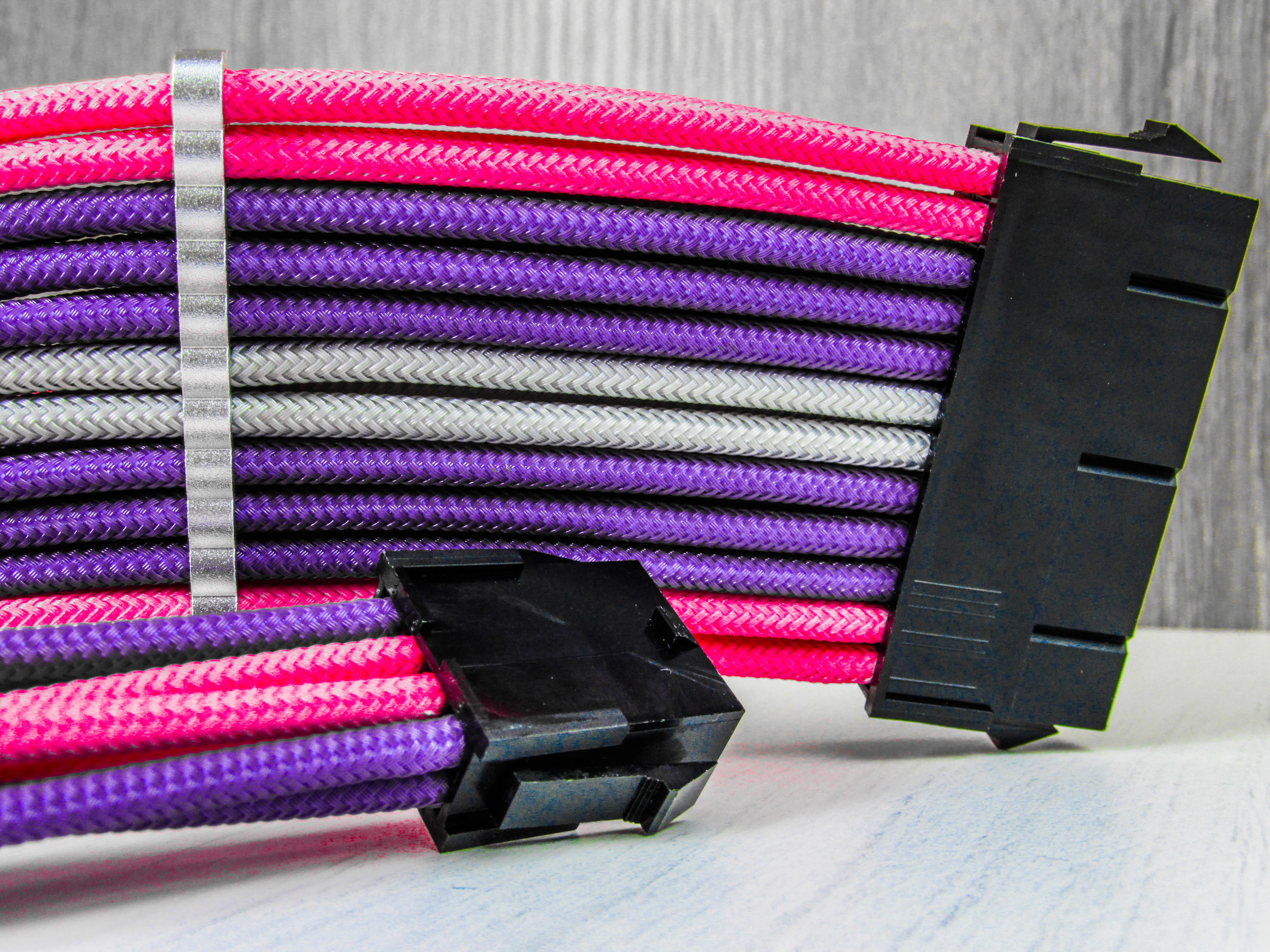

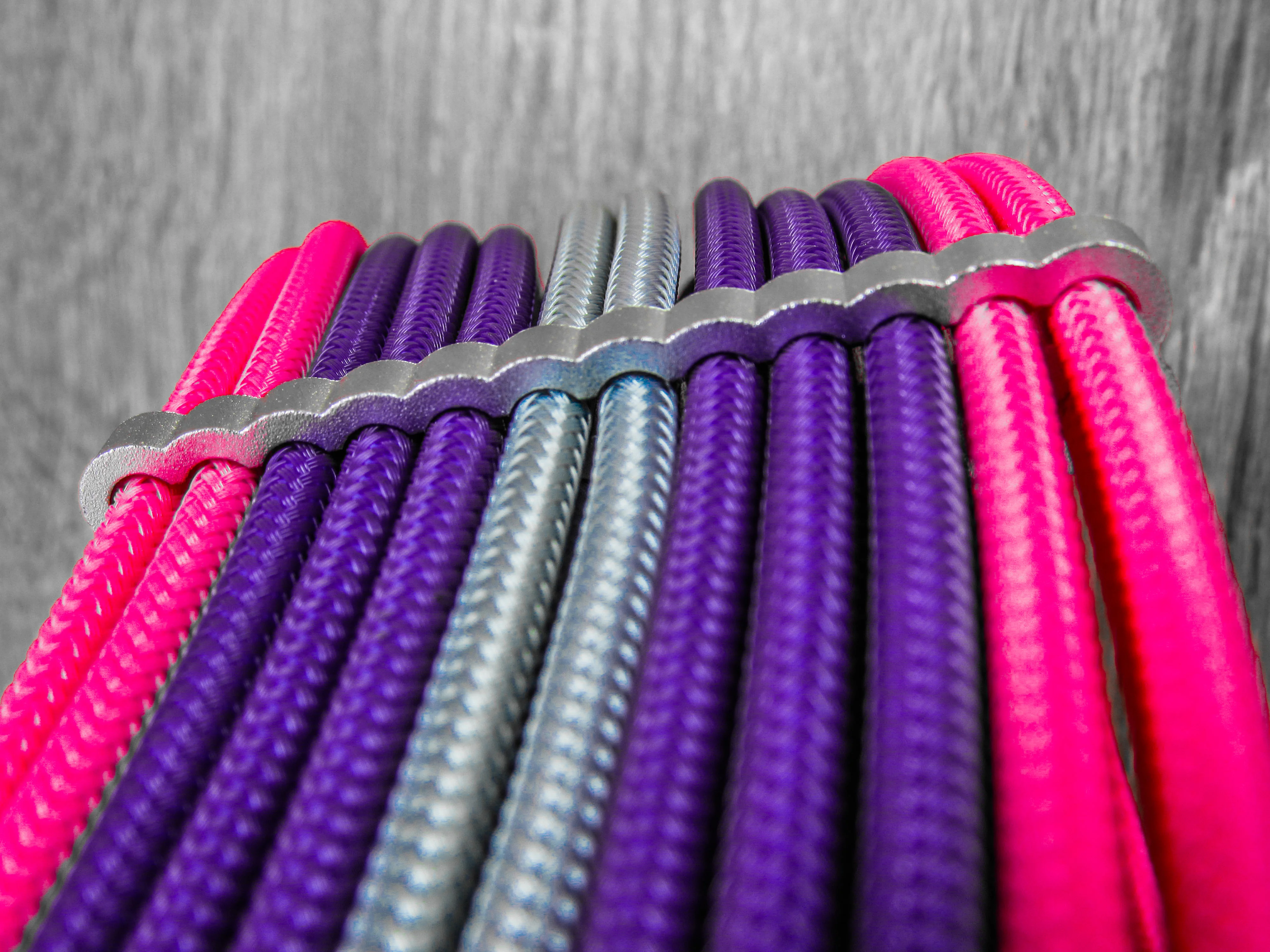

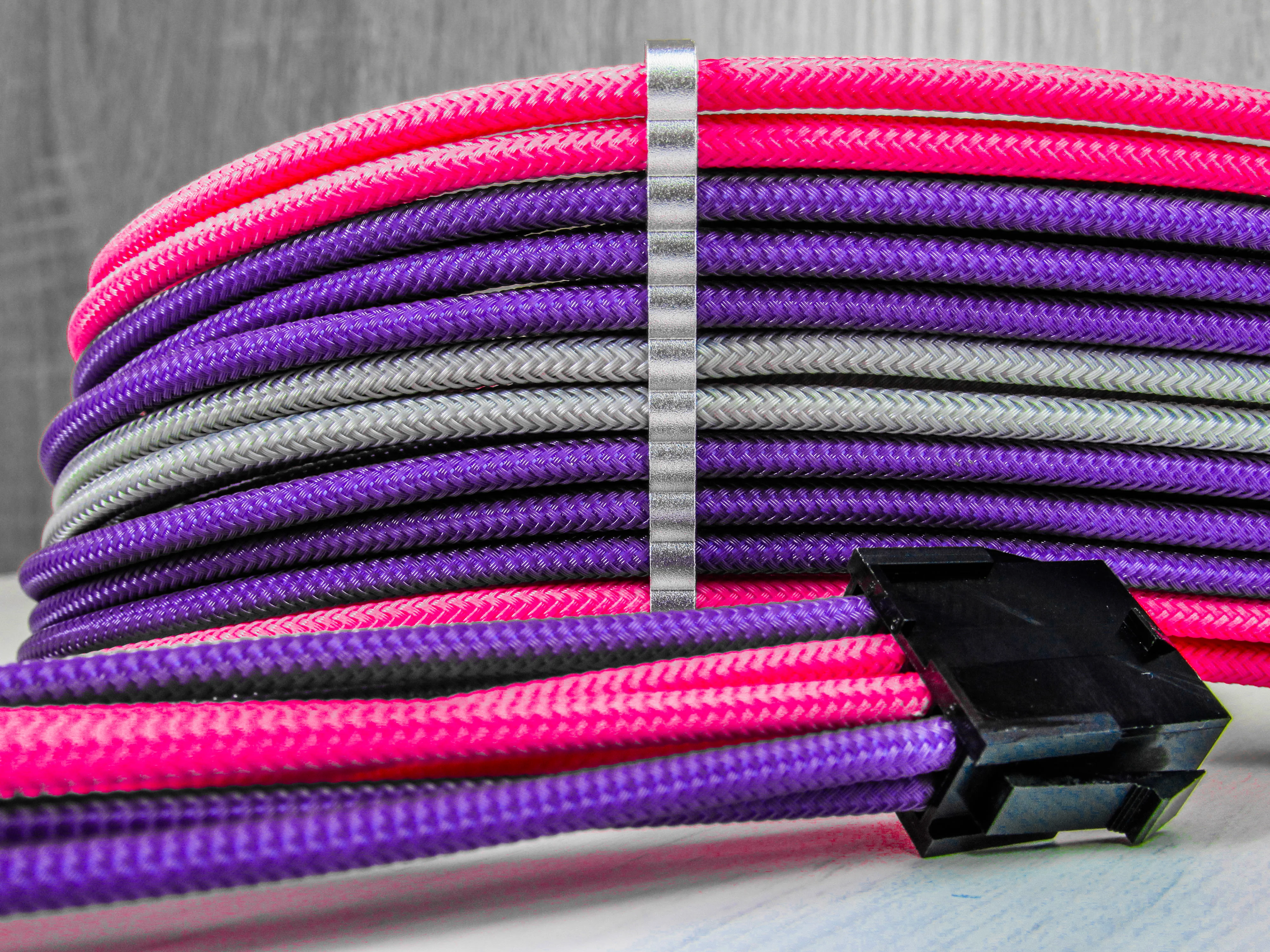

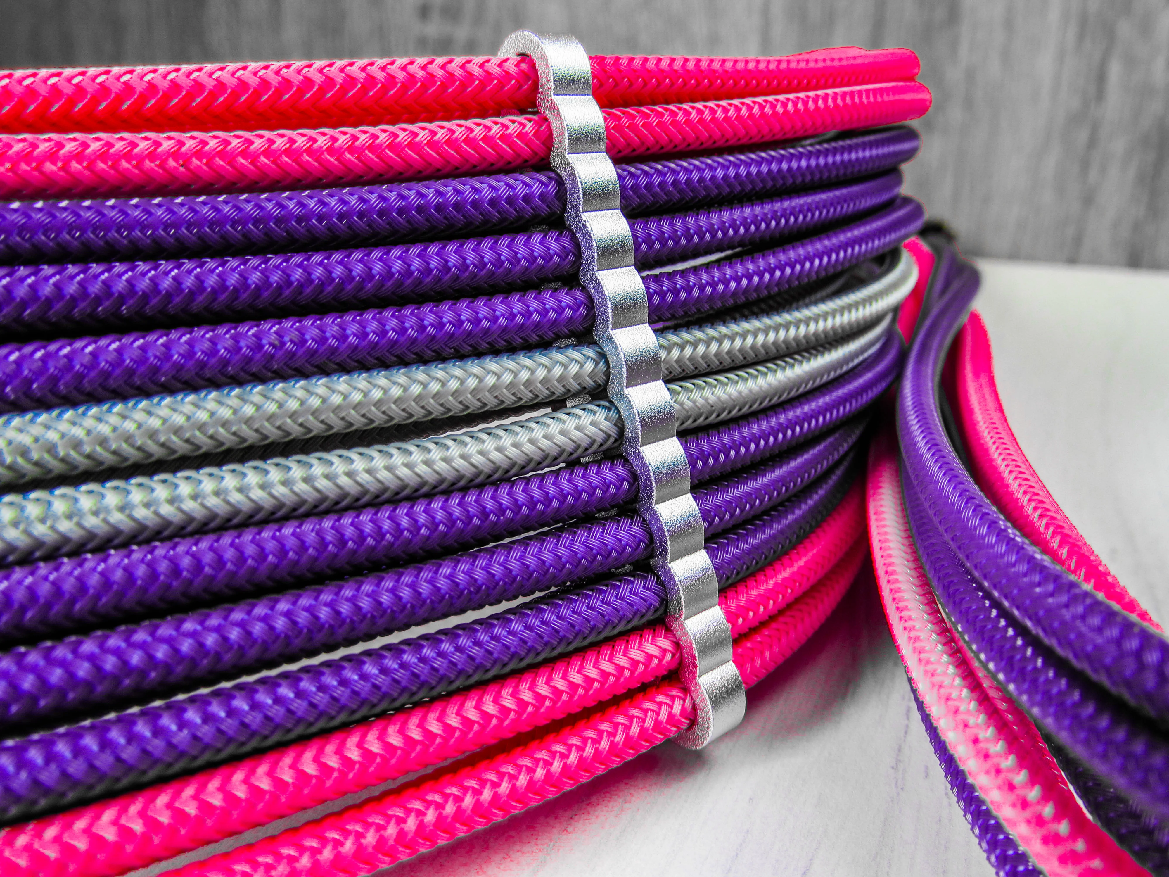

Nice choice in cable layout :p
Cablemod ?
Thanks, but you know I can't take the credit for them haha, the other design would have worked well but the women in my life had made their voices heard and this design won. :o
But yes, of course that will be CableMod, wouldn't want anything else.
Who doesn't want some purple glitter with silver accenting in their life?
Just make sure it's pure white LEDs inside to properly shine the colour.

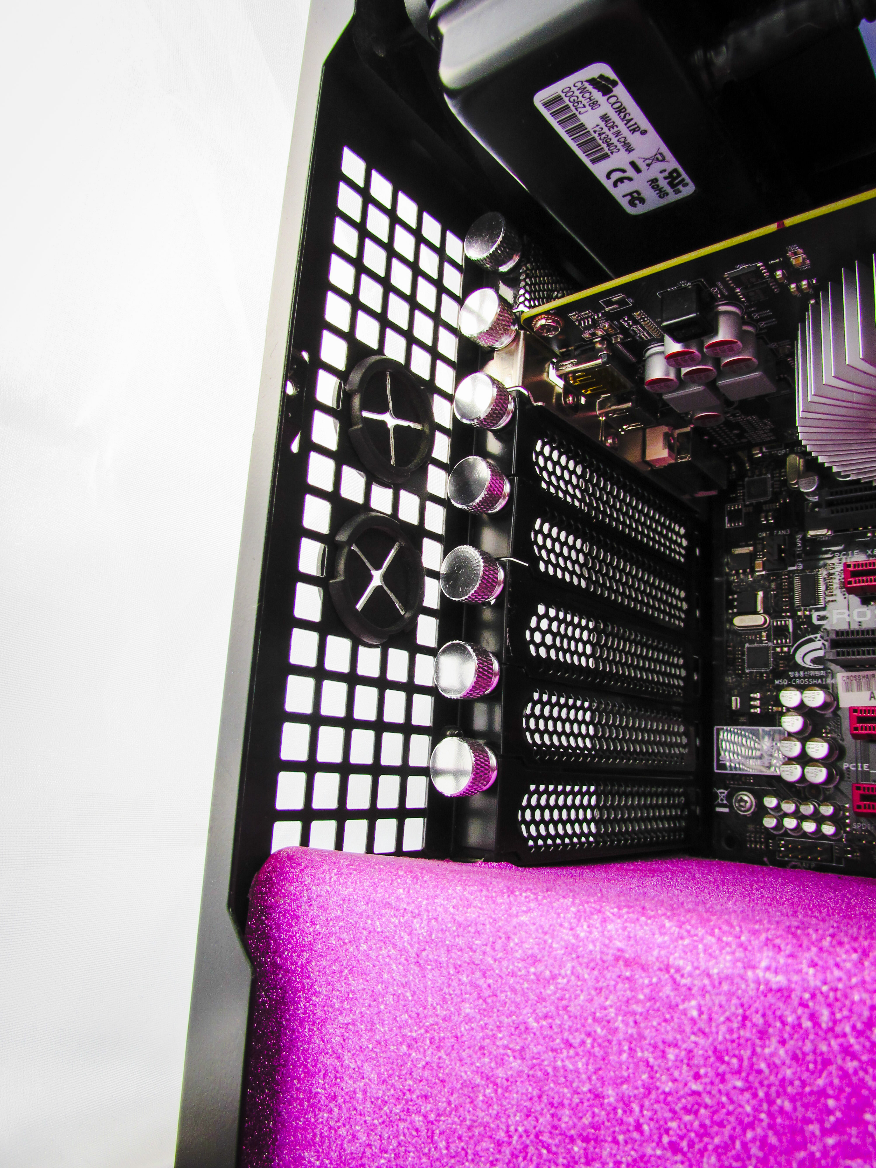

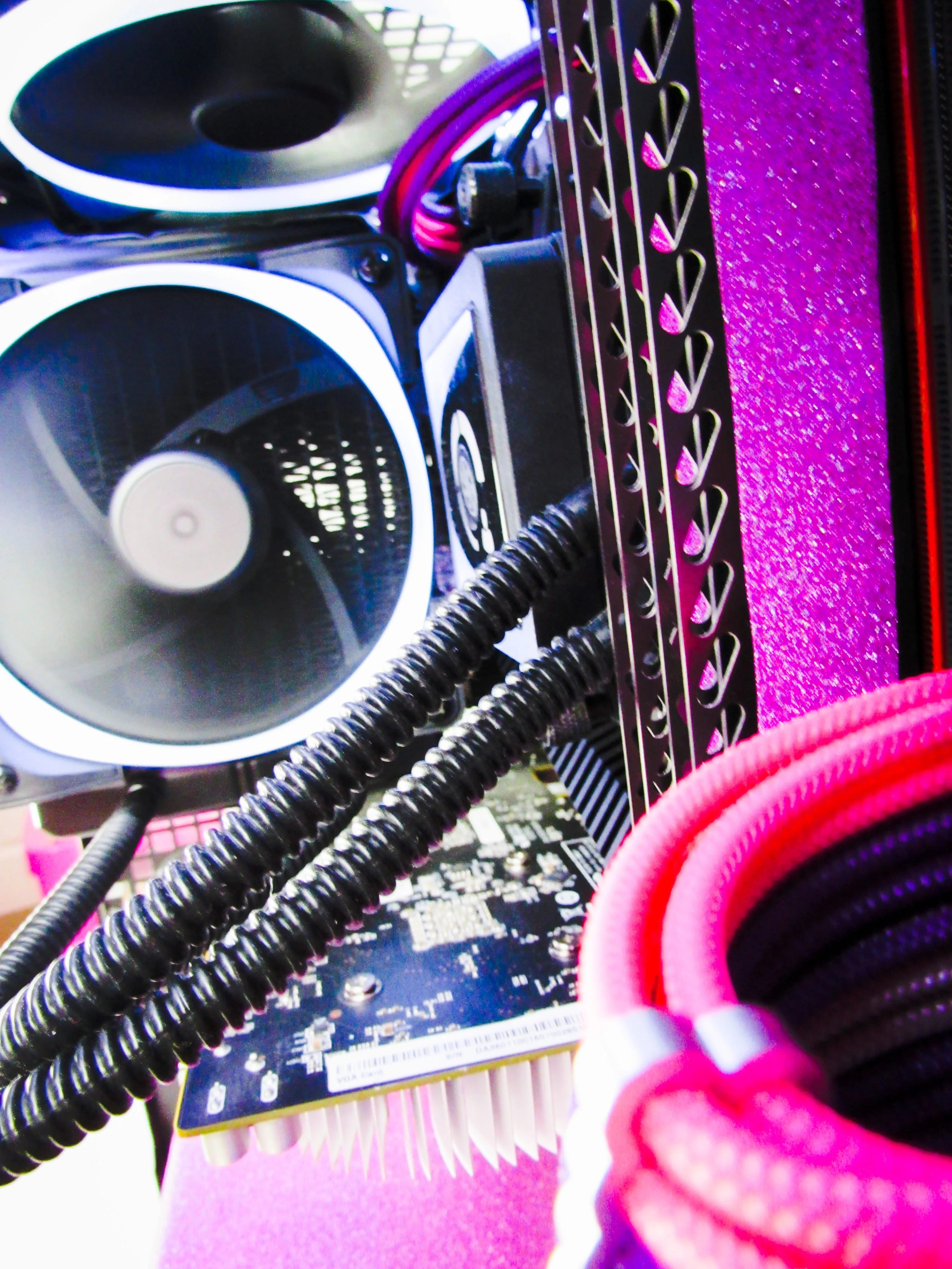

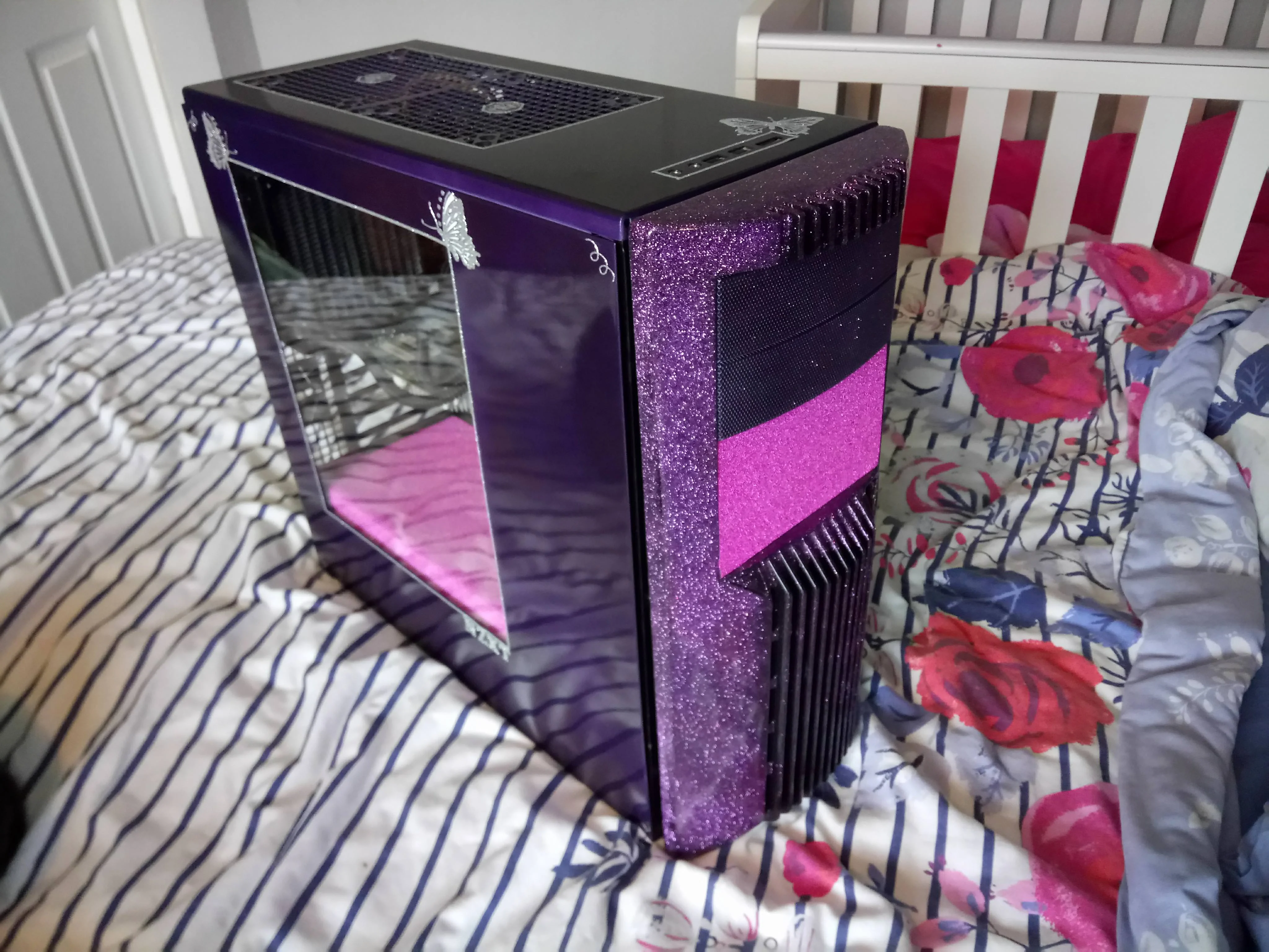

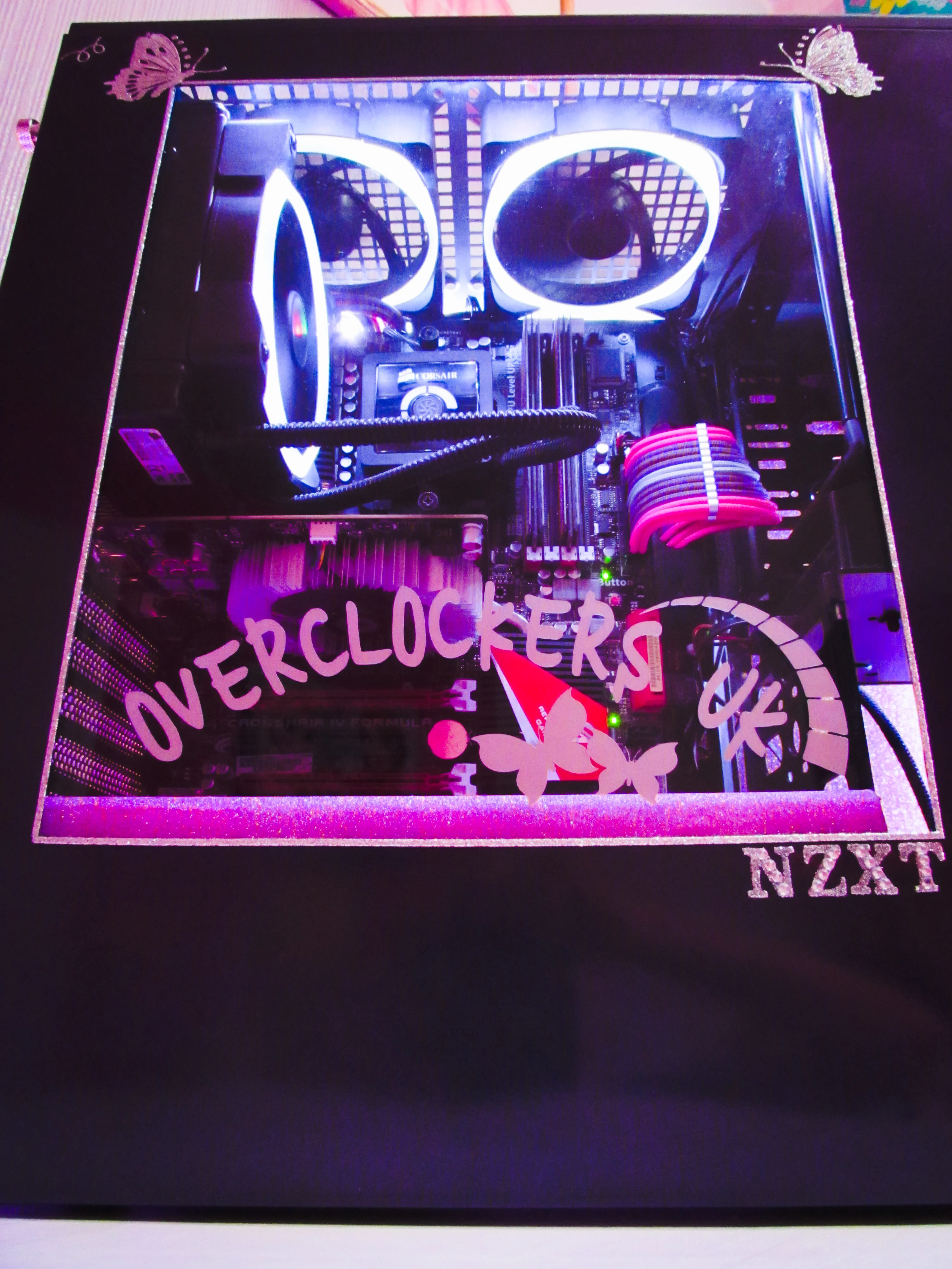

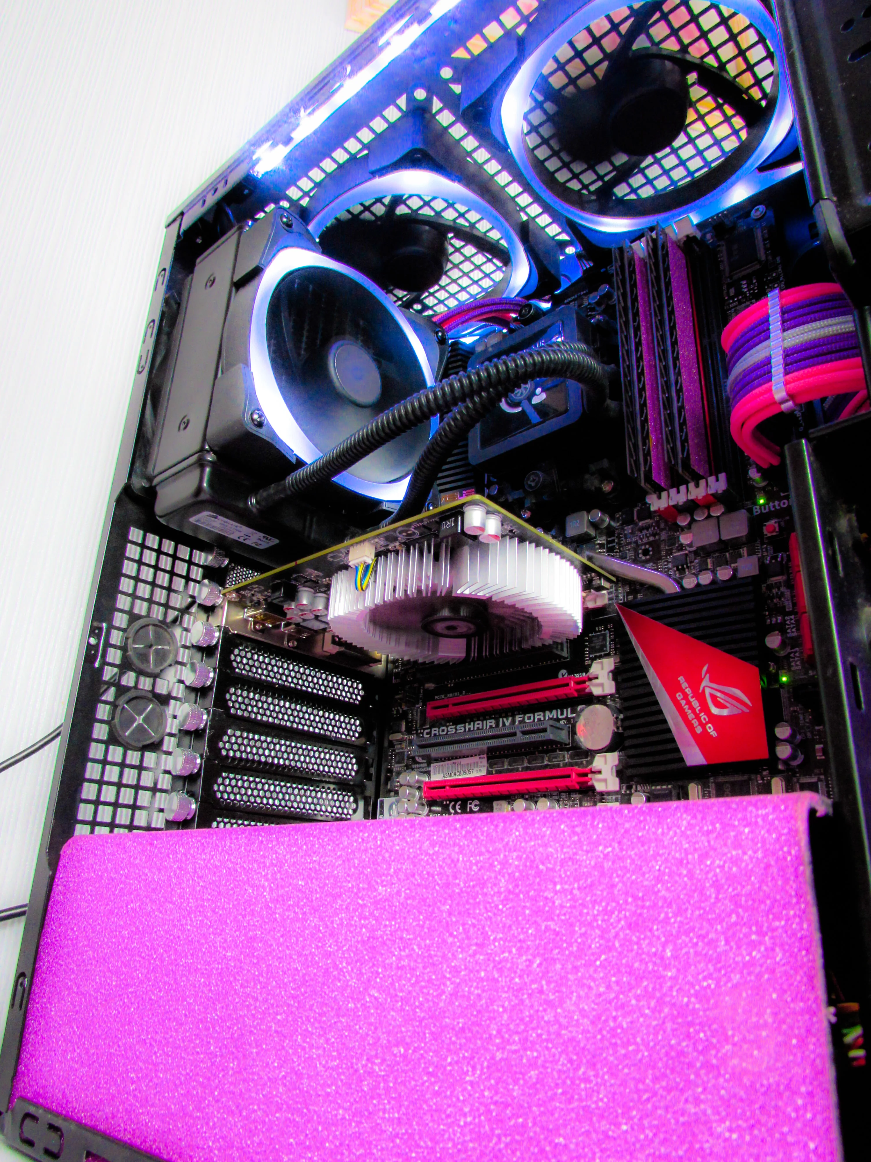

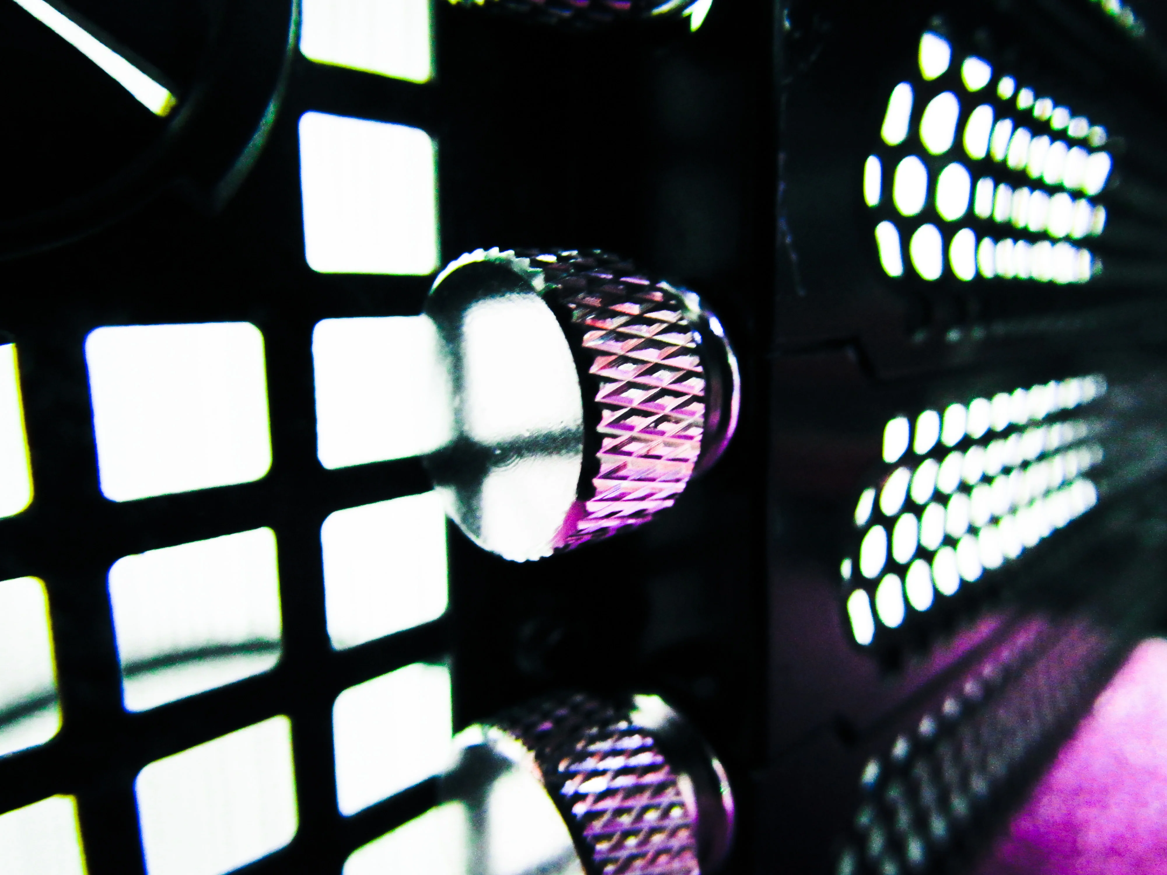

Some goodies came today for the build! Just waiting on one more thing to arrive and a few finishing touches then we should be completed! <3

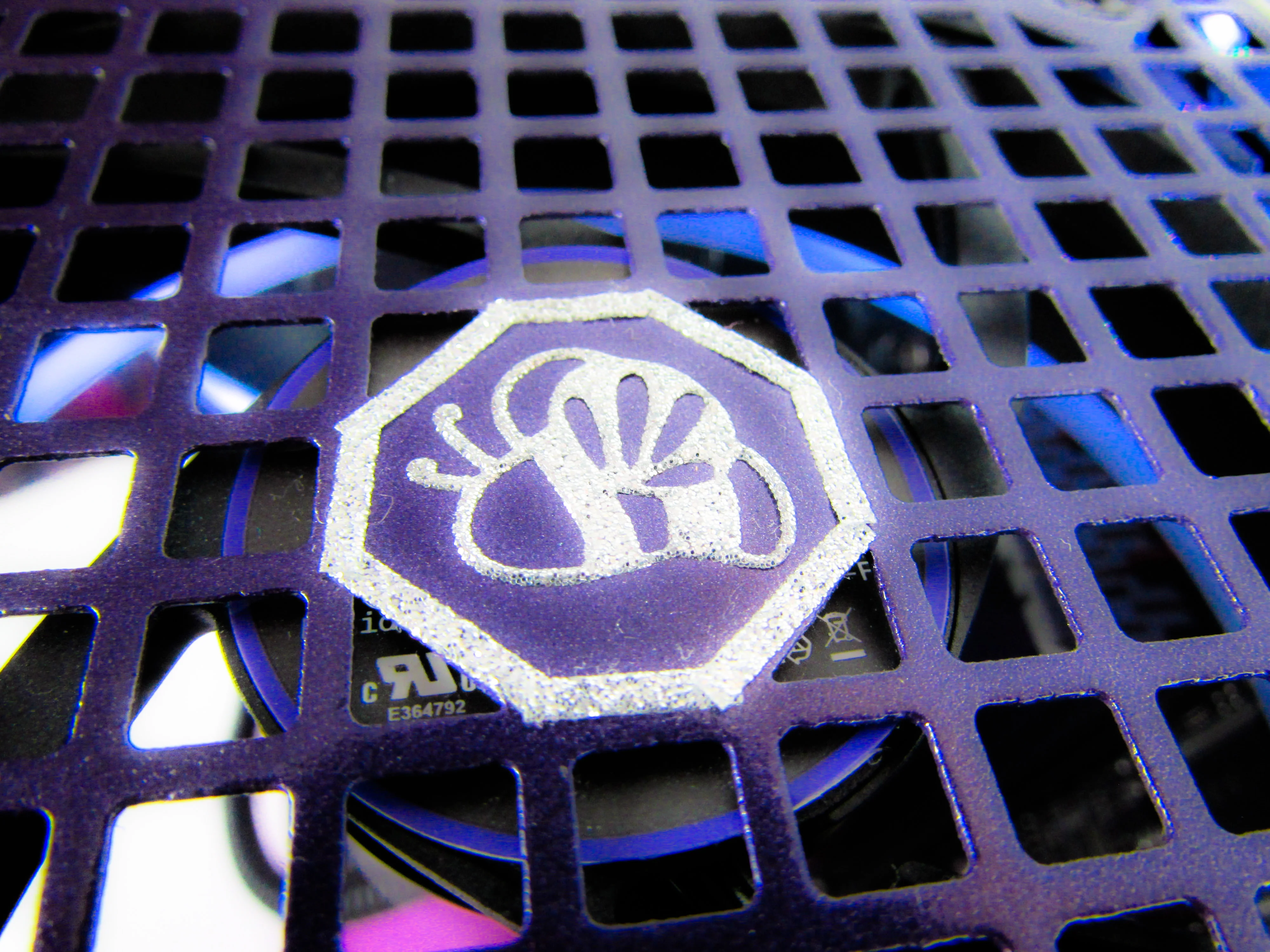

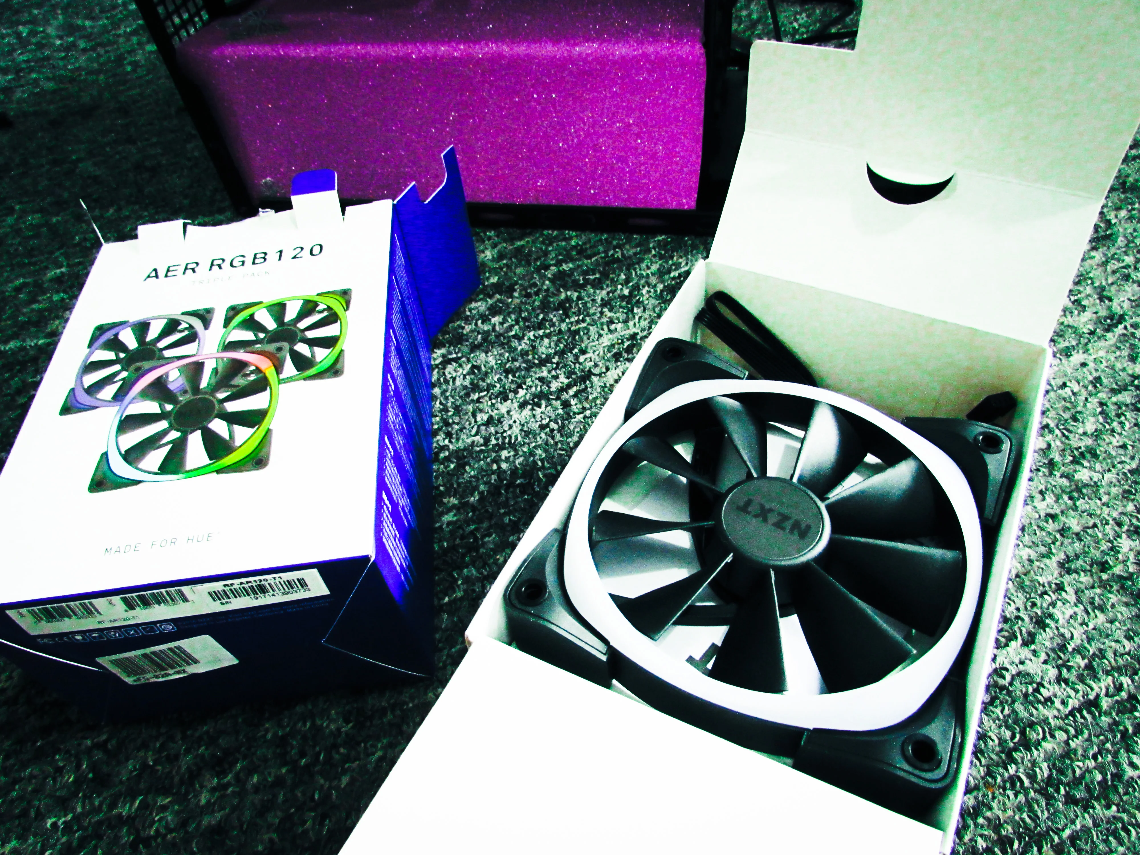

Seems I forgot to include a photo of the fans I've got for the rig, in all honesty they are the perfect fit for the rig! So so happy I got these! <3

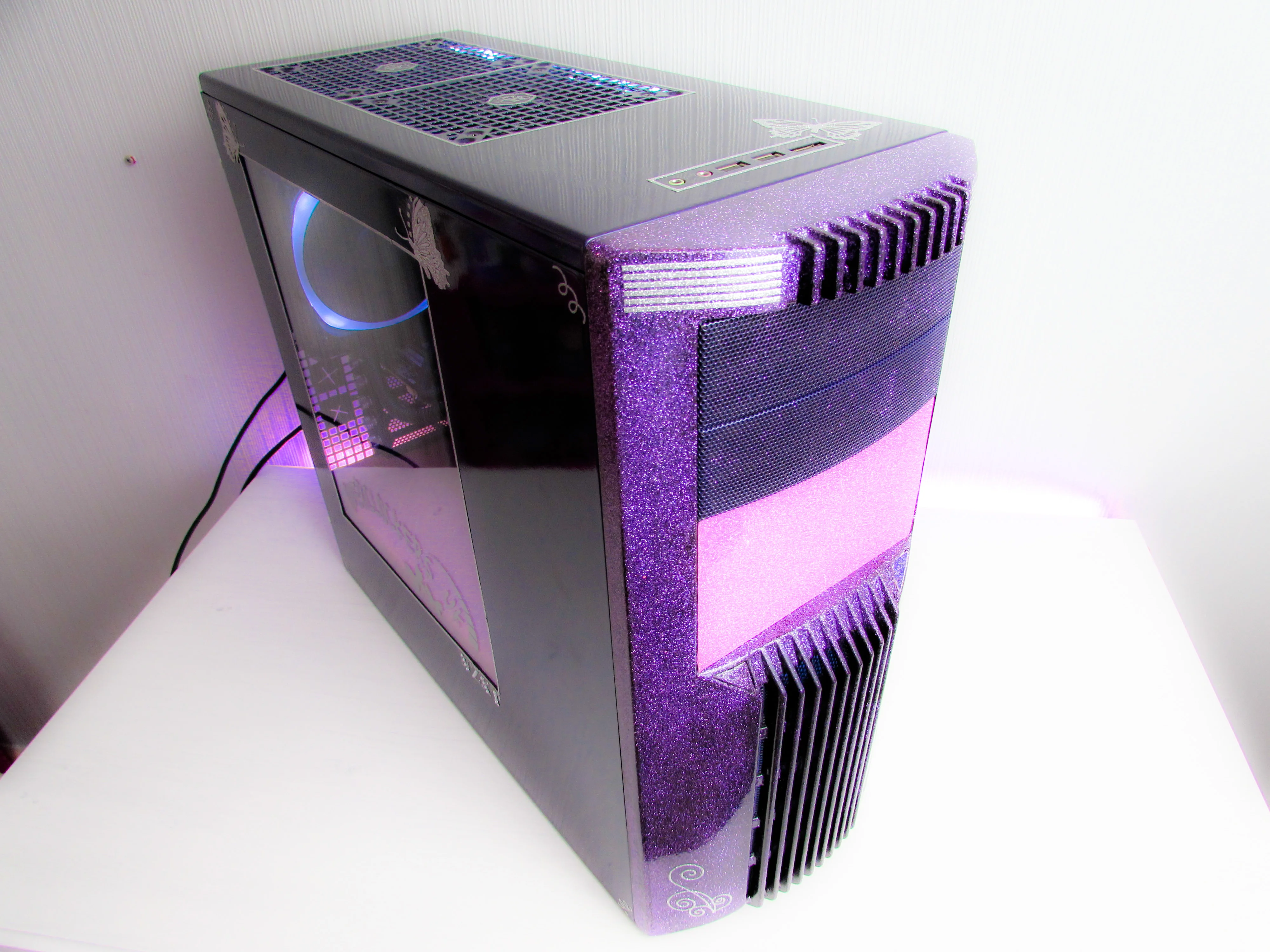

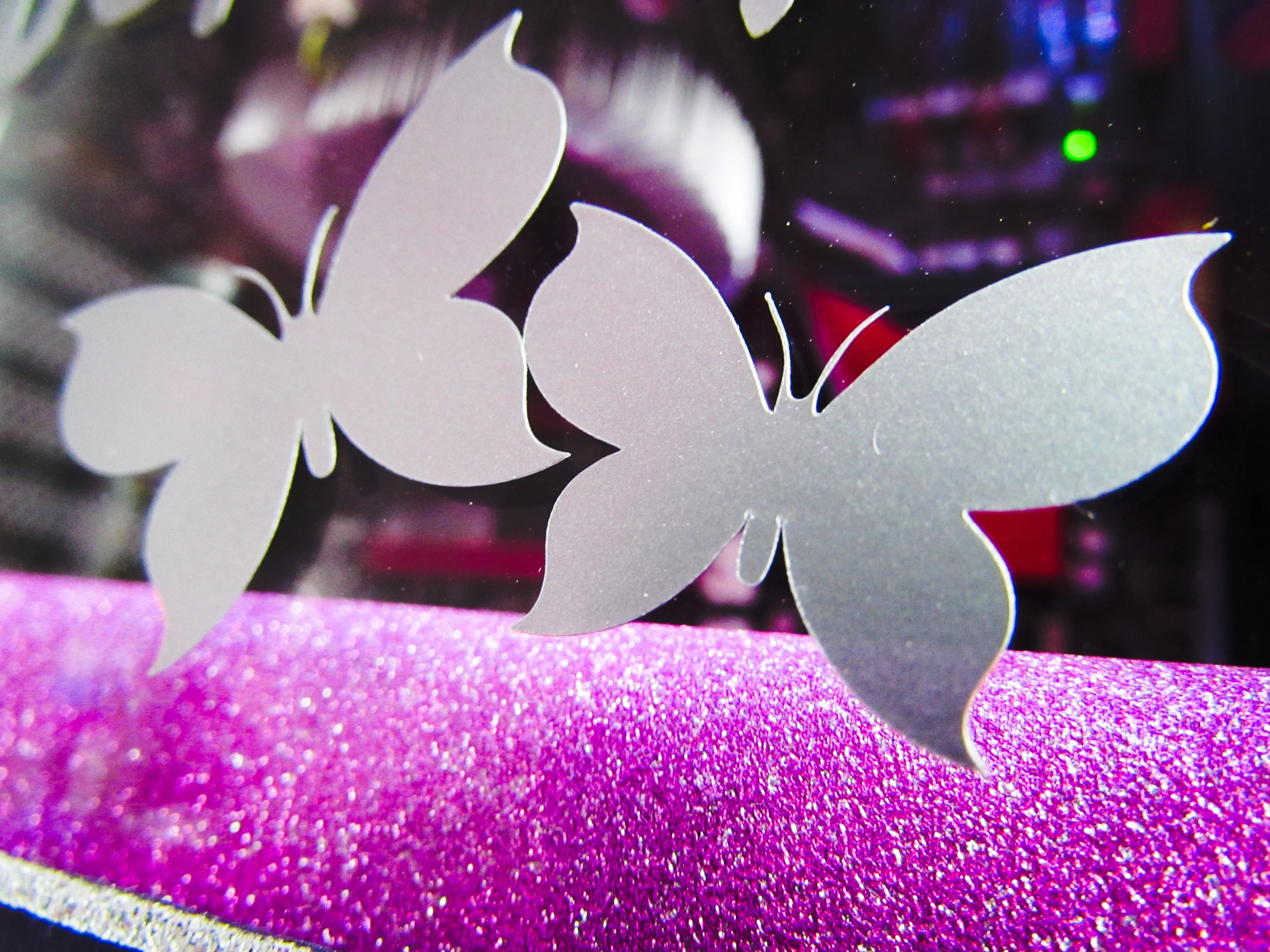

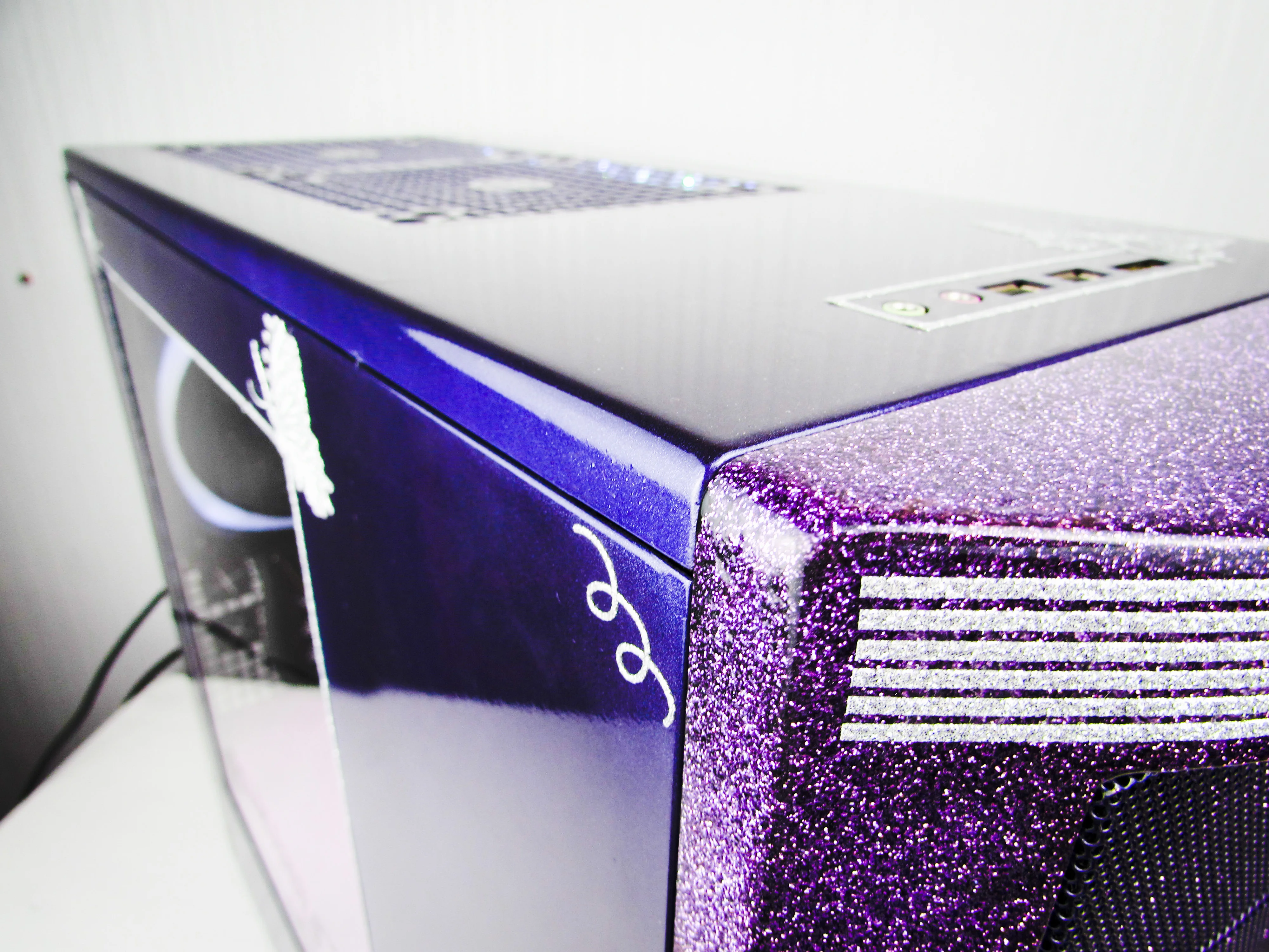

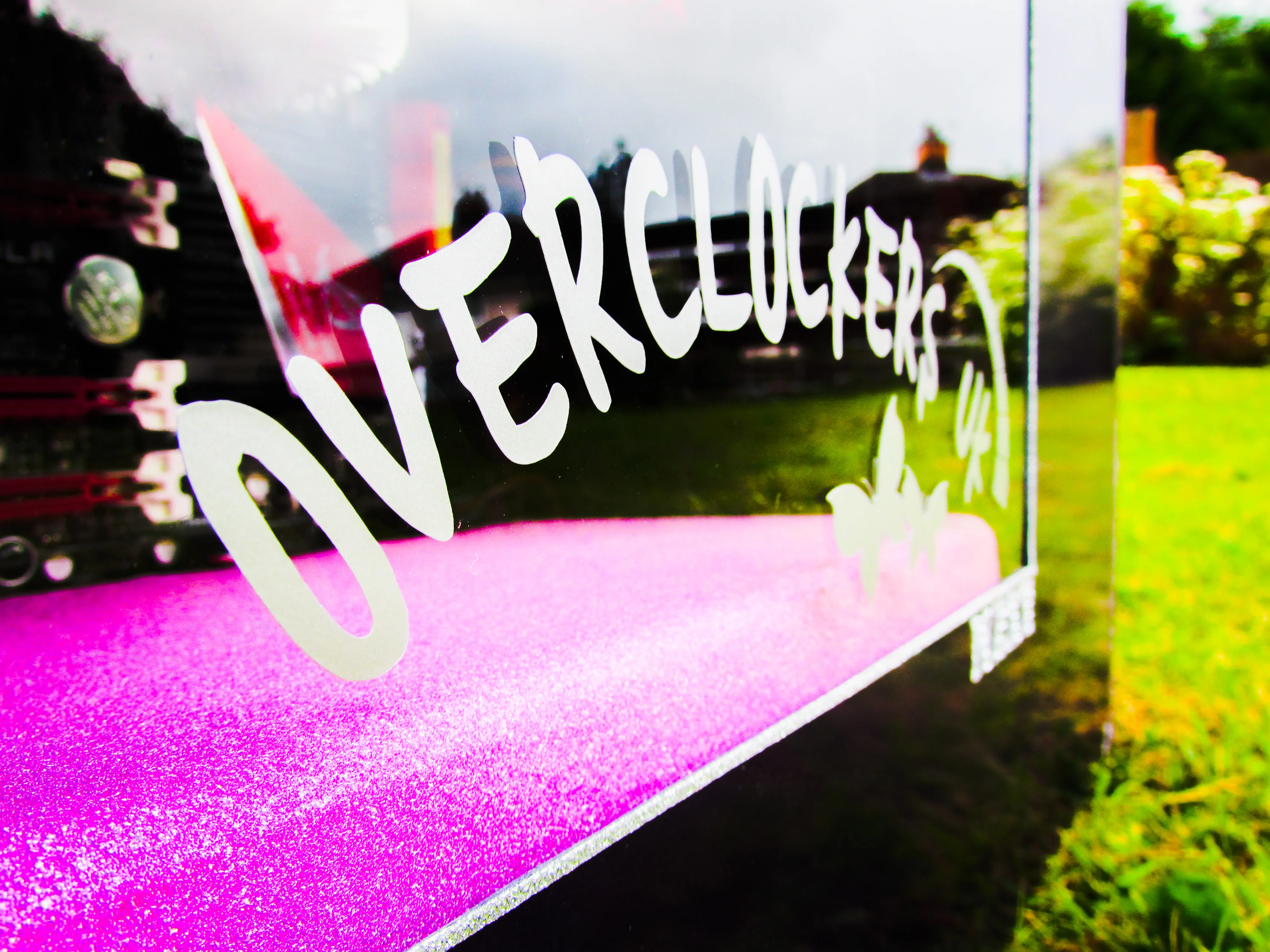

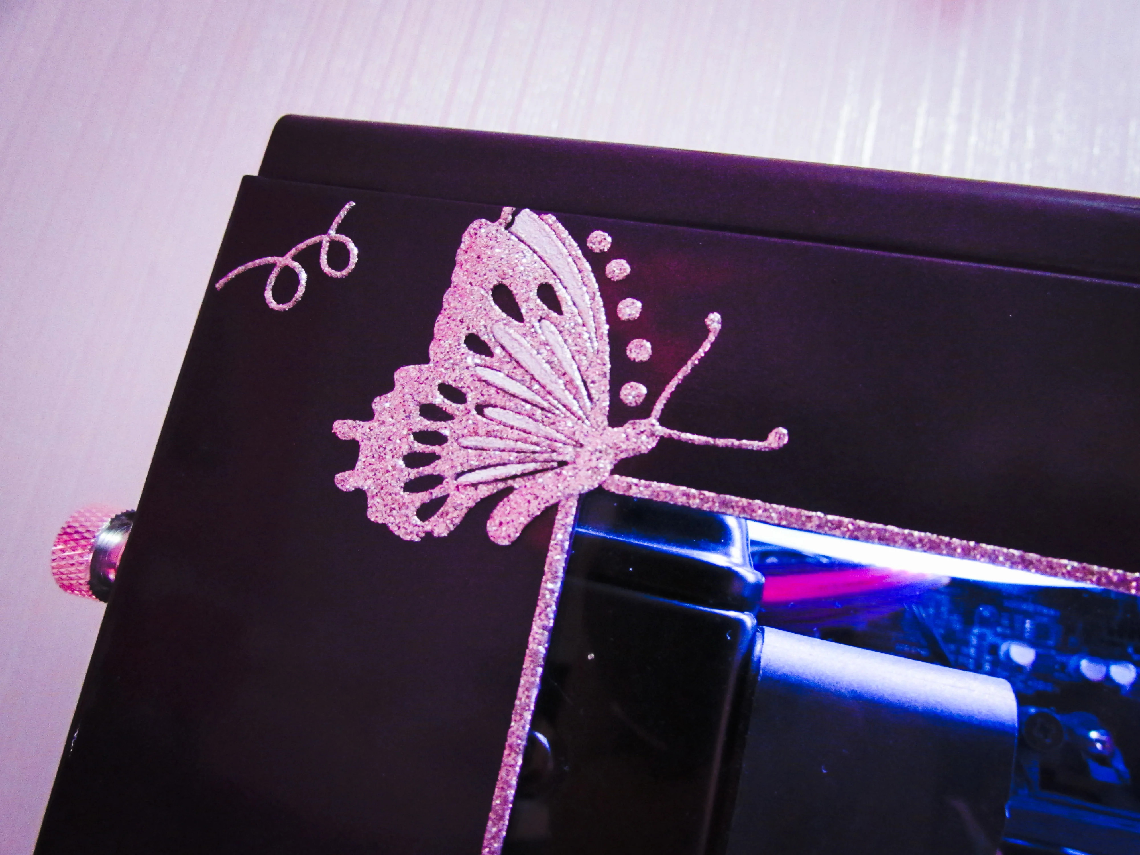

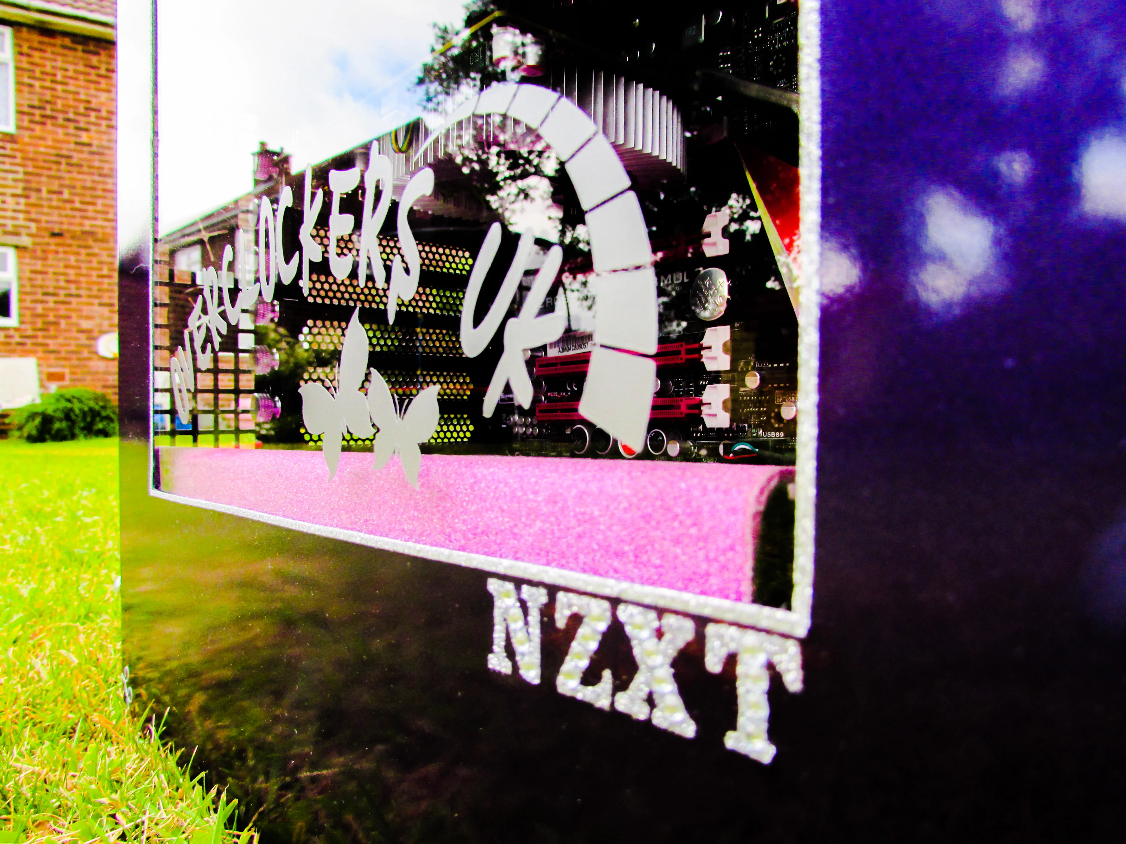

Alright so this is long over due and I'm sorry about the delay. In the end I'm happy to of waited and super happy with what the printer guy produced for the project! This does now at least mean I can get the rig finished over the weekend and wait for the right weather for a small photo sesson to finalize the build.
Sneak peak :P

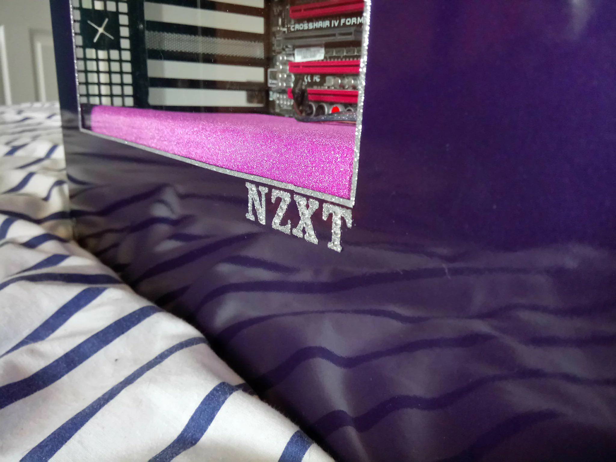

Final photos to follow tomorrow as it's raining and there isn't much I can do about that. :(
