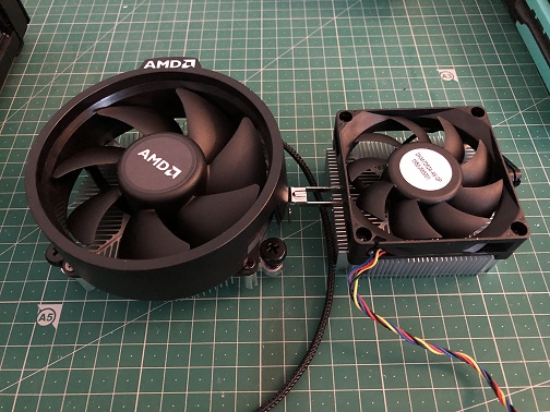

I found the stock lower end AMD heatsink & fan to be noisy so swapped it out with my spare Ryzen one. The fan is way bigger and it is noticeably quiet
Now installed with the Ryzen cooler. I still found this too loud, its a cheap fan I think, so bought a Noctua cooler. It quite a bit bigger and although the fan size is the same as before, its silent.

HTPC Windows idle 20w (32c stock Athlon cooler 1200rpm, 31c Ryzen cooler 900rpm, 30c Noctua cooler 900rpm)
HTPC max load 63w (53c stock Athlon cooler 2500rpm, 50c Ryzen cooler 1500rpm, 48c Noctua cooler 1500rpm)
