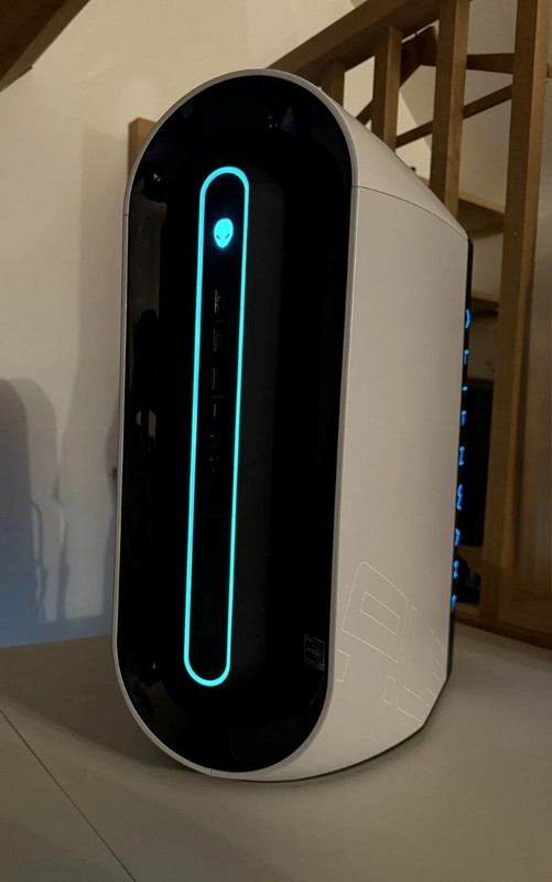

Project Irony "Glutton For Punishment".
OK so there may be a part two to today, we will see. First up I made sure the RGB things I bought would fit. They would not, then I peeled off the useless magnets. Then they fit.
Test on the case. I will glue them to the chassis.
OK so that is mostly done. I won't know if I need to diffuse them until I test them. So then it was onto the front.

I also found something earlier (details later) that basically makes the light boxes absolutely pointless. And it was free to boot :D And you will get a good chuckle out of it too lmao. What would a mod be without some "junk modding"? :D
OK solder, bugger two up, do them again etc etc. One looks dim because Starry Night.
So what was this terribly clever idea I had? well, yesterday when I was making a coffee I noticed these things. Asked mum what they were and after showing her one she said "Stainless steel straws..... That I never used".
And what would you know, if you shove the LED in (nice push fit)
You get your joiner come light boxes free, with just some cutting.
OK, so there was a round three. I'm telling you, getting that middle piece out was among the most terrifying things I have ever done. It's glued in. The gap to get the pick in is tight AF and it makes snapping cracking sounds as you go. It's out though, thank god. The pipes are more like 3mm, so the straws are not needed. I will just use the shrink I bought with adhesive in. It is much stiffer than regular shrink.
I also made a discovery with the plate that goes in there. See, in all the pics you see this, right.
Note how there are two lots of light there. The thin area with the pipes in and the ones showing through some sort of honeycomb. Thing is, whenever I look at these PCs I all I seem to see is this.
So I had come to the conclusion that it was a render, and fake. IE those lights did not exist. Well oddly they do. There is a sort of baffle there with the honeycomb pattern on and there were lights in it. Obs I have removed them all now but yeah. So, I have redesigned it so I can use my neons.
