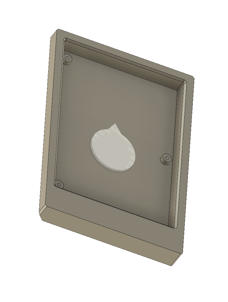

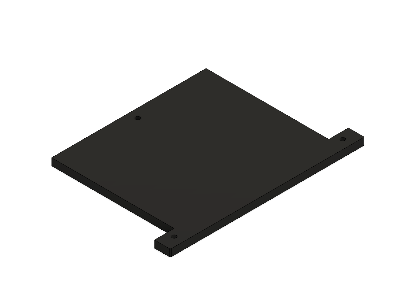

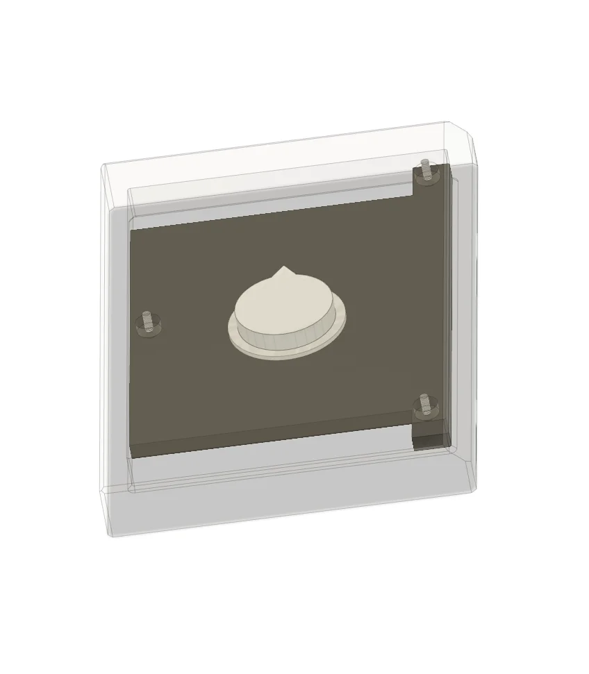

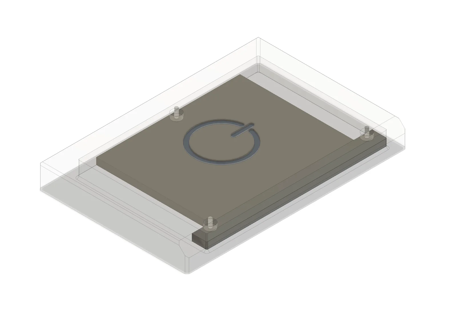

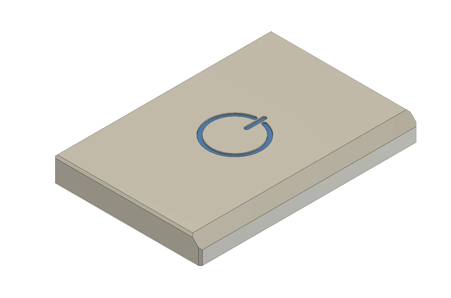

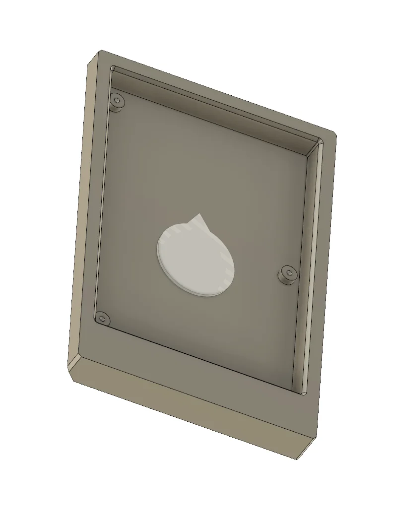

5. Custom NVlink bridge now started/designed, see below - this is to fit the insides of the NV standard bridge, the logo is TBC its just a bit of a meme which I was about to write RTX and the power icon :D
Slow and steady wins the race, I think... Designs finalised this morning:
This will likely either be just black acetal with an aluminium/metal plate OR i'll just get the top bit milled in solid Aluminium, the internal back plate in acrylic pins it to the standoffs. If you are wondering its deliberately offset the be larger at the bottom, what this does is mitigate the offset you get from the natural fit of the link when attached as the bottom SLI fingers are at the top of the card... In short I hope this centres the bridge over both cards to the eye ;)

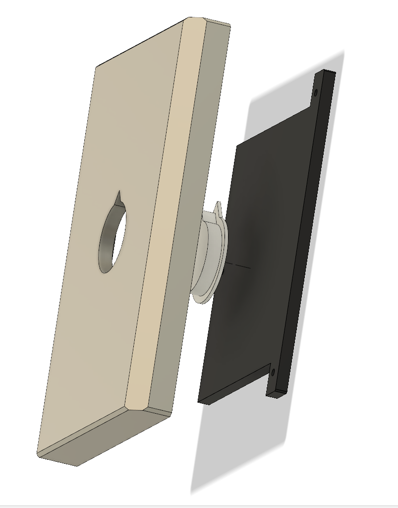

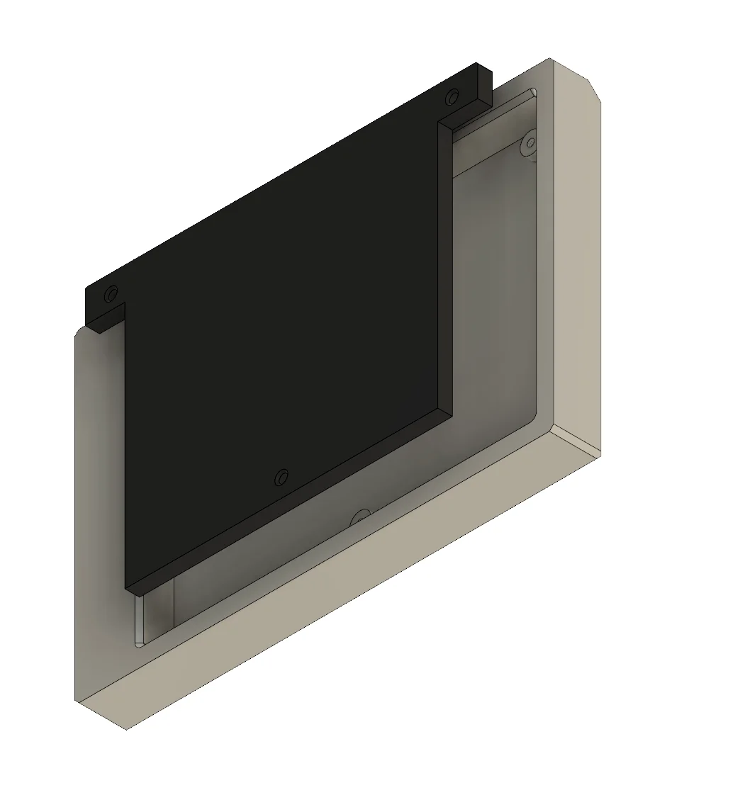

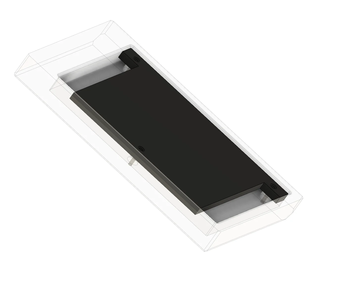

Few more shots of the NVLink bridge which is pretty much done, I've learnt how to translate this to drawings so will have a look at printing a 1:1 and checking my measurements before it gets made ;). The more astute of you will notice I was a weetard and had the bridge the wrong orientation so corrected that and added a simple logo in the centre, this will be frosted clear acrylic and lines up to the existing LED panel in the bridge so I can still RGB all the things.

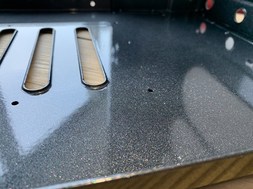

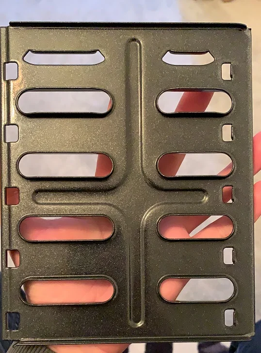

Now, its time to GET HYPED. Because I just picked up this sample from the multitude of bits left at the powder coaters, basically to confirm I like the finish before we do the whole job... I like. A lot. Difficult to get pictures but the former 1000D stock of matt textured black next to dark grey sparkle with gloss finish. The quality is well worth it vs. painting myself so i'm really glad I went this route - what do you think?
Old left, new right:
Sparkle is difficult to photograph but it looks very tasteful:
And under a strong white light in the bathroom to show the real life colour a little more:

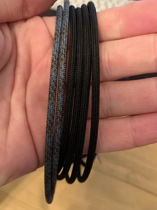

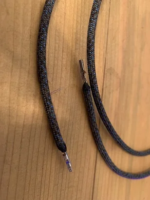

I cant wait to see the rest all coated up! While we are at it the new paracord colours are in, all the way from the USA - a massive thanks to Atwood Rope for not declaring the VAT paid and ignoring all my emails :D. So glad you were there to support me by ignoring all my communications and leaving me with about $20 charges to pay on $22 of rope. It looks good though, will probably be the odd single strand or two next to black matt. I've also been trying melting the ends to secure in place of crimping over the sleeve - works really well so this will be the new method for me, more reliable and no need for sacrificial sleeve as the para melts neatly and sets like rock.
Odd flecks of bright blue, bits of black and matching grey to the case:

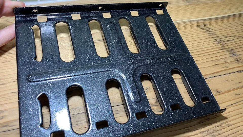

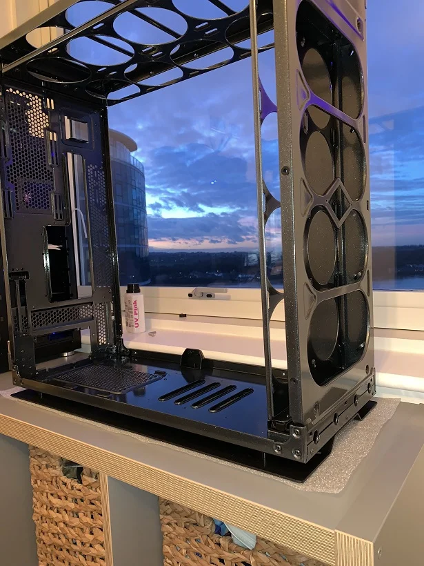

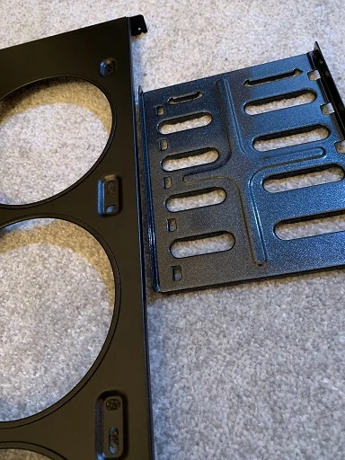

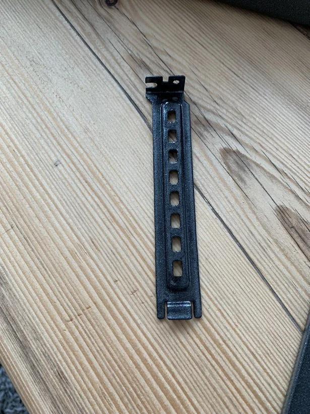

So the case parts (all of the various bits individually) are now powder coated, in the end the special colour was worth a few extra quid in my opinion as it gives a really subtle finish but a few white LEDs will show it sparkle ever so slightly. A few shots of the finish, hard to tell in these photos how different it looks but i've done a quick video also ;)
Yes even all of these coated...

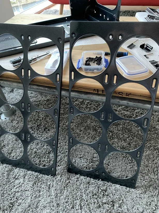

Fan/Rad mounts:
This shot shows the colour reasonably well, i've kept the 'foot' and the top as stock in the nice brushed dark aluminium:

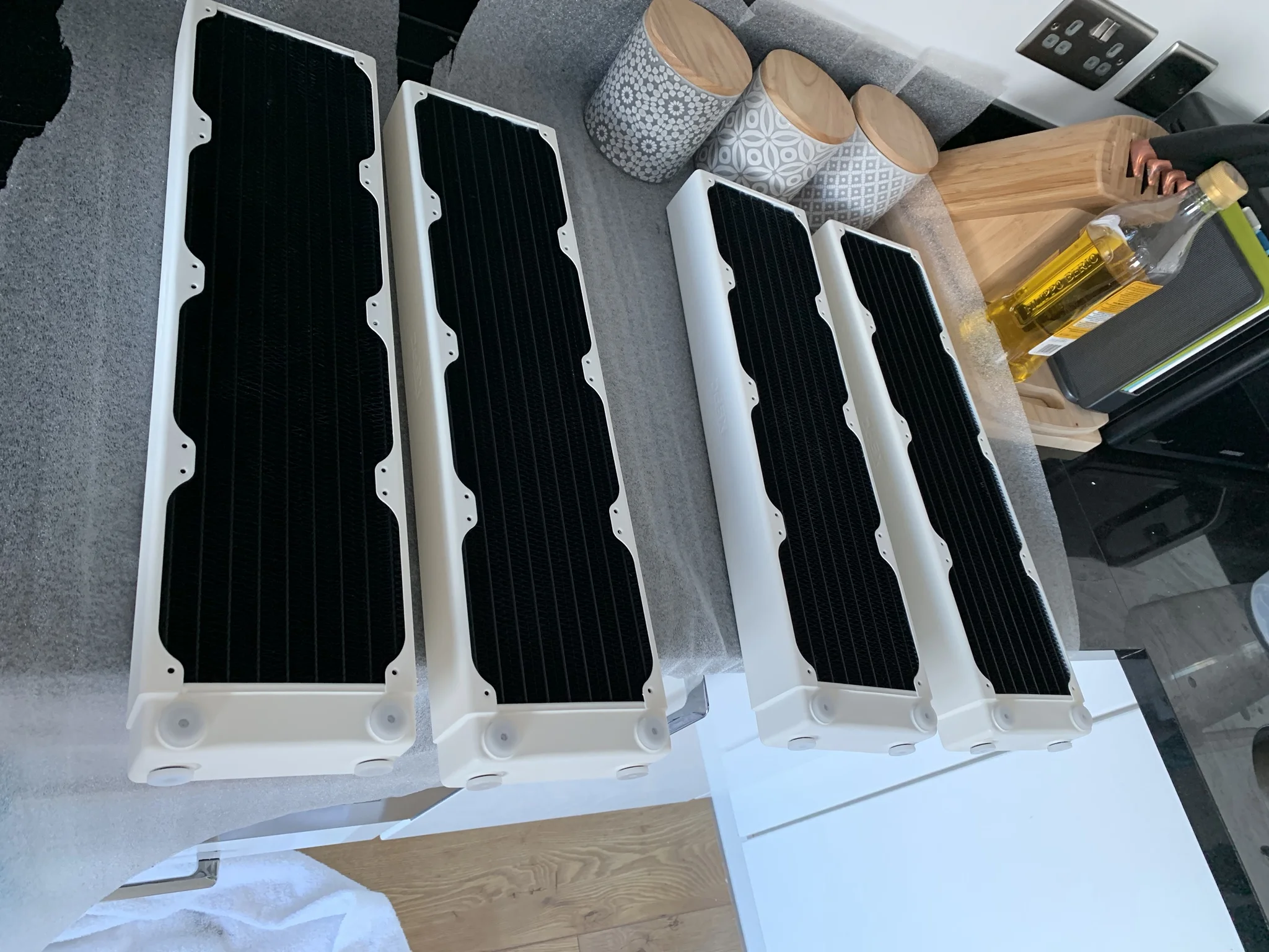

Next up needed to flush out ALL the radiators, this was a fun hour... Have to say they cam out pretty clear really so kudos on that job XSPC:

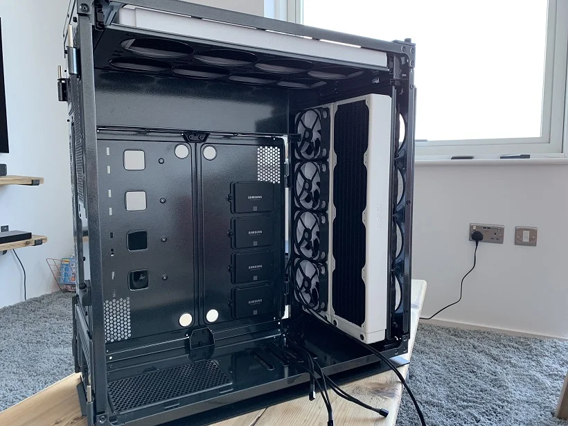

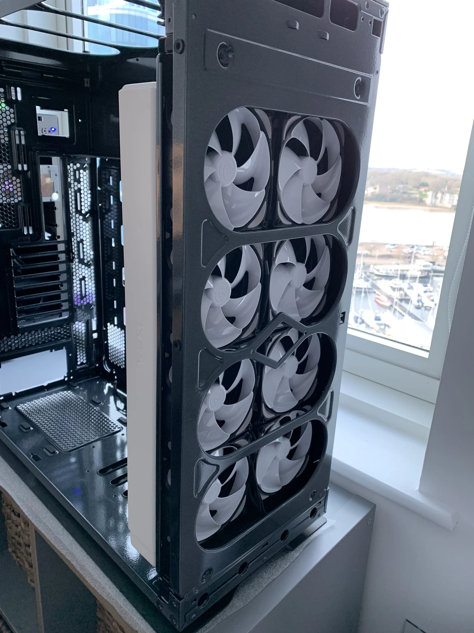

Needed to test mount...

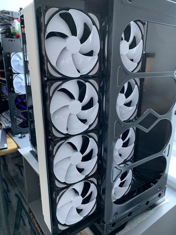

Added a layer of the push pull fans... I have some more to pair so will get those done in no time - they look very neat so glad I did all the work rewiring and braiding. However... I couldn't mount them as planned at the top with the mount tray inverted, so sadly I CANNOT fit 4 x 480 56mm radiatiors :(. Solution: I've got a pair of the 36mm and going to stealth fit them in the tray above as you can see here:
Its annoying but you cant quite get the radiator to sit on the tray mounts due to the lip at the side, I could design new trays but instead i've opted for the slimmer radiators hidden in the top tray. I will mod some hols through it to get to the ports, then a row of fans over it and it will look like it was all on purpose ;).
Right now i'm working on the designs to replace the board tray, i'm probably going to remove the old piece above the rear doors in the picture above again and just have a gap through which I think will be a good look. Its just been put back in with rivets so not hard to take out or change my mind.

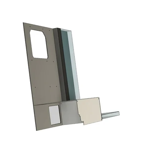

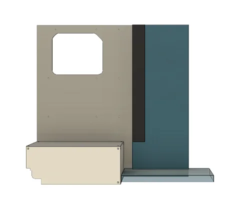

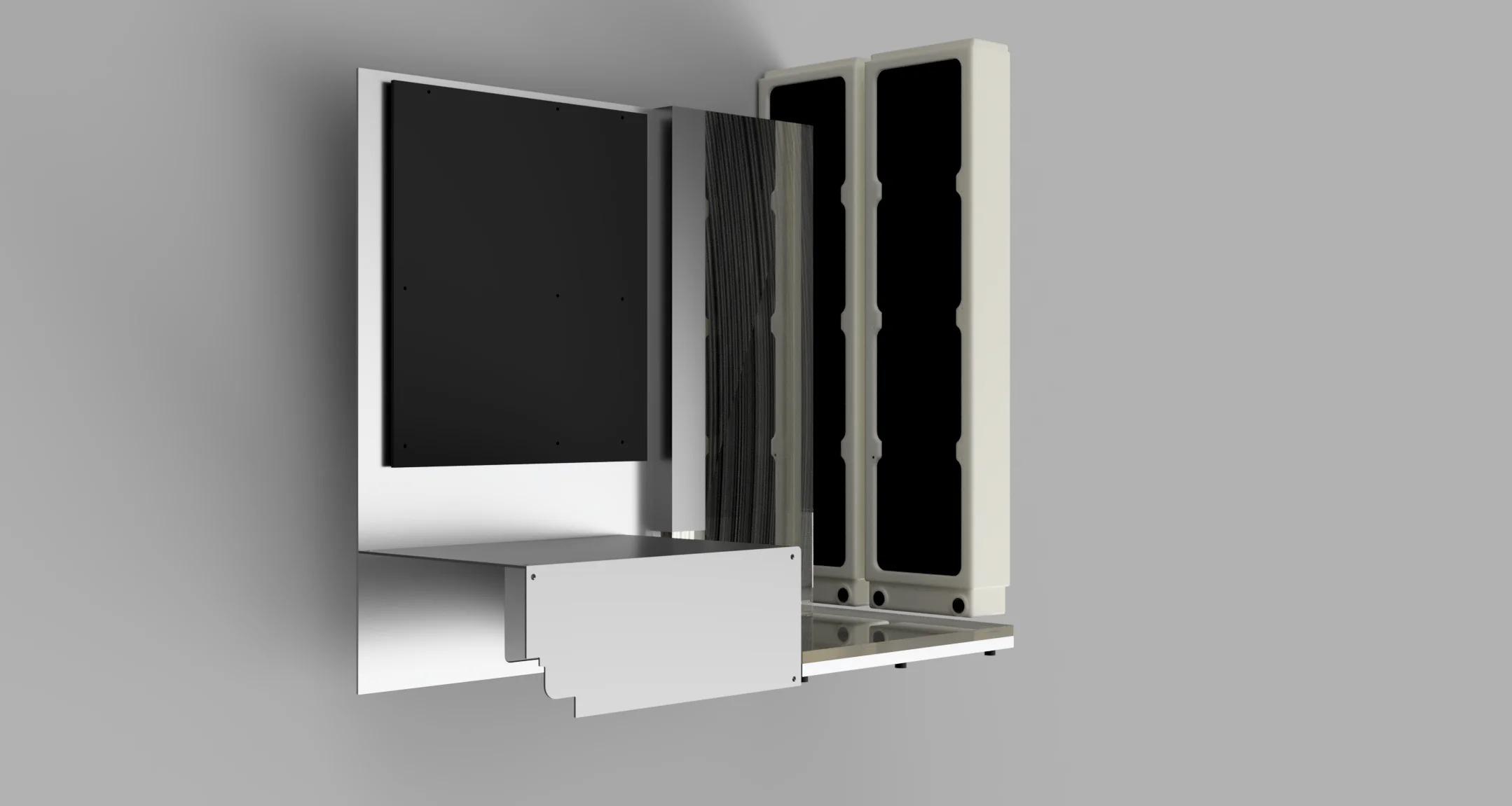

The main design will look something like this:

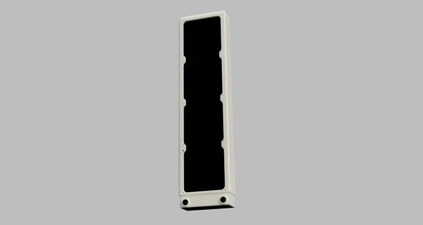

PSU shroud is completely done and measurements tested with a cardboard version from printed 1:1 drawings. The rest is early days but most likely i'll have two distro plates, the base one connecting in the front rads and back from built in D5's (x2) and the vertical one connecting all components and top rads before heading back to the pumps. work to do here but i'm currently focused on checking and rechecking the mainboard tray as its a crucial thing to get right. In order to then fairly accurately map out the distro plates i'm modelling other components which is really pushing my CAD learning to new levels but so far i've created the front radiator model based on XSPC measurements and some judgement:
Done to scale to be best of my knowledge but drawings will be tested soon and anything which needs to be adjusted will be, pretty sure the ports are in the right place horizontally which is the main thing! Finally, see below video of a quite round the case to show the finish - sorry the size is a bit off just a quick job so dont go full screening it :D:
Still working through/getting better at designing in CAD but getting to the layout before I start mapping out the ports to finalise the distro plates... PSU shroud is finalised and measured/model built and good to go!
