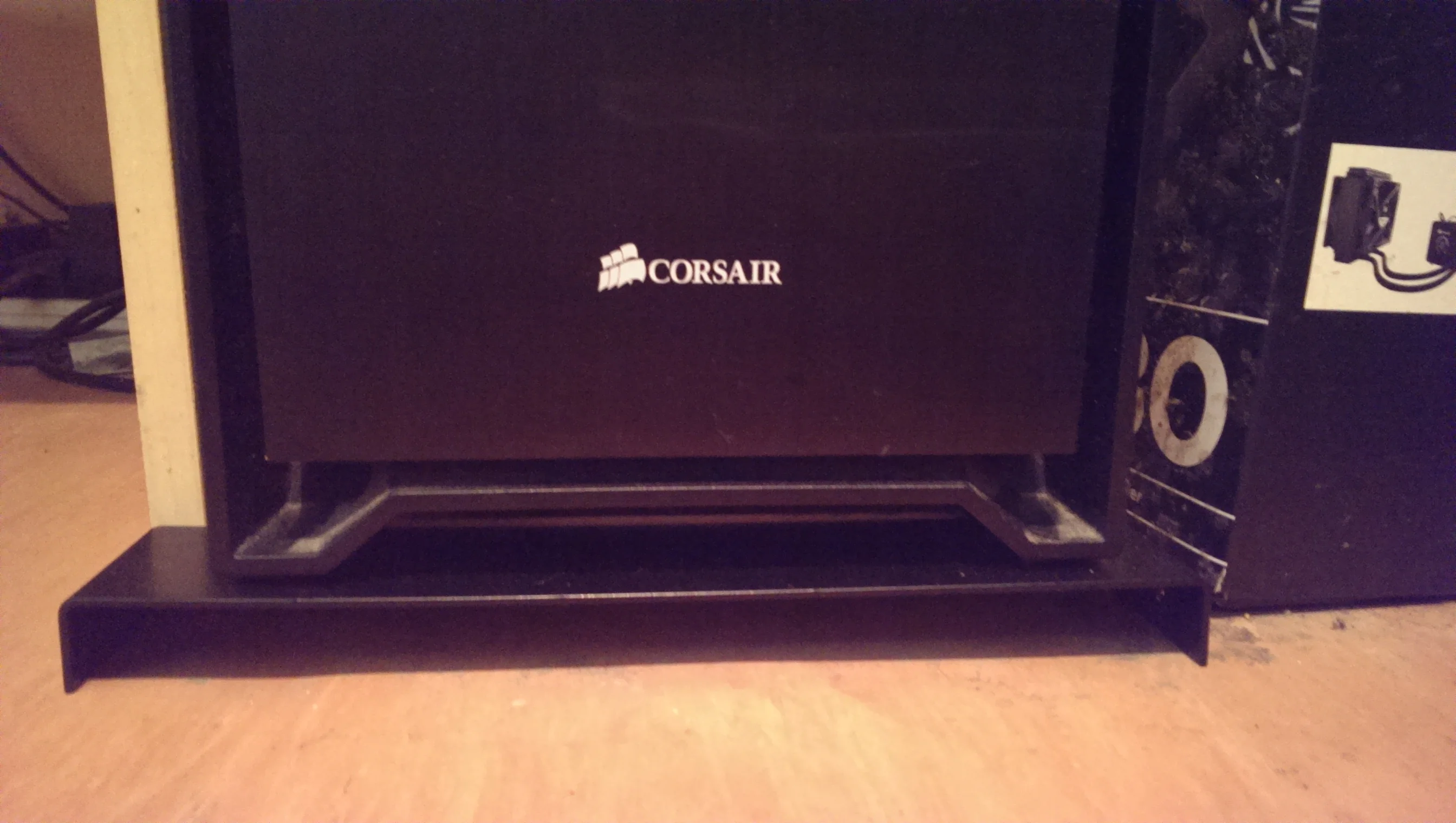

Picture 1, an overall look of the Step.

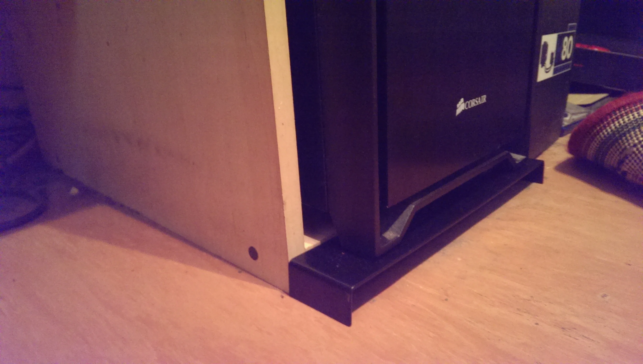

Picture 2, a side view of the Step in action.

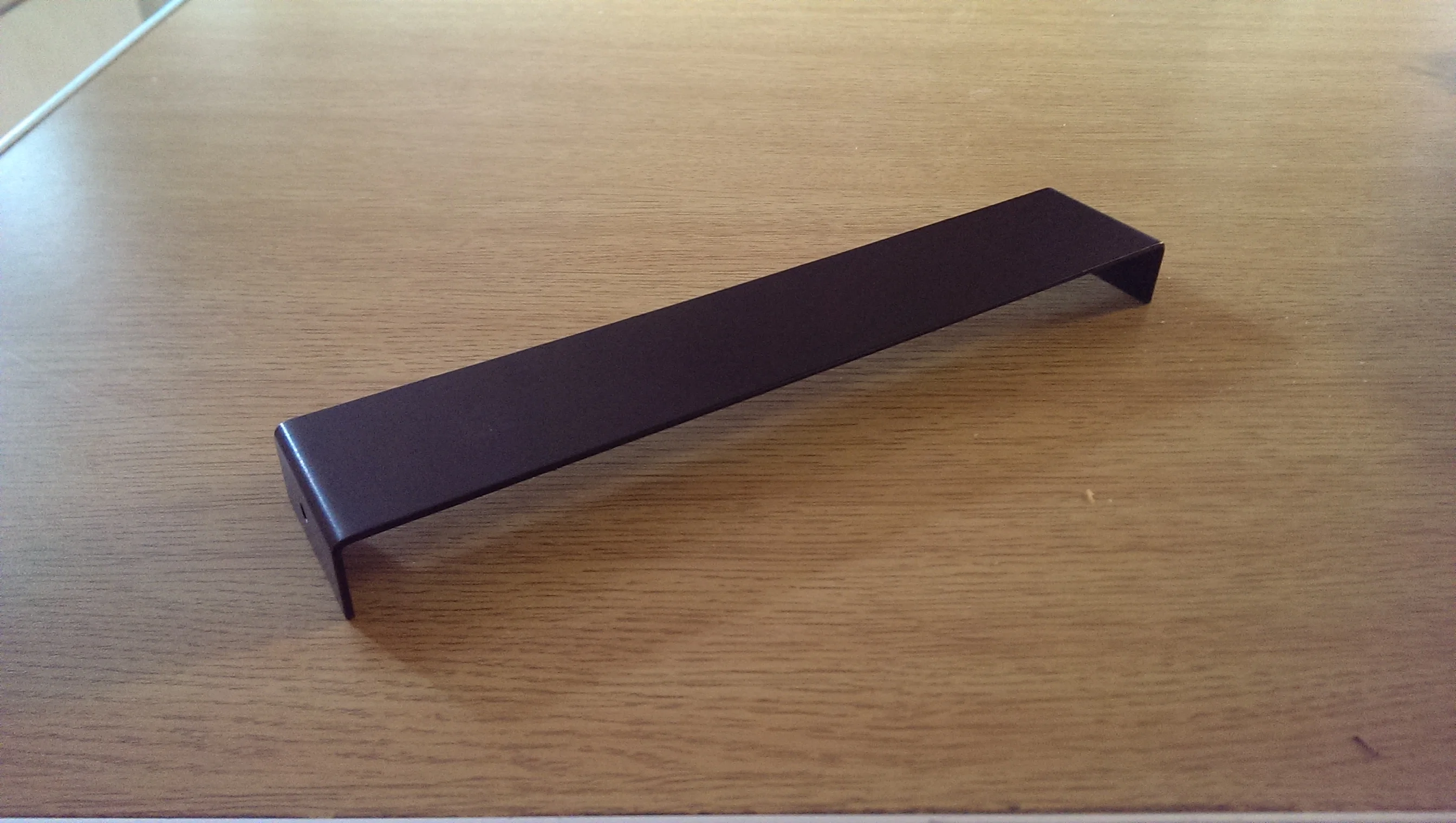

Picture 3, a front view of the Step in action.
A very simple job in all honesty, and very over produced :D nothing but the best will do! the overall specs are 280mm width, 51mm depth and 25mm height.
