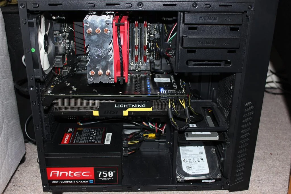

Now I probably have a problem straight away as the case is in no way shape or form, made for water cooling.
But has space for 2 x 240mm rads up top and in the front so i thought why not give it a go at modding my case and if it doesn't fit i'll buy a new one and do it properly. I'm not very hopeful so it will probably be new case. I can see the tubing placement being all over the place.
Here it is as it stands.

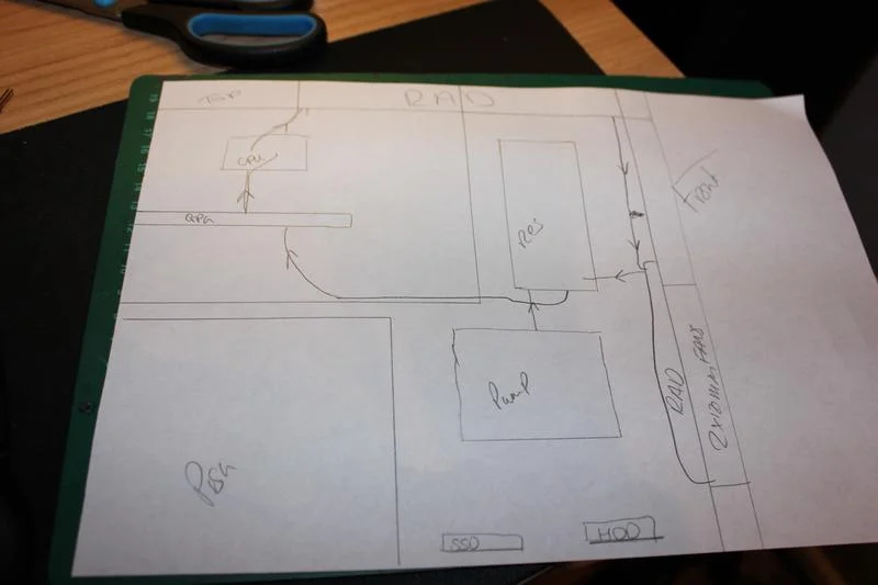

Here is the planned route (Massively out of scale but more for tubing route)

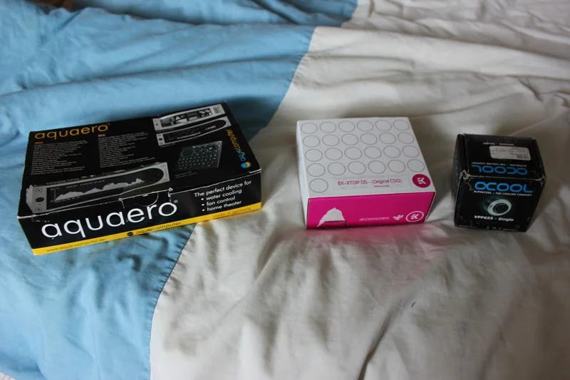

A few of the parts turned up today.

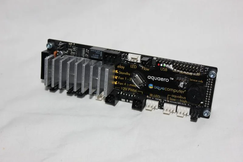

The Fan controller, which I had a quick look into how to set it up and the software. Looks like a good piece of kid. Not sure where i'm going to mount this yet!

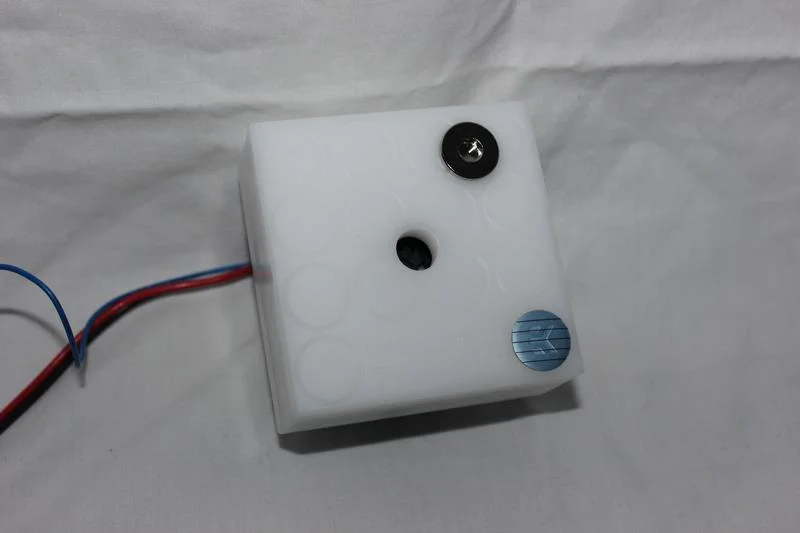

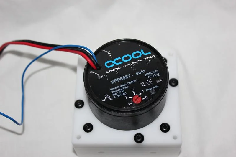

The Pump and block i didn't get pictures of separately as i wanted to put it together :D The top block was brand new so it was nice to open the packaging as i think this is going to one of the two things that will actually still in is original packaging. Looks of a very high quality and fitted very easily onto the pump. I will need to cut down the molex cable for the pump and braid it, to make it look pretty.

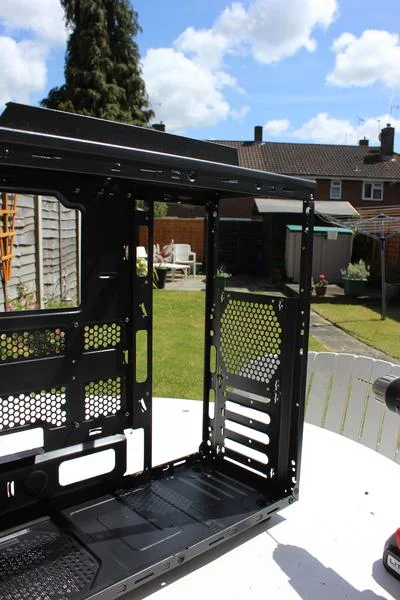

Today I finished college early so I thought i'd strip down my pc, pop it into a new case and start work on it.
Also a couple more bits have turned up. Ordered the tubing yesterday as OcUK got two in stock so grabbed both of them. Just need to finalize what fittings i need and then get my VRM heatsinks and fluid.. Oh and another Rad then i'm all sorted.

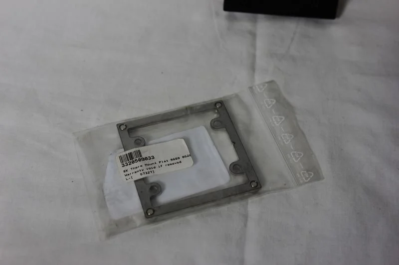

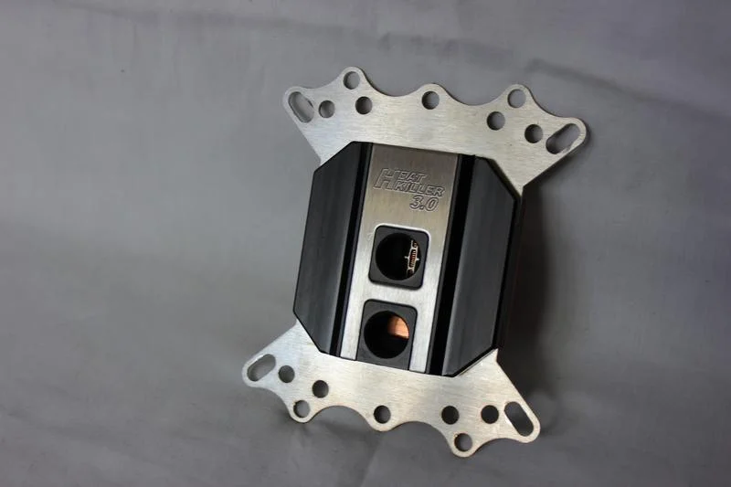

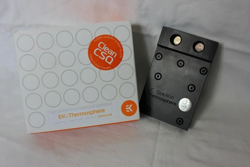

CPU Block: Looks quite pretty as far as they go. Don't know much more about it! Although, when i find out which holes i need, I may attack it with the dremel to get rid of all the other holes just to make it look a bit neater.
GPU Block & Adapter: This thing is really weighty for the size of it, i was surprised. One thing i'm not happy about is the fact i had to buy an adapter for what they call a universal block. Money thieving ...

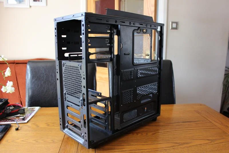

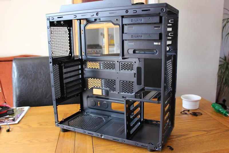

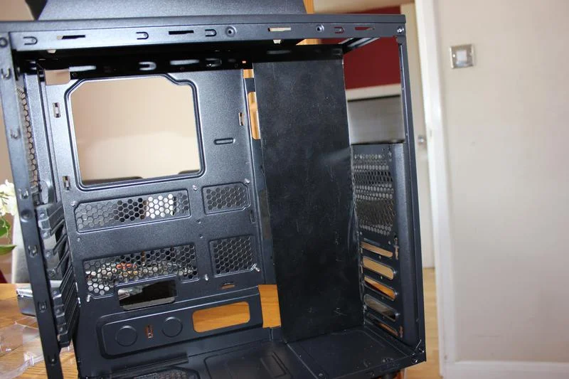

Some nice empty case shots :p

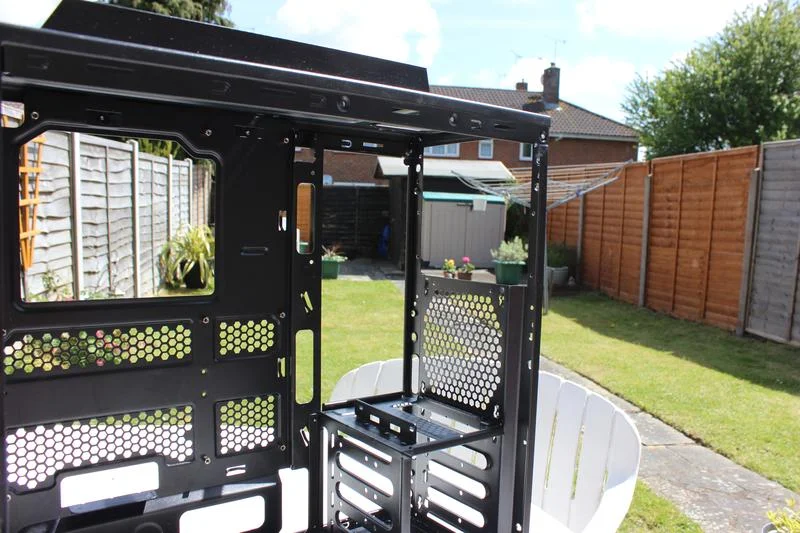

Then i let myself loose with the drill :D Took the DVD drive cages out and the HDD cages. It's so empty now! :eek:
Bye bye DVD cages!
And HDD cages!

according to your "planned route" your pump is pumping fluid from thin air INTO the reservoir, I guess this is a mistake.

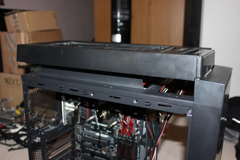

My main question would be whether there is enough space in the roof of the case so that the rad or fans aren't fouling against the motherboard? It looks like Zalman left absolutely no space between the top of the IO and the top of the chassis.
Yeah, i did notice that earlier. I drew two, this one was ages ago and then I was told by MrMD in another thread that it had to go res then pump and still managed to take a picture of the wrong one and then upload it!
Sadly I'm going to have to mount the rad on the outside have have the tubing running through the top and in with the fans in the cut out at the top pushing air through the rad and out. I will probably get some acrylic and make some sort of step up to house it in, so it kinda looks part of the case.
The Raijintek case that i put my computer in, on the other had has absolutely no space up the top for fans so i've had to screw them to the outside so it will actually have some airflow.

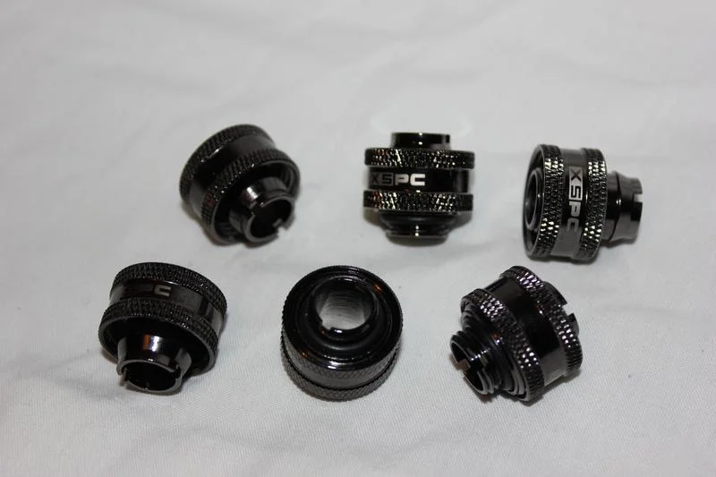

Some fittings, these are quite pretty!

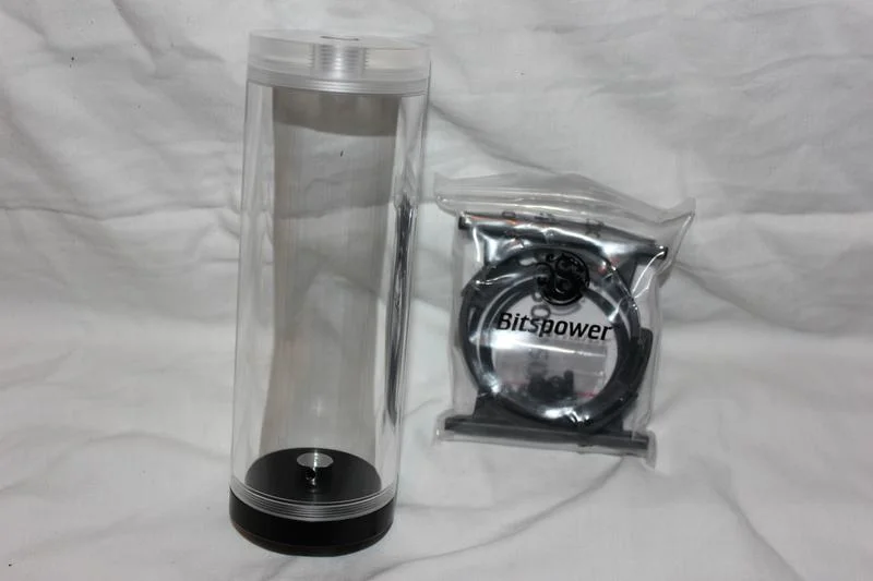

A shiny new reservoir, this is heavier than i was expecting it to be. Build quality is very good though, i like it.

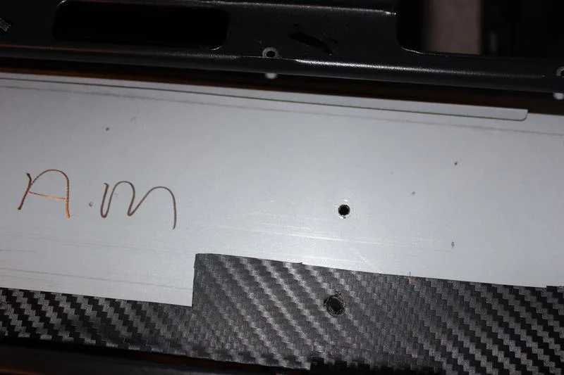

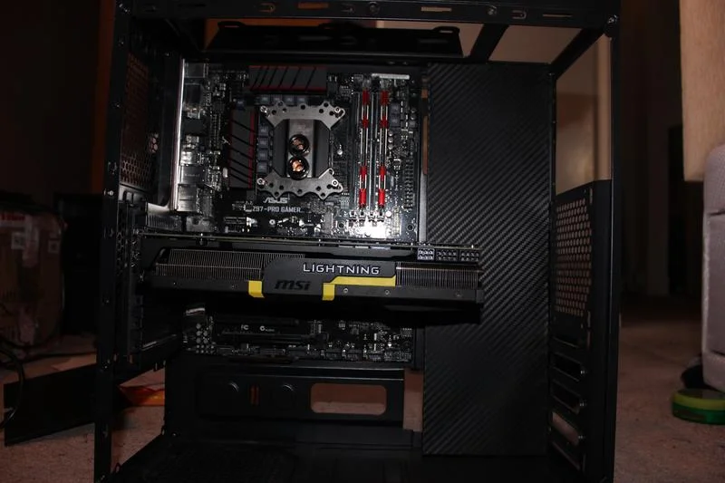

So i made an NZXT cover type thing as i needed somewhere to mount the res and hide the fan controller.
Then i finished it off with some Carbon sticker wrap stuff.
Then drilled some holes to fit, res and fan controller. Also got a little bored and wrote my name with the dremel.. No my name isn't 'am'! :)

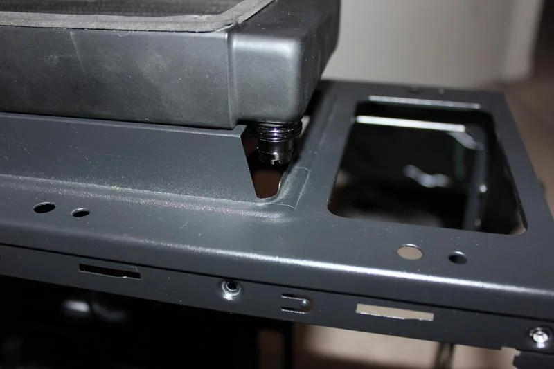

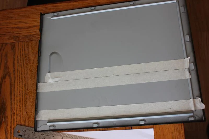

Then popped the rad up top and went for a test fit, I am going to make a little section to go around the bottom to cover the gap so it has the step up but will look all like one.
And then the fitting wouldn't fit, so again the dremel came out!

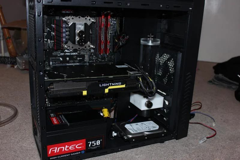

A little test fit.. I moved my SSD and HDD to the bottom of the case and screwed in the pump. Doesn't look to bad and not a bad fit..
