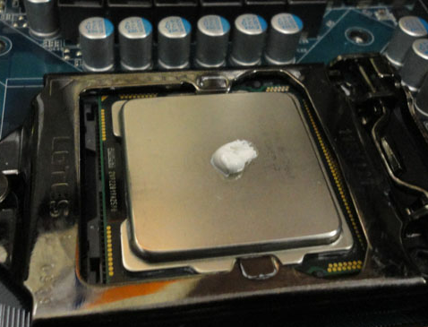

Is putting down this amount and then just leaving the heatsink to spread it as I screw it in the best way?
almost there you should apply pk1 in the middle and let the pressure of the heatsink do the rest; to me though it looks like you have slightly too much. Should be no bigger than a grain of rice.
