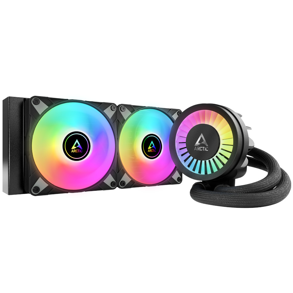

Your parts above need some tweaks. You don't need a £144 AIO to cool a 14600KF. A £35 Thermalright Phantom Spirit PS120 SE (available elsewhere) would be more than enough for it. Even if you stuck with a AIO don't go with Corsairs overpriced offerings. Look at the Arctic Liquid Freezer III ARGB 240mm at less than half the price instead. It's on pre-order here but there are plenty of other retailers.

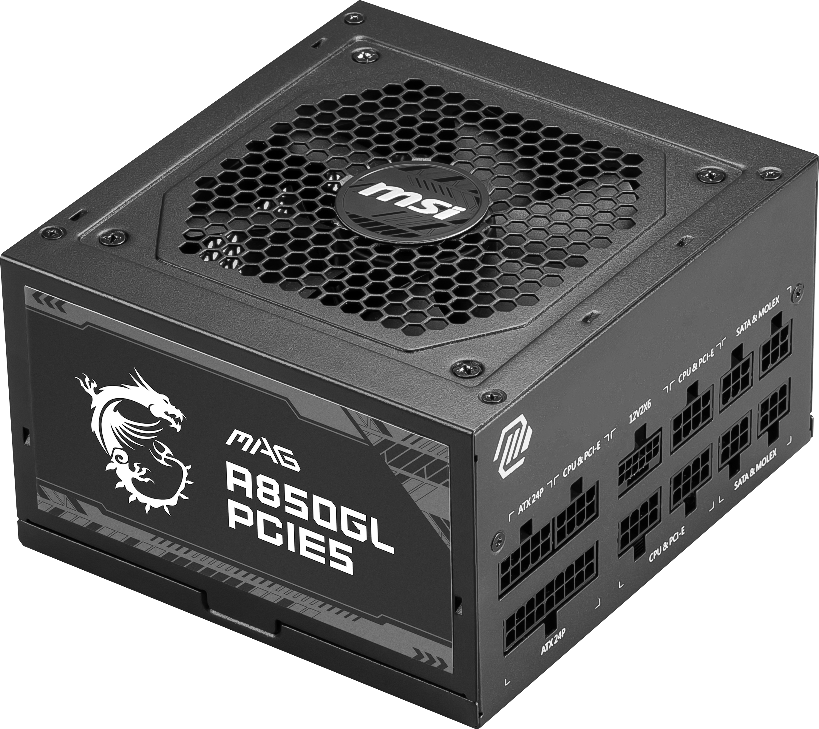

The psu is still massive overkill unless you are going to put a RTX4090 in the pc. Something like the MSI Mag A850L 850W ATX 3.0 psu at just under £120 would be more than enough yet still have extra headroom for future upgrades. Yet again it's on pre-order here.
