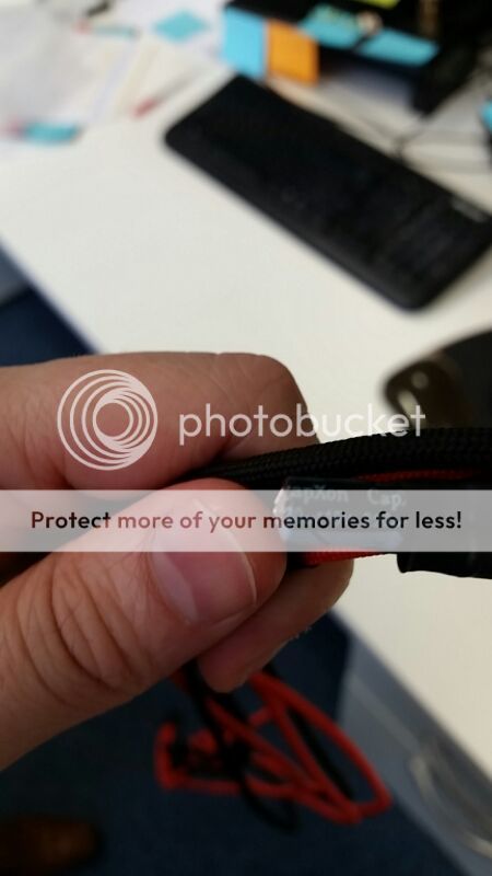

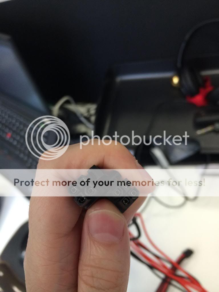

I recently braided my cables to only turn it on and hear a BIG bang and a lot of smoke from one of the cables. It turnes out it the small 4pin CPU cable (of which is made up of 4x2 but I only use one of the 4):
After some inspection, it's the capactior on the cable that has blown:
Can see how it is bulging at the tip.
Now the PC works fine despite this, however im now worried that this capacitor was here for a reason and so it must be important - despite the PC working now or not.
So here are my questions:
1) Should i just forget about this and use my machine normally? Afterall it works...
2) Can i purchase a replacement capacitor elsewhere and replace? I took pics of every details found on it and more pics can be found here http://s1359.photobucket.com/user/freelancerkev/slideshow/PSU Capacitor
If anyone has any advice on how to proceed, that would be great. I don't want to fry my CPU (What this cable directly powers) or any other parts by risking it with this cable.
I have tried to reach out to superflower (psu brand) for some cables but after 1 week there is still no reply. Look forward to your replies.

The Superflower Leadex comes with 2 cables for the motherboard 8 pin socket.
You should have 1 x 8 pin EPS and 1 x 4+4 ATX/EPS. You can use either cable to power up with. So you can either just use the other cable for the time being, or you could see if it has the same capacitor fitted.
I used 1 x 8 pin and 1 x 4+4 ATX/EPS but only 1 of the 4 mate to power my CPU. The 4+4 however are on the same cable and share the same capacitor. This is the one that is blown.
