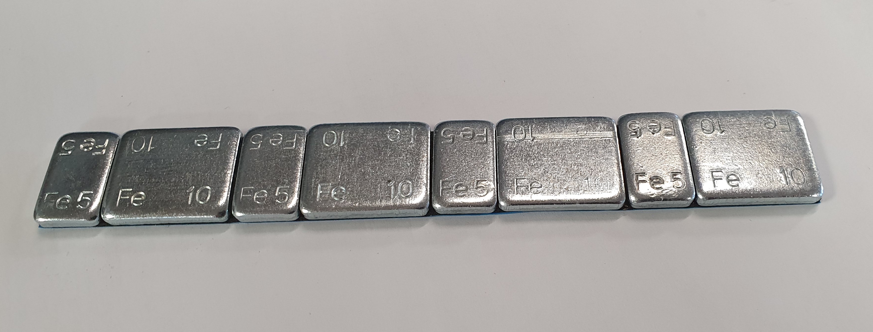

Luckily the design of the Pulsar mouse shell is it has large cut-outs in the base of the mouse into which you can stuff blu tack or plasticine or whatever right into the body of the mouse. I'm not sure why these cut-outs are even there, other than to actually intentionally reduce the weight of it, it really is as light as a feather, but they will be just the job to mod it without having to open it. I'm getting some stick on motorbike wheel balance weights to fit in there so will be able to gradually increase the weight and ensure it is balanced each side.

Going to put some of these...

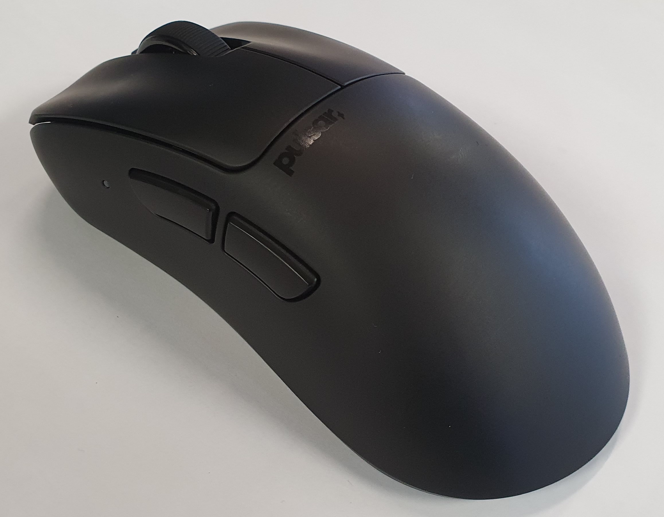

In to this...
Almost as if they want you to do it.
Masking tape down on the PCB to make it easier to take them off if need as they have a strong adhesive backing. There is no chance on them coming off and going inside the mouse due to the adhesive.
Blu Tak for the bottom one to shape the recess in the shape for the weight. Top right will need a bit filing off the weight to fit, will do that later.
More Blu Tak around the bottom weight to help keep it in position.
Layer of insulation tape to hide. Could improve on this with some thin black plastic sheet cut to each aperture to make each one flat and neat.
All in all it's gone from 55g to 85g and is still balanced. I can actually feel I am holding something now. All done without having to open up the shell.
