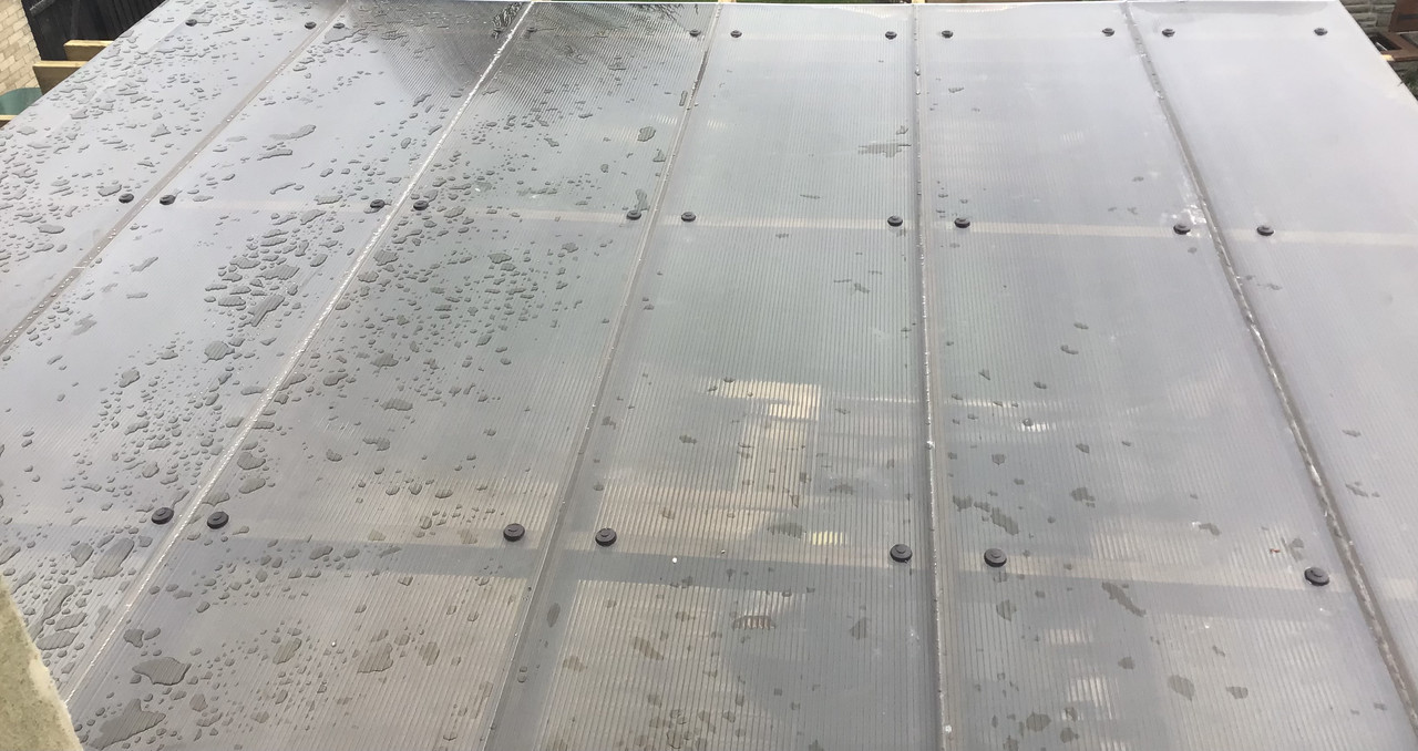

I built pergola's over the top of both my decks and roofed them.....one is now a cosy sanctuary all your round with sofa and out side TV. The other is the outdoor all year round kitchen. I used Twin ply polycarbonate

no - i didnt like the look of them. So i used clear sealing tape over the joints after butting them together and sealing with silicone......
that roof is 4.2mtrs x 4mtrs….

Doesnt make any noise at all…….i sit under mine in the rain often and watch the football as its nice, cool and refreshing. Its the main reason we put the roof on it, for all year round use.
As for cheap and nasty, each their own really…one persons cheap and nasty, is another person posh and luxury.
