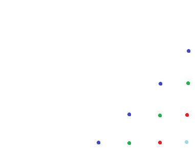

I think I get you
so sort of like this
with the colours being "rounds" of nailing?

I think so, the pattern can vary, you can go along one edge then do another row etc but in theory you never go back so you are always working in the same direction so you cannot end up with something thats raised that you need to go back to.
You normally do the opposite and nail at least 3/4 corners to stop it being able to move but now your not so you need to be careful to ensure your keeping straight.
I would probably just put 1 screw/nail loosely in the opposite diagonal corner to start, do a few as you demostrate and then remove the other corner to allow the piece to move as I work across.
