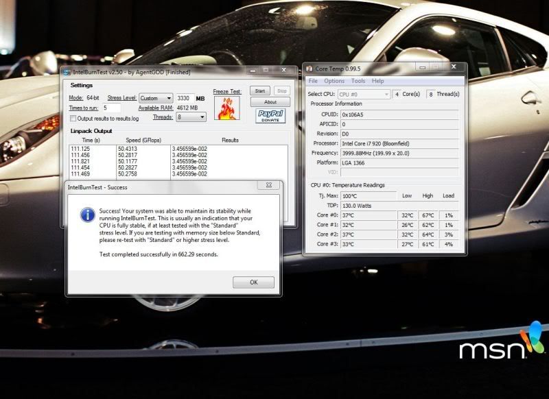

Ran a custom 5 pass test, 3345mb of ram listed as free, input 3330 in IBT, 8 threads as for some reason auto doesnt max the cores on my i7.
Results.
Temps about 2-3c higher than if i run with maximum memory setting.
Results.

i7@4Ghz 4 x 16 = 64GFlops (max value)
50GFlops/64GFlops x 100 = 78.125%
You passed the 5 runs IBT test:) and temps are wonderful. Now run it for 50 passes and if you are successful then you have done it :).

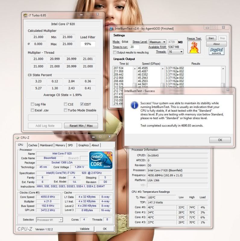

it's something to do with ibt only seeing actual physical cores and not hyperthreaded ones so on auto its only running the same amount of threads as you have physical cores.
it does funny things with amd chips with unlocked cores on auto settings also.
Heres a run i done last january, though at that time i was running 21 x 193 bclk on the cpu, (ram at 1547 mhz). Maximum ram selected in IBT, and the GFLOPs are a lot lower. 16 threads selected due to a bug in that revision of IBT when 8 were selected
