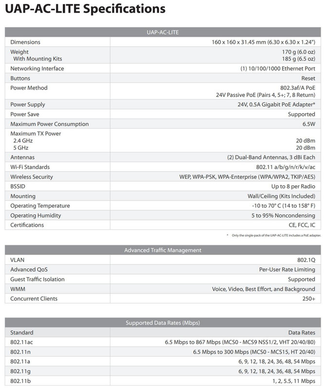

Basically I would go straight in with a POE switch with a little headroom, the datasheet on the ap puts it's power consumption at 6.5w:
So both of the above options offer all you will need. The first option will only run one and will consume a port on your bt hub per ap. so you will go out of the hub, into the injector, out of the injector poe, into the wall to the ap.
If you go straight for a switch it's out of the bt hub, into the switch then straight out of the switch to how ever many AP's you require (first switch will give you 5 comfortably and second double that).

One thing to bear in is that when the Lite and the LR models came out they were compatible with 24v POE only which is not an issue if you decide to buy a Unifi POE switch in the future but if you bought a switch from a different manufacturer it might not be able to power the AP and worse case damage it as 24v POE is a Ubiquiti proprietary standard.
If the device has a serial number or manufacturing date on it Ubiquiti might be able to give you an answer.
If you can take the AP down and get a photo of the label then people will be able to confirm exactly what PoE injector you need.
