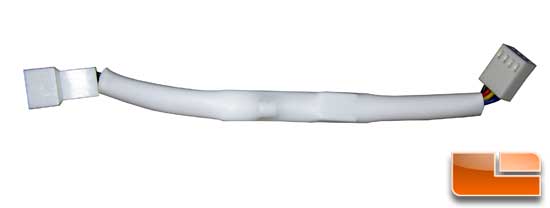

I wouldn't have thought that would happen, it looks like it comes with a voltage adapter cable, are you using that with the splitter?
well there is a cable that fits on to the CPU_FAN header and in the end of that the little Y splitter slots in to it ..and thats what I put the two fans in to
If you're plugging it into this cable:
It's a PWM controller cable which allows 3 pin fans to be controlled by PWM, this also lowers the max speed of tha fan, presumably because the controller is in the middle of the cable. If you don't need the PWM feature of the cable then you can take this away and use the Y splitter on it's own or use your old splitter.
