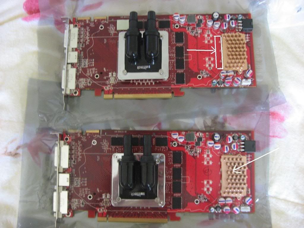

In this pic you can see 4 grey chips 1 ramsink can cover the top two and 1 on the bottom 2 and the little black chips 1 ramsink over top 4 and same with bottom 4 so really all you need is an additional 4 ramsinks.
The memory sinks are the black chips on the left hand side around the processor.
some people say the memory sinks which come with the s1 have bad thermal adhesive but they will stick on fine if you clean the memory chips up with some good tim cleaner.
This bit on the right hand side are the voltage chips, what someone has done here is hacksaw off the stock cooler and kept the right hand side
You could do that with a hacksaw or alternatively get extra ramsinks like I did and use 2 per 4 voltage chips
I believe it's the little fellas all the way out on the right that need the extra sinks putting on, essential on a 4870 and do it anyway on a 4850 kinda thing!
