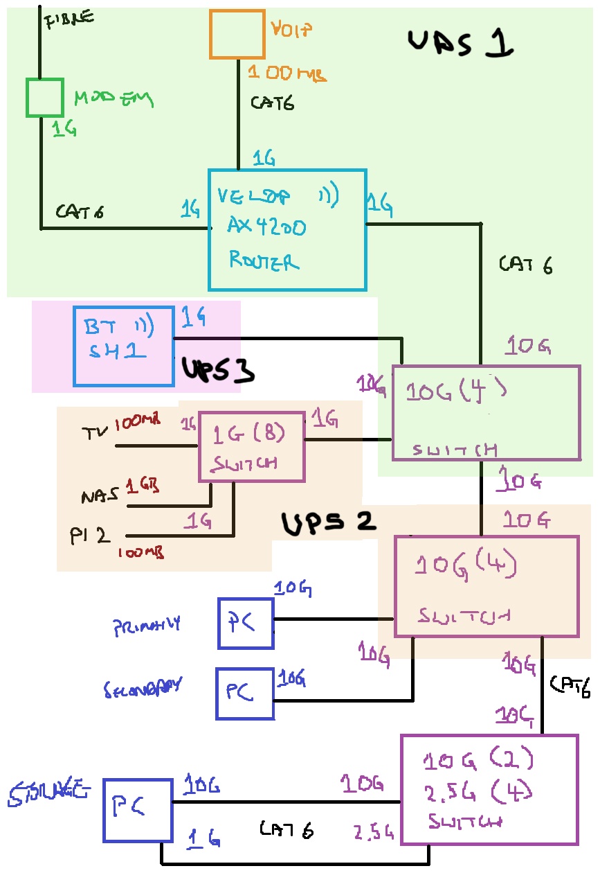

Hi all, more of an academic "I would like to know more" type of question here this time, as I already have the network up and running and doesn't appear to have any issues.
So the home network I've got up and running at my parents place is essentially a 10g network (cat6 connections) with the "core switch" being made up of two Mikrotik CRS304-4XG-IN switches that have been daisy chained up to serve the various rooms and devices. It all works fine (full 10g 1.11-1.12GBps file transfer speeds at base MTU settings, etc), but I read something about it being undesirable to daisy chaining the switches via ports to form a larger (core) switch as being undesirable due to being limited to those port speeds; That got me wondering about if the network I have setup would experience this same issue that was discussed or not? I'm of the mind "no", but just wanted more experienced minds on networks to give a heads up on it or not.
So the purple boxes are switches in the diagram, with the two on the upper middle right being the two Mikrotiks mentioned.
The cyan boxes are wireless access points (And the router).
The blue boxes are the 10g devices.
So the item I read about online, says that the daiy chain approach is not ideal since the link is limited to the ports data rate rather than the data plane at the back of a singular switch (used as a core switch). This I get, especially if all devices operate at full speed and constantly hammering the whole network. However, the setup of the network has all the 10g active devices (which only communicate with each other when I ask them to - for file transfers or backup or Remote AI work; are all user induced) are all connected to the second daisy chained switch and all other devices connected to the first switch. So should that mean that the issue with the link to daisy chain up switches to effectively create a larger core switch is not expected to be an issue here on this network given it's use style and layout?
In the future (when there's more in the family that might be using the network more at the same time), I'm thinking that's when I need to considering making a switch to a singular larger switch for core switch use? But for now - given it's really just me doing any heavy network use (the rest is VOD and Youtube by my parent) it should mean the port link issue is not a concern?
Thanks for any clarification/confirming and if there's anything you noticed off with what I've posted.
