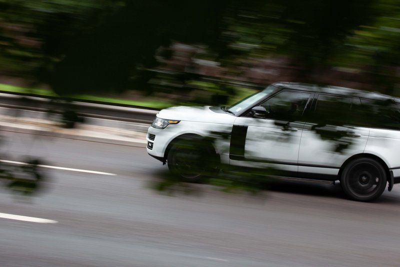

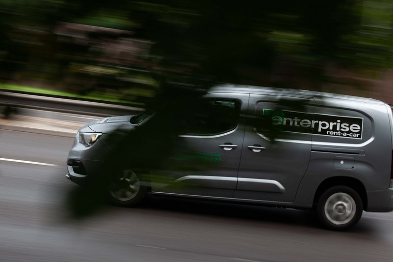

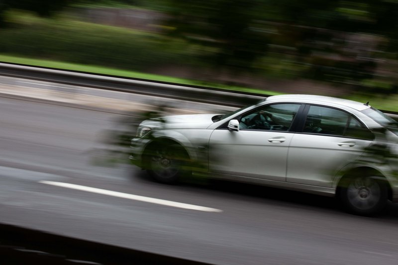

These are three shots I took at F13, 1/50sec, ISO 640. The background had the sort off streaky out of focus effect I want. Didn't really nail the focus on the cars though. My location wasn't good, there were hanging branches in my view, but I just wanted to quickly test how close I could get to doing this. Needs lots of practise! Should be better next time on AI Servo.

Oh you want to do panning, then you do want slower shutter speed. Still you can lower the f stop to lower the iso too. And good effort!
Yes, sorry Raymond, I should have said panning, that was misleading of me. Yes, I'll try lowering the f-stop and ISO. And thanks! Can only get better from here I hope. :)

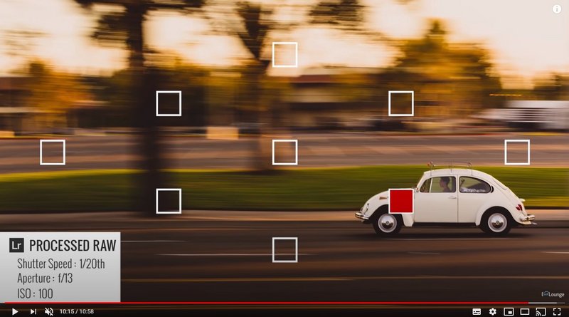

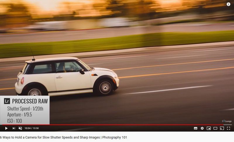

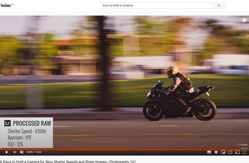

Thanks Gmac11, excellent tips, much appreciated! Yes, no A/V alerts on focus in AI Servo will make me think I don't have focus. I'll have to trust it. I'll go and look up back button focus on youtube. That'll be my next thing to watch. I had previously seen a video about panning to capture cars in motion and these are screenshots from the video which is why I thought I should use a smaller aperture.

I used my 70-300mm f4 to 5.6 lens at 70mm. I'll try with f4 then.

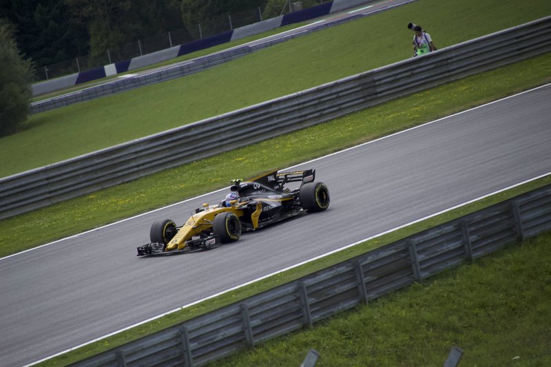

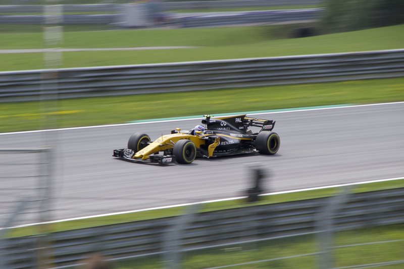

Sorry I should have been a bit more forthcoming about the fstop. I was looking through some F1 photos I got from the last GP I attended and I see they range from f6.3 to f11. However I think the reason for going up to f11 was to keep the shutter speed down. It was in Austria and the sun was blazing. Here in the good old UK we generally don't have that issue (well I certainly don't in NI!).
Below are two examples of a 1/60(f11) shutter speed and a 1/2000(f6.3):
https://i.postimg.cc/JzrM3NbL/IMG-1075.jpg
https://i.postimg.cc/Vkx4QRDy/IMG-1083.jpg

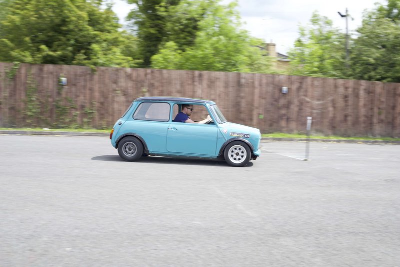

This is an example from an Auto Test day I shot:
https://i.postimg.cc/MGRnN0rF/IMG-7252.jpg
This was at 1/125(f7.1) but again on an uncharacteristically sunny day.
Just to clarify what I had said before as when I read it back it didn't seem like great advice. I maintain the fstop should be as wide as you can get it however as I've since discovered after looking through my back catalogue you may find that 'as wide as possible' could still be as high as f11. It will all depend on the light levels.
Also please don't read much into my composition on these photos - they were taken straight from the unedited RAW files :p
