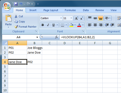

Easy:
=VLOOKUP(B4,A1:B2,2)
Where B4 is the cell used for the search data, A1:B2 is the table range and 2 is the column to get the data from. Put the formula in another cell (this is where the result will appear).
If you want an actual popup dialog then you will need to make use of VBA which makes things a bit more complex.
You can also use the FALSE parameter eg: =VLOOKUP(G2,A:B,2,FALSE)
Which will return a #N/A if the seek value isn't found.
Please also bear in mind that your seek column (machine number) needs to be in an ascending order.
