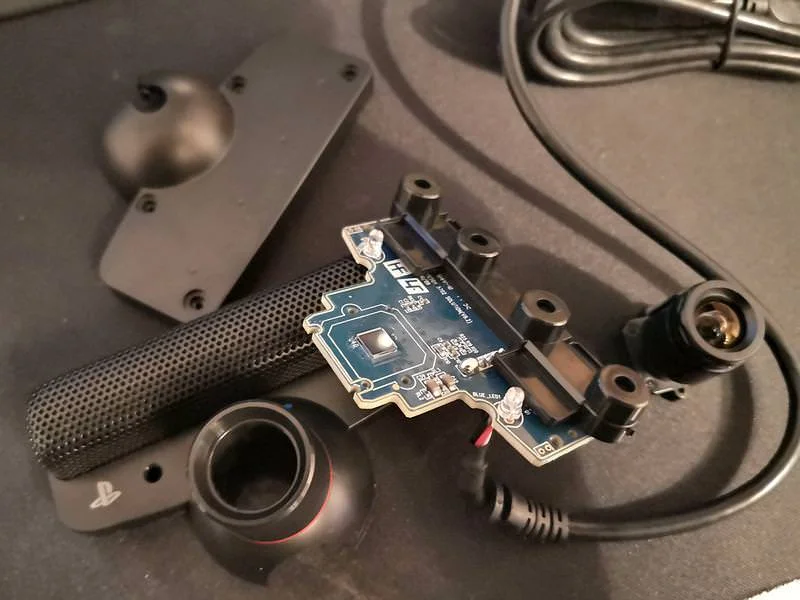

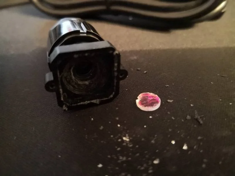

First job was to rip the camera apart (PS3 cam)

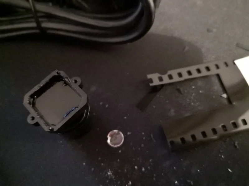

Remove the IR filter
And replace it with a light filter (old film negative)

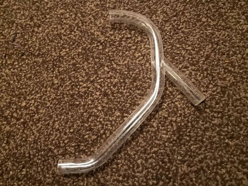

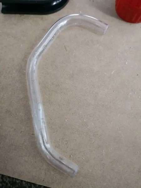

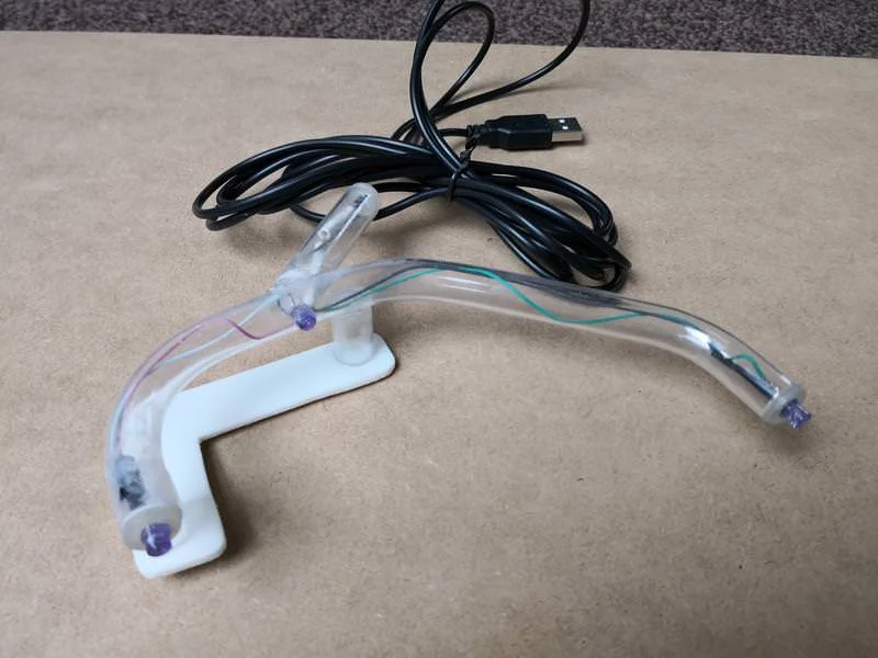

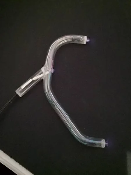

The camera now picking up only IR light it was time to make the headset. But what could I use that's free? That's right, watercooling tubing I had left over from the W2W build
An extra piece to tidy up the USB cable a bit

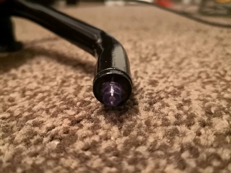

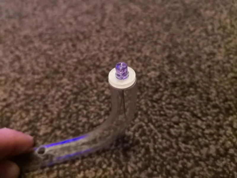

And then the awkward bit: How to mount the LED's. The middle one was easy, I just made the hole directly opposite the larger USB cable hole and pushed it through from the inside, but the other 2... At first I was trying to make small plugs out of left over acrylic

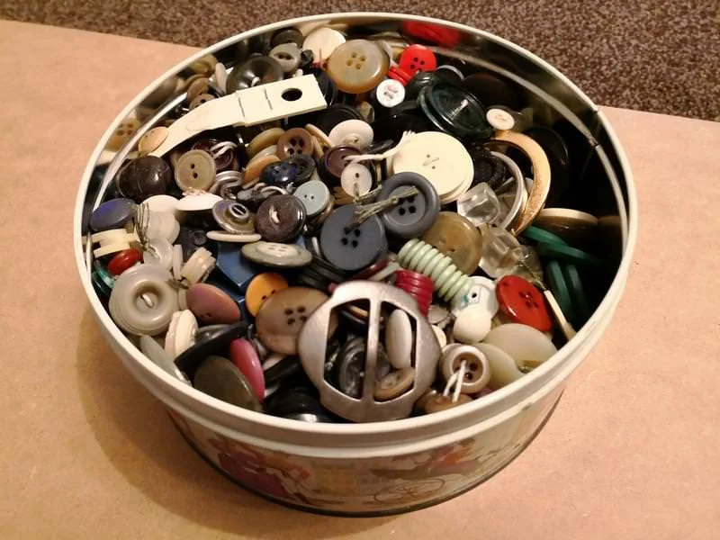

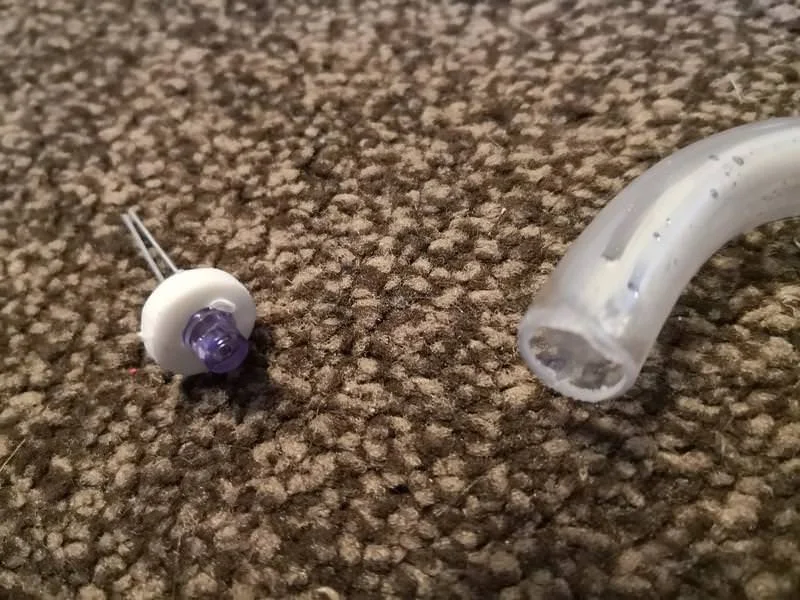

Which was a major PITA, but then the missus had a better idea: BUTTONS! So I asked mother if she had any random buttons I could use and was given... This
Bit of searching later and found 3 perfect sized buttons, 2 for the LED's and one for the USB cable
All soldered up and glued together, time to test it's working

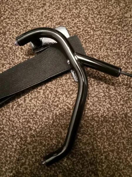

Then came the issue of mounting it. I did't want to have to wear headphones, but it needed to be far enough from my head that my face didn't block the centre LED when turning... More left over tubing & acrylic to the rescue!
Quick lick of paint
Some elastic velcroed on to make a headband

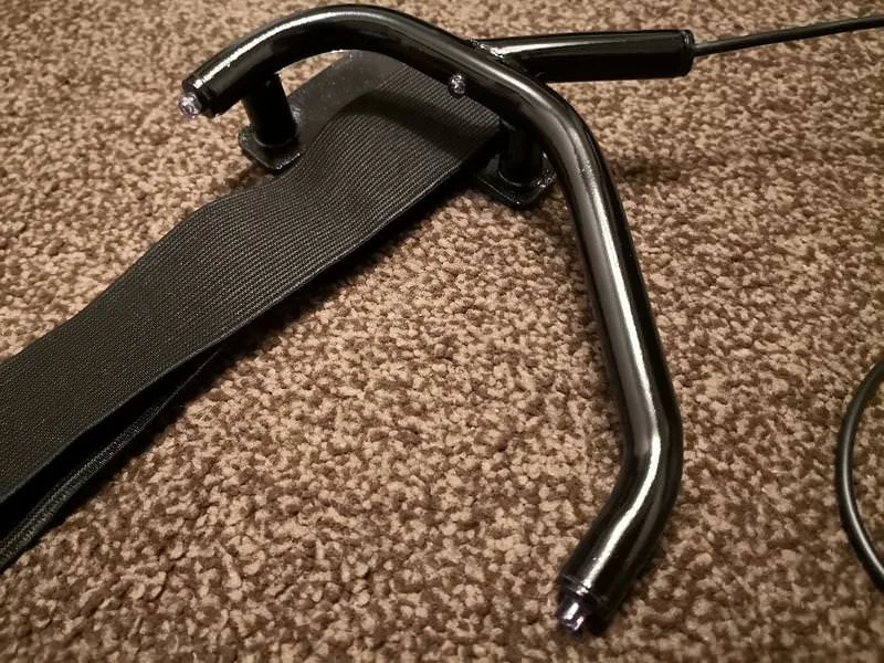

And we're ready to test!
I was worried it wouldn't hold stable enough and would pick up false movement as it 'twitched', but I needn't have worried, it holds rock steady and works perfectly
So, for about £14 all in I'm pretty happy with that! Now back to the proper build, with another small update coming tomorrow... Hopefully.
