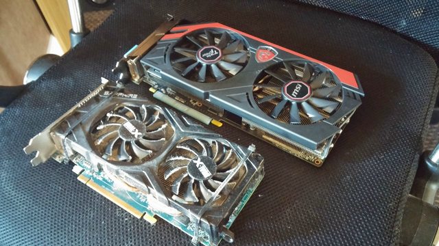

Can add me to the list. MSI 290X 4G LE
Having some issues with it though it's throttling the core while playing games, read through a massive thread about about powerplay but that was last updated like a year ago and seemed driver related... the last drivers been mentioned were like 14.x.
I haven't got an overclock at all and it's really frustrating as it leads to FPS dips while gaming.
If I force an overclock through MSI Afterburner it will sit locked and temps only hit like 85C, but then it doesn't go into a 2D mode and the clocks will be at whatever I've set... which leads to higher idle temps.
Anyone still having issues like this?
Anyway, here's my photo!
Bonus photo of it next to the 7850 it replaced.
