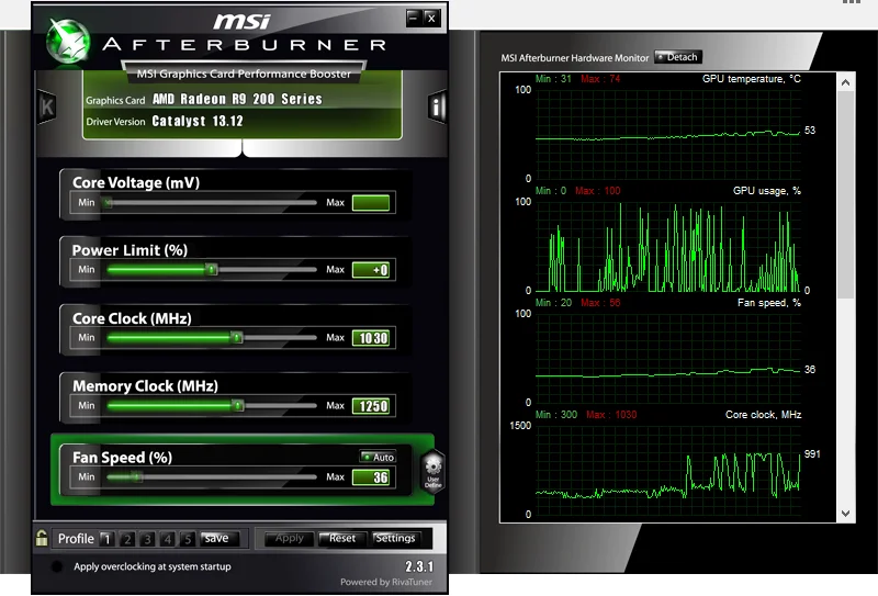

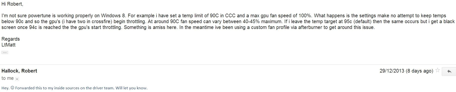

Yes! I believe this is one of the possible reasons for the black screen bug. Set a manual fan profile in CCC or afterburner.
I've reported that bug to Thracks & AMD so they're aware of it. Are you on Windows 8?
http://i.imgur.com/dEtbWpY.jpg[IMG][/QUOTE]
Cheers for that, didn't know you could set a manual profile in Afterburner, so thanks.
On Windows 8.1, just tried to 13.11v9.5, see if that made a difference before making the profile, which it didn't, so I'll go back up to 13.12 now, and keep that manual profile.
It's only for a time being anyway, as I'll be putting together a custom water loop soon.
Good lad. I noticed it while back and reported it immediately.

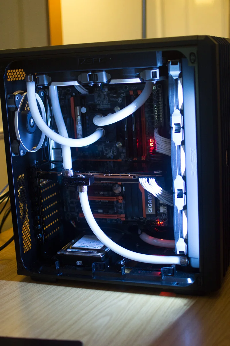

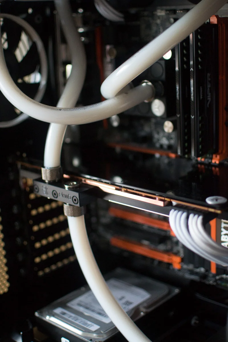

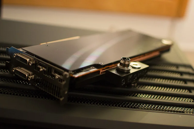

My toys up and running
Will be fitting waterblocks soon.:D
