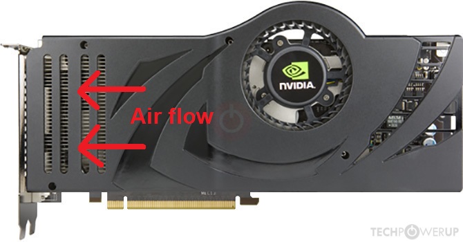

A design with two smaller turbines on the far right/top right part of the PCB, and heatpipes going from the large Vega 20 "vapour-chamber" directly to the left, connecting with the ports plate and transfering the heat directly to all the metal section of the chassis will keep the Vega 20 cold as ice. I promise you :D
You already talked about this the other day, if it was as easy or as effective as you make out it would have been done a long time ago. Just because we only see 3 main cooler designs from companies (blower, axial and aio) doesn't mean that behind the scenes they haven't experimented with other options.
I want a product which they sell to me, and I see it. What they do behind the scenes you can't know. Maybe they never did it.

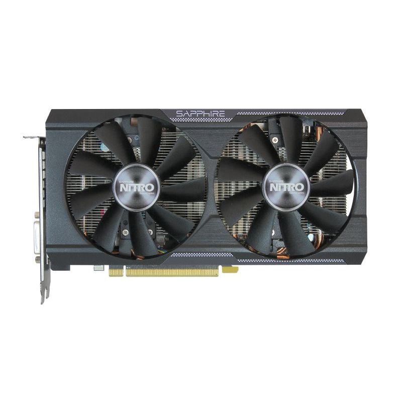

Maybe you should apply for chief cooler designer at AMD. all the top air coolers are triple fan design
I don't know. There are double fan designs and I am sure they are better than the reference Radeon VII.

The fact that a dual blower card has never seen the light of day suggests it was tried and never worked. Do you honestly think companies would try dual and triple axial fans and never have the same thought about the possibility of a dual blower fan card? Unlikely.
