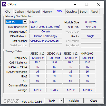

Interestingly, I noticed in CPU Z that my two (apparently identical) RAM sticks are showing different timings - see attached - what could this mean?

Those sticks are not identical, did you buy them as a kit or separately?
One is micron single rank the other is Hynix dual rank.

It might explain why your having crashes yet no errors showing up in memtest as the ram is fine but more of a compatibility issue running it together.
Tbh you should really get some better ram anyway for ryzen as it really likes ram over 3000 with 3600 being the sweet spot for ryzen 3rd gen.

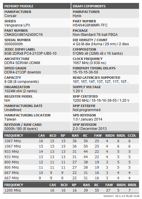

Could it just be that cpuz is reading them wrong? Try thaiphoon burner. See what that says.
Ok, looks like there are definitely some differences between the two modules. I guess the sensible thing to do is to remove one and see if the crashes persist.
Looks like one of the sticks is slower than advertised?
Leave the b-die stick in there. Give it a test. I cant believe they were sold as a kit.
With those timings it could be B-die which just exceeds minimums.
Buildzoid just did long video taking apart memory choises available.
Looks like micron b die not Samsung so nothing special.
