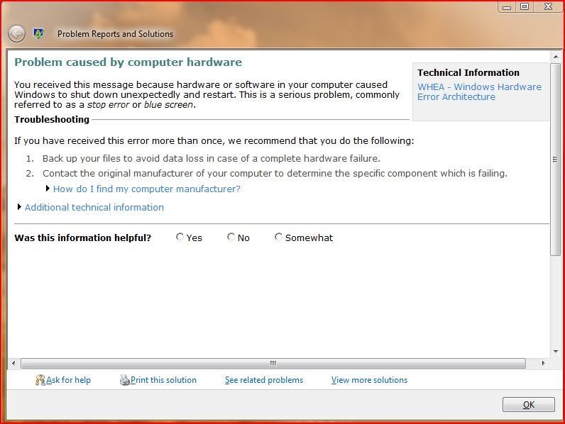

If you click on additional technical information does it give any useful info?
doh... didnt notice that...
Although we know the problem is caused by a hardware component, the error report does not contain enough information to tell us the specific component. It is likely that the problem is being caused by one of the following computer components:

well guys, i cant find any faults in anything through tests... the only bonus is the GPU has dropped off the list... i thought that would have been the culprate.. it now reads like this:
