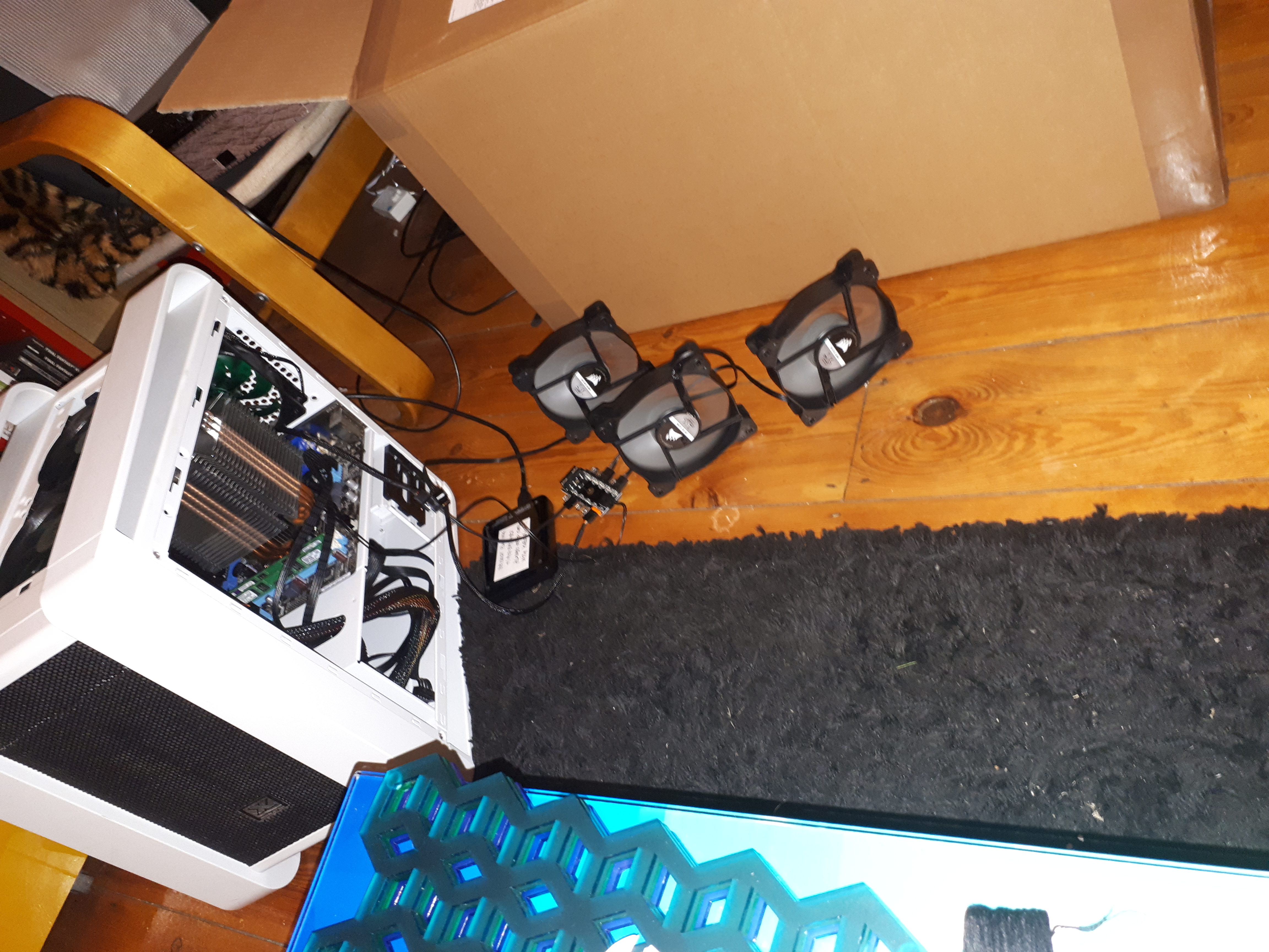

Oh god I can see my obsession with quiet PCs and noise testing going up a notch. I've already started testing with batteries and DC supplies before each build :D
Isn't that standard procedure before accepting any case fan into use?
And especially for fans bundled with Noctua's heatsinks...
You're not wrong...
My ears are hurting from seeing that likely sound leaking front mesh and heavily restricted rear fan... :p
