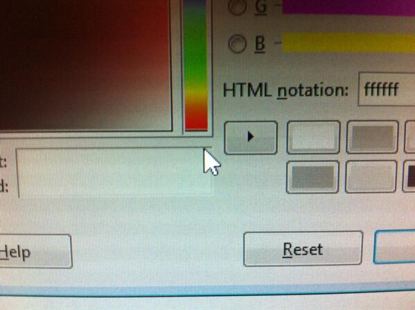

Hey all! I built this PC around three years ago and it's been rock solid until last weekend, regularly staying up for a month or three at a time. On Saturday the PSU blew, taking out the fuse and the circuit breaker. Since then it's been crashing every hour or so as well as exhibiting some other video issues. Can anyone guess what the issue might be? I'm totally stumped, I need this thing for work and I can't afford to replace bits until it works

2. On some boots, the screen - except for the mouse cursor - dims. Like this. The mouse cursor can be visibly twice as bright as "white" areas elsewhere on the screen. This effect persists until the next startup.
On Tuesday I replaced the cheap PSU with the OCZ 650W PSU listed above in Components. This had no effect. Symptoms are the same with either PSU.
