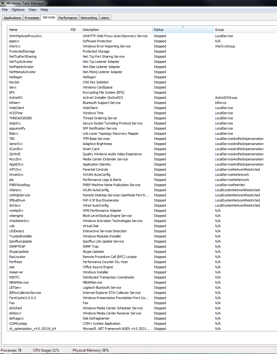

I've noticed that there are a whole bunch of services on 'stopped'.
Could this be a virus? Scanning with Avast, Spybot and Malwarebytes has not come up with any infected files tho..
Stopped services is normal. My machine shows 70% of services as "Stopped" in task manager. Services will start and stop as needed by the OS or host applications.
