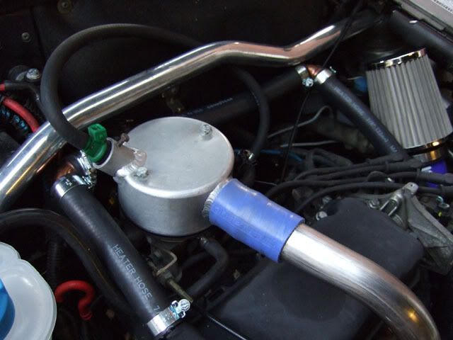

I had all the parts including a compact K03 turbocharger scavenged off a turbo diesel golf, a custom exhaust manifold to mount it, a fuel injector computer, a cosworth 2nd injector and throttle body mount as well as a number of smaller components.
Big problems came fitting the turbo and manifold to the car finding they were not only too far forward fouling the radiator but the actuator was also on the back meaning the water rail path from the engine block was blocked meaning a new fabricated radiator mount to bring the rad forward as well as a completely re-worked cooling system to get around the turbo’s awkward location grr.
With the assistance of an engineer friend we got the new parts welded up and a new front exhaust downpipe made at long life. A trip to Mocal (just down the road from me) also saw me with an oil feed for my turbo to which I reached this stage.
I also had bespoke boost and induction pipes made up at long life so was also able to get the rest of the basics mounted.
