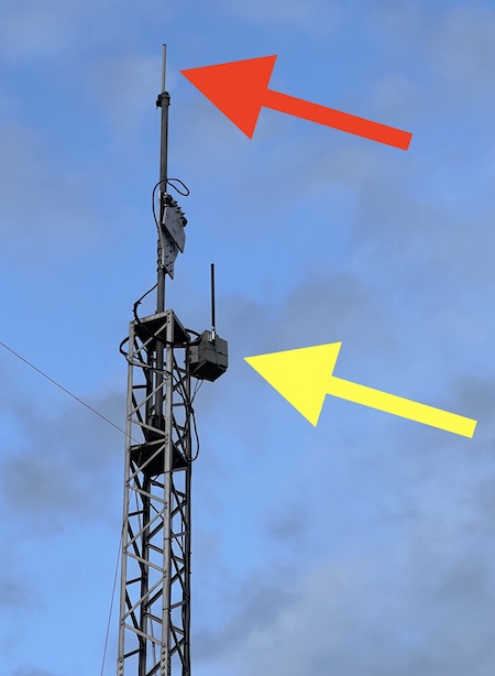

Because ads-b is at 1090 MHz, the aerials are pretty small.
Mine's mounted on the top of my ham radio mast. I've actually taken my main aerial off so it's just the ads-b aerial up there at the moment and it looks a bit bare.
Aerial shown by the red arrow, the receiver itself is in the box that the yellow arrow is pointing at.
