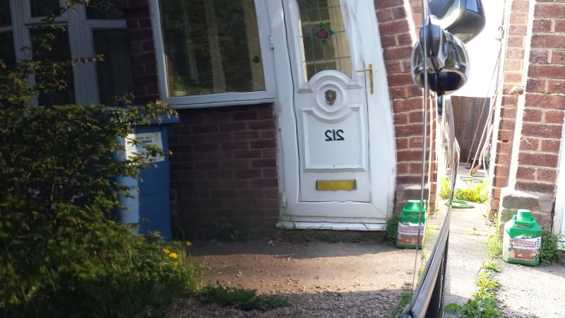

Here is a door repair I did after some twonk was careless in a car park 3 years ago, this thing was the size of a 5p-
After, there are some ripples as you see but it was done from start to finish in a single weekend, had to buff it out a 2nd time a few weeks later again once the paint hardened but it's been fine since-
