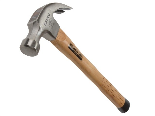

As for the security screws:
Yeah, you could break it off. Will look neater if you take if off properley though , because you can join the cables up, then put the lid back on the wall which hides the connection
