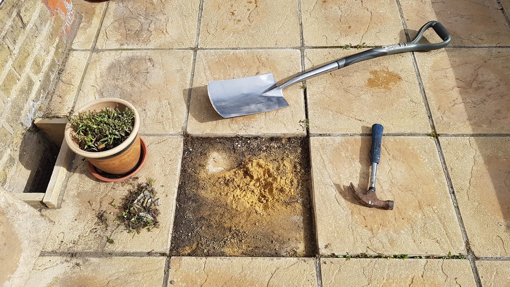

I've lifted a patio slab that was rocking when stepped on and also had some broken pointing.
There's loose sand underneath which I've piled to one side and it was covering a bit of a cavity. I'm wondering whether to pat the sand back down and just put some large blobs of sand and cement mix in each corner?

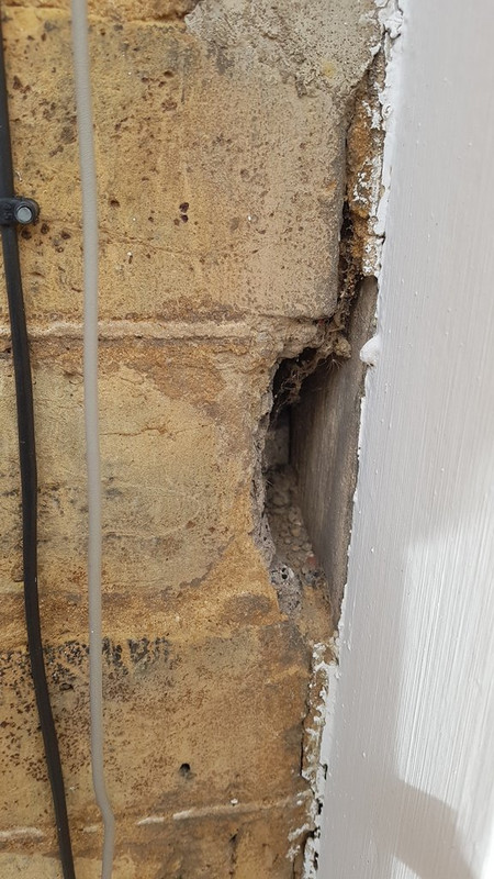

Do I need sharp sand, building sand, or some other type of sand, and would you recommend mixing 4 parts sand to 1 part cement? That's what I've been seeing on YouTube videos. And 3 to 1 for mortar joints? I also want to fill a small hole in my front wall.next to the window frame.
How much sand and cement do you think I should buy? I'm going to go to builders depot they're normally pretty inexpensive.
I'll need a bucket. And I'll need a trowel but I don't know what size. And should I use a piece of old hose to smooth out new pointing or just fill the gaps around the slab and brush away excess?

For underneath the slab mix 4 parts sharp sand to 1 part cement. Compact all of that sand so its nice and flat. Spread the cement mix all over the area where the slab is going to go and as deep as possible. Dont just put blobs in corner. With whats left over you could then poke that into your hole.
Blimey sadat, that's a bit scary. Will marigold washing up gloves do?
Thanks apg. Good idea to use what's left over for the hole. So, cover over the sandy area too. Not sure what you mean by as deep as possible unless you mean pack the cavity covered by the sand?

I mean when you lay the cement mixture make sure its not just 1mm thin. Try and put a good amount down so the slab can bed in properly.
Yes a sinngle bag of sharp sand and a single bag of cement will be more than enough.

Op... Dig out about half and inch of all the old sand and remove any cement from the edges of the other tiles.
Get one bag cement and one bag builders/sharp sand (no gravel in it) Make up a mix of 1 part cement to 3-4 parts cement. No water...
Put the new mix down level and flat. (piling in corners creates a vacuum under the slab and will crack it) place the tile on sand and using a small level to make it accurate.
Using a slightly strong 50/50 mix of sand and cement and pack it into the gaps evenly around the edges.
You can leave it after that, the moisture in the air with eventually set it in place. However the packing of the sand should make it very strong in place anyway.
So mix one part cement to four parts sand and no water. Then mix 50/50 sand and cement for the pointing, I presume I must add water to that though?
