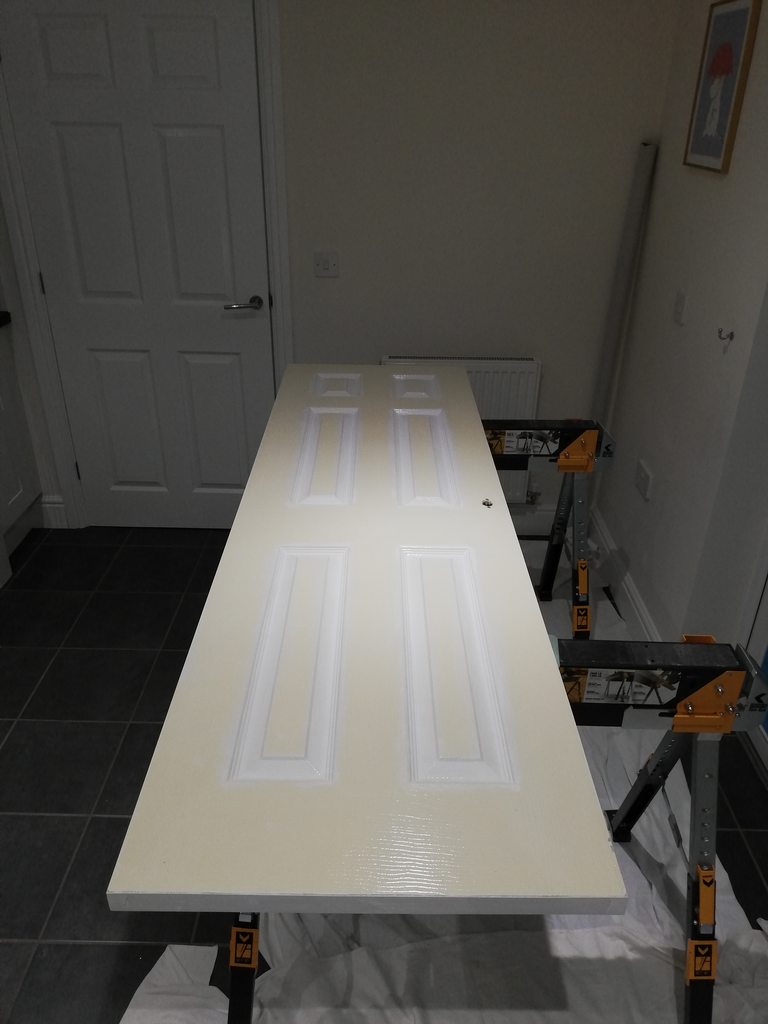

You can see how bad some of the doors in my house were, where they don't get any sunlight. I've cut in with some dulux water based undercoat below (door was lightly sanded).
