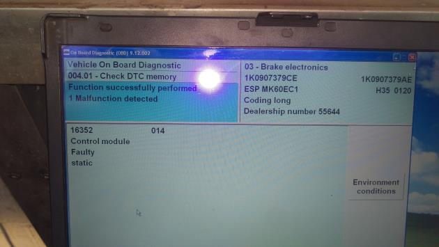

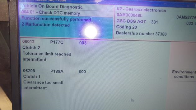

This is what they said on their report:
You need the fault codes, it could be another fault as the pressure sensor failing doesn't bring on the ABS light. It's the ESP that is affected so the ESP and traction control lights are lit with the pressure sensor fault, BBA Reman will be able to sort any other faults with it.
These are the error codes that my usual garage got when they looked in to it after the service.
