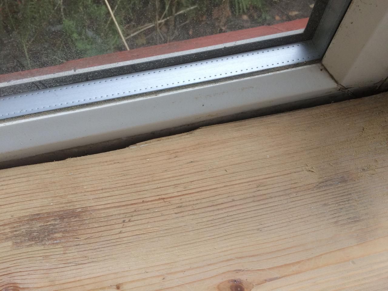

Another one for you guys, if you don't mind please

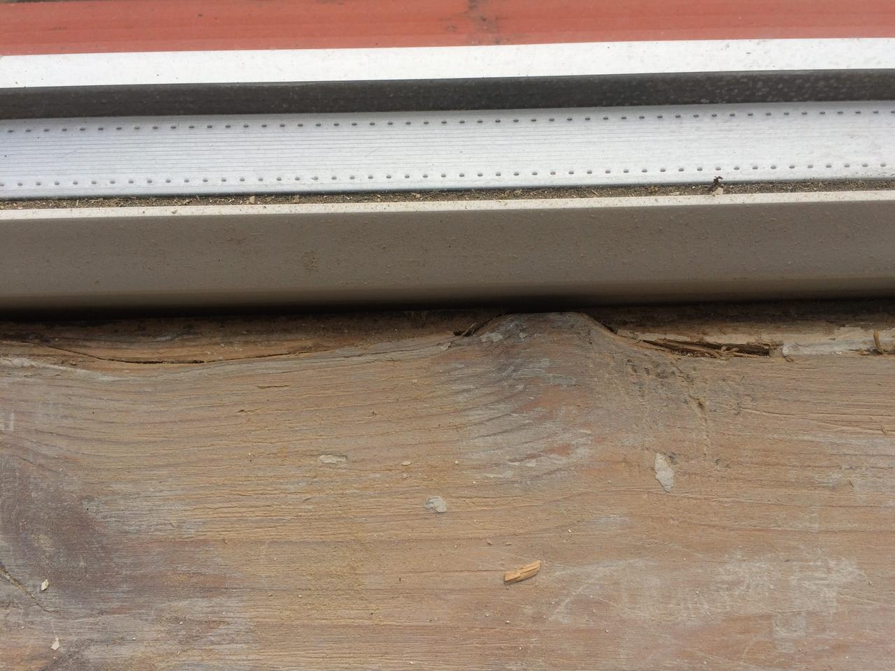

The window side of this window ledge is really badly damaged (I assume by the guy who installed them years ago).
I have dug out old filler/sealant and wonder if I can just fill these gaps with a wood coloured filler? My intention is to sand down and stain rather than hide with gloss paint.
Thanks again :)
You need to get some wood hardener and apply that first, but yes, I have done that in the past. Needs some elasticity to allow for the changes in temperatures and also to be water resistant.
A friend has recommended just putting sealant in the gap and then covering over with quadrant (either UPVC or wood); reckon that could work?
That would be the standard formula to bodge it. I wouldn't personally, as the quadrant would stand proud of the bevel on your window frame.
I'd use a similar colour Unica silicone sealant, tape if off with frog tape for a nice smooth line and no overspill. Before this i'd get a random orbital sander on the sill itself which will bring the grain out nicely, and should look great once varnished, done many with that sort of condition.
Should give a lovely rustic look :D
Appreciate the feedback guys. Would love to rip out and renew but I have recently had the walls plastered and skimmed, I think it would damage the wall underneath the window ledge. Fairly happy with a 'rustic' look to be honest and have got a couple of strips of flat beading that will cover it nicely.
Will Unika sealant be stable across such a wide gap; in the first image, the gap is around 1cm?
