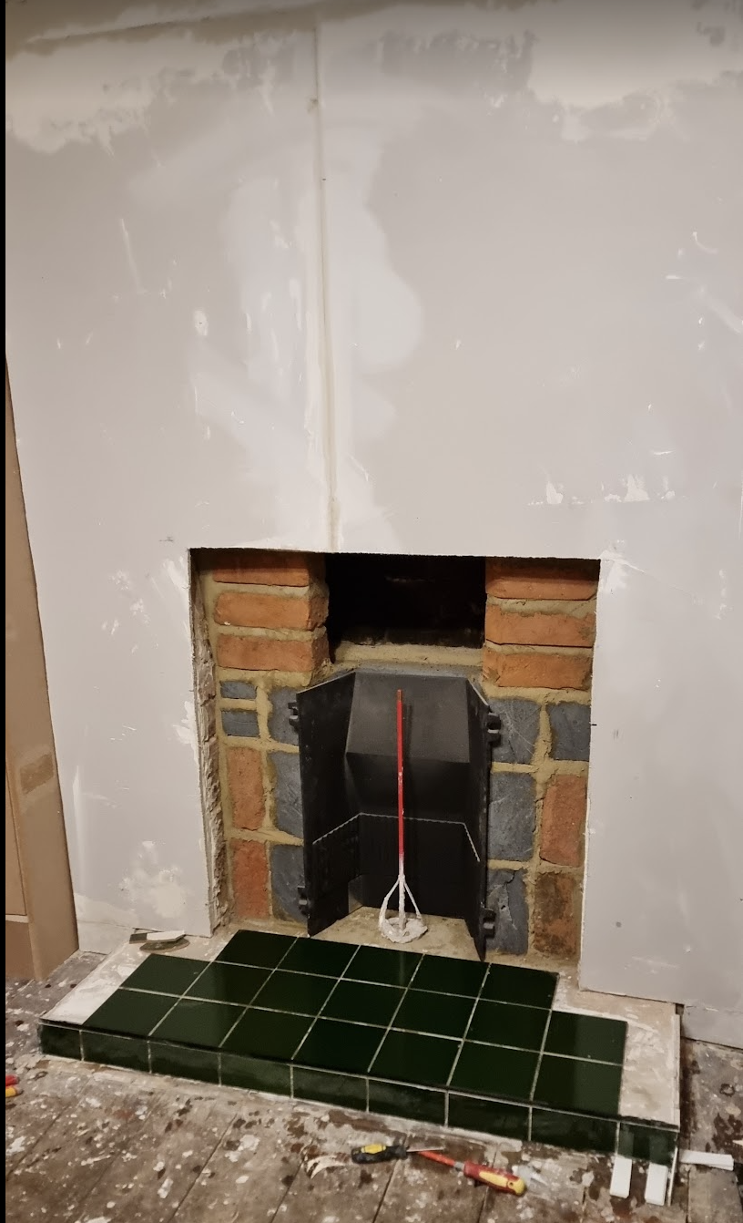

Hi folks,
I ripped out the old painted white grotty fireplace earlier today. I am left with what looks like a gigantic hole, lol. I have been looking at 1930s style/pre 1930s cast iron fire surrounds. I really would prefer a log burner but I understand the hetas(?) tax is immense. I have literally zero budget.
I removed the hearth stone as it was gigantic and encroached on the room too much, but it is in one piece so can go back if required. The fire proof stone surround is fully intact/unmoved. The cast iron fireplace has a tray and surround/base that fits back in.
Thoughts? Chimney isn't lined either ...
Edit: For example, can I just whack one of these things in place?
That looks like a gallery fireplace. The simple answer is no, you’ll need a new solid fuel fireback for that particular fire-lace. Unless you can get a fireplace that will suit that existing fire back and it’s in good condition (not a huge amount of cracks).
have you ever had the chimney swept and inspected?
Thanks - my knowledge on this is literally zero. I lucked out in the last place, it had a log burner and a lined stainless steel chimney!
The chimney has been swept and given a clean bill of health; when I moved in.
Is the fireback not suitable as it is?
I'll be honest, my knowledge was also zero and I wouldn't say it's extensive.
I moved in and ripped out a 1970s era fireplace and had a similar, Gallery fireplace from eBay. I found that my fireback was cracked heavily due to decades of use, in addition to that it fouled on the fireplace and also the brickwork fouled the fireplace which meant I had to install a new lintel, replasterboard, new fireback and then plaster.
I'm sure I have some photos somewhere... I'll dig them out and add them to my post :)
