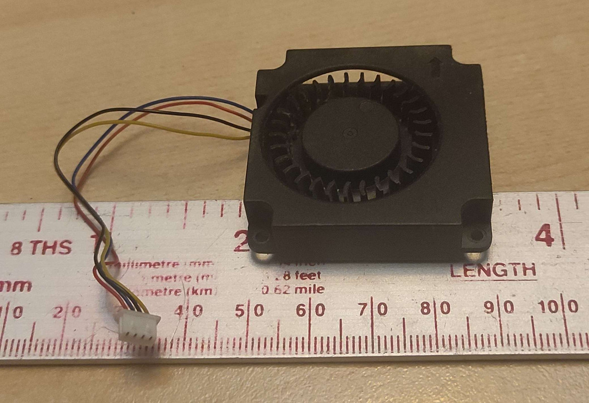

Ok, here's the old fan:

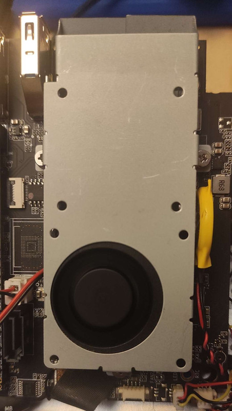

and the existing cooler. The current fan is a fixed speed that I've hooked into a header intended for a 2.5 inch drive, the real fan header is one the edge of the board just below the fan.
I think the fans are dying because they're cheap and are running 24/7. The original lasted a year.
My current favourite plan is a 40mm x 30mm heatsink (which should be almost good enough by itself, if my mental arithmetic is correct), to solder a raspberry pi pwm fan onto the old fan's connector and stick it all together with rubber bands.
Just in case a search finds this, a simple heatsink wasn't up to the job and the Raspberry Pi fan was too weak and barely moved any air.
Currently using the old heatsink sans fan and a spare 140mm case fan powered by USB which seems to be working well.
these blower types of fans are common, i think they go with names like 5010 radial blower fan etc, can get good quality ones for cheapo, stuff like delta or sunon maglev etc
