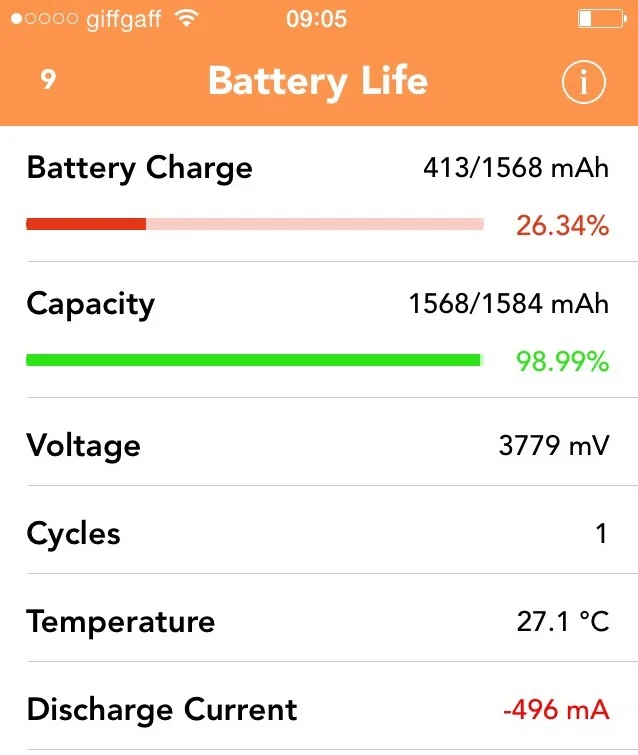

I have just replaced the battery on my iPhone and it is behaving very strange..
When charging it will quite happily go up to 100%, but if I leave it on the charger it will start to reduce in %'ages.. When leaving it on the charger over night it will normally end up at around 20% in the morning..
The readings do seem a bit random throughout the day aswell, oh, and it does randomly switch off (not often)..
This is the second battery from this seller (got replacement for the first one as I thought it was faulty - it displayed the same behaviour), so I am thinking perhaps its the phone..? Although the original battery charges just fine, but does cut out randomly (due to its age?).
I have uploaded the battery readings right after a full nights charge - can anybody read anything out of these numbers?
Just an update in case somebody else have the same problems.. It turns out the battery (or rather 2 of them, from the same seller on ebay) must have been faulty.. Once replaced with a battery from another seller the phone started charging correctly again..
