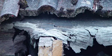

Are they going to be fitting eves protectors? This means having to remove the first row of tiles and pushing up the second row. which adds a lot of time to the job, but well worth doing.

If they're fitting eves protectors then they will need to remove the bottom row of tiles and push the second row up, so would need a scaffold to do this safely.
This is what the felt usually looks like when you take the timber fascia off, so i'd always fit eves protectors.
