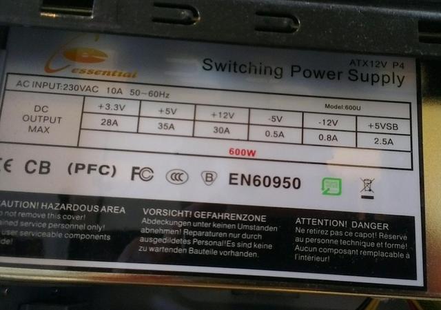

Currently have a 600w PSU. But someone in another thread here advised to get a new one, of a decent brand, as mine is made by "essential". He said 450w would be enough if it's a decent brand. Would 450w be good enough for that 7850 2048MB ?

"Essential"? You mean "Enhance"?

PSU does state "essential" not "enhance" though :
30a on the 12v is pretty pants. That's only 360w.
Chances are that unit would have quite the ripple on it as well.
How do you get the 360w ? So do i have to look at the ampere on a new PSU as well then, or shouldn't i worry about that if i go for one of the ones adviced in the posts above ?
And what does ripple mean ? (I'm Dutch, so English isn't my first language)
Power ripples.
30*12 = 360W :)
amps * volts = watts
Ah i see. But how can they sell a 360W PSU as a 600W one then, surely that's misleading ?
And thanks for the advice IC3, i'll probably get those.
It can only push 360W down the 12v rail but was rated to supply 600w across all rails hence the 600w box goes across all the voltage values in the picture.
As no one has mentioned it yet from looking round i've seem the required amps on the 12v ranging from 26-30v so at the very least i would say don't overclock on that psu.
